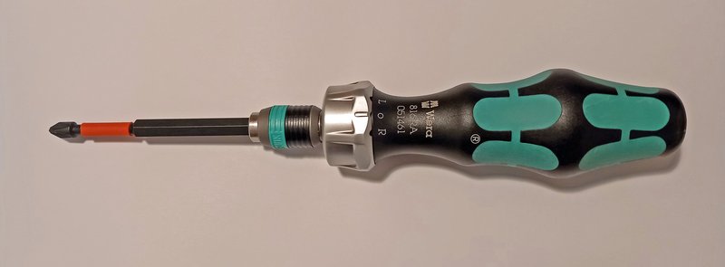

I can recommend Wera screwdrivers.
However might I ask, do you have any power tools that use bits? Such as an impact driver or electric screwdriver (or even a drill that you use for inserting fixings?).
If so it might be more prudent to get a bit holder and just buy some Philips bits, that way you only need to own a single set of bits and you can use them with your impact driver/drill + handheld bit holder.

I also own Wera Chiseldrivers which are great if you ever need to whack your drivers.

Not thought about the bit holder route. Definitely worth looking at. The wera brand looks like a possible good solution. Thanks for the curve ball idea.

Although I have a lot of Stanly screwdrivers, I also use the Wera handle and separate bits solution! Then I just buy whatever bits. DeWalt, Sabrecut... any branded name.

Yeh this is a good point but what I would say is the wera sets have 1 or 2 handles then a whole collection. You can go whatever route you require. I wouldn’t want separate screwdrivers for each one. The storage alone would be mad! Thankfully they are all in good cases.

Another one for Wera - Started years ago and bought them one at a time -Now a set is cheaper -I have the ones with green handle - Also have a Wera bit screwdriver and that has come in very usefull.

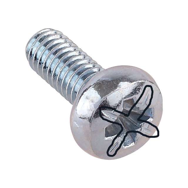

Just in case you're unaware, there is a difference between Phillips and Pozi screwdrivers, so make sure you get the correct one :)

Pozidrive have an X on the head.
