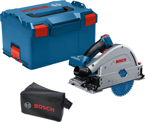

Are there no plungers which can be used as a normal circular saw without the track too?
Almost every time I've used a circular I've ended up clamping a piece of timber to use as a guide so having a proper track is very very handy. Plus (presumable) all tracks should have a mark where the centre of the blade is so unlike with timber guides there shouldn't be any reason to be adjusting and measuring the offset.
Might be a pricey though:
That's around x4 the price of the blue in the OP. Guess it is somewhat less from other vendors. And that seems to be without the track, ouch!
Should have added that depth helps keep the saw on the straight as full depth cuts can wander.
