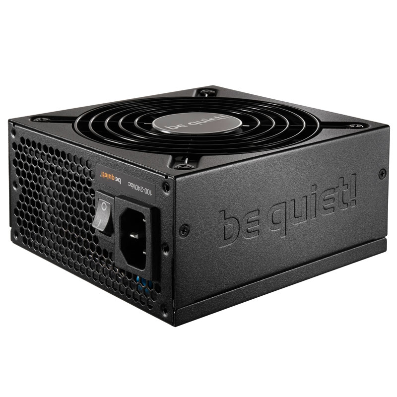

Hi all!
So, a year passed and in some part due to busy-ness and stock issues I've still yet to build this thing!
But I want to pull the trigger on this soonish, so here's my list so far with comments:
My basket at Overclockers UK:
Total: £1,007.41 (includes shipping: £10.50)​
CPU
Considering going for a 12 core here for the scientific computing I do
GPU
I have a 1060 to use until stock returns or the 4x series arrive
RAM
Would consider 64gigs again for the scientific computing I do
HDD
I'll add a large ssd later
MBB
No motherboard yet, OcUK doesn't seem to have any Ryzen 3rd gen compatible mini-ITX mobo's... is that right? Is there one in general that comes recommended?
EDIT: I guess i'll go for the ASUS ROG Strix X570-I Gaming
FAN
Just picked the top of the list here, open to any suggestions.
I'm seeking advice on all matters and would welcome any suggestions!
Thanks very much
