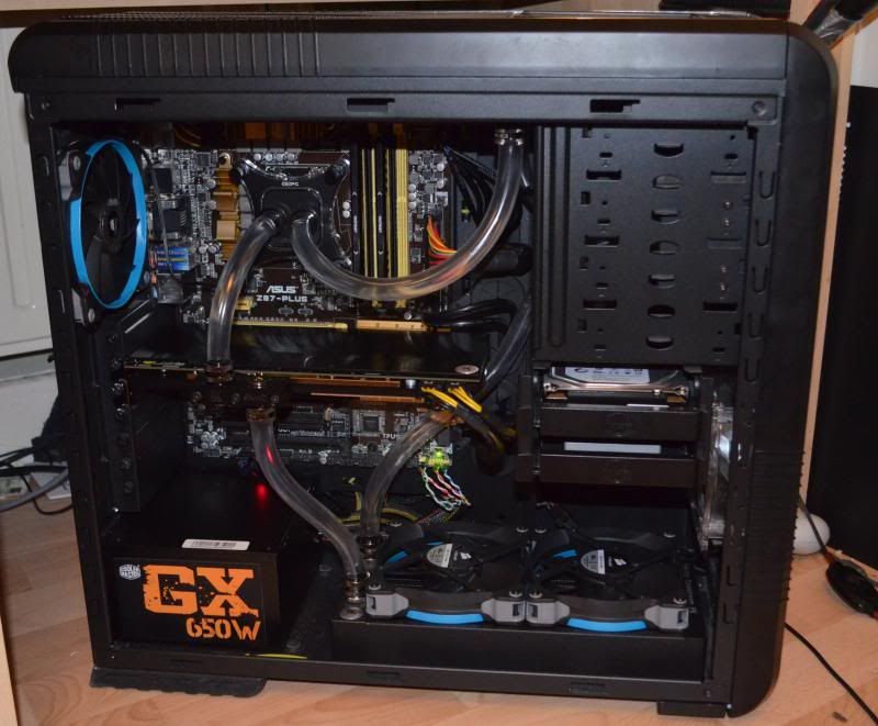

The 690 does indeed happily fit 2 x 240 rads! I have just finished doing my first ever attempt at watercooling in that case!
I'm also running a single 290 and its taken the temperatures down from about 89-95c to about 41-45c on load!
I think you could easily mod it to fit a 360 if you really wanted to, but 2 x 240 rads seems like the better option to me!
