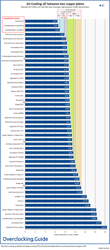

If find it amazing how people go for new TIMs that is not as easy to use and only give about 1c better heat transfer then older established TIMs.
The top 31 TIMs tested by Overclocking Guide were all within 3.18c of each other. The top 6 were 1.36c apart .. and the top 2 (liquid metal) were 0.43c apart and Grizzly Kryonaut was 0.93c worse then they were and only 0.31c better than GC Extreme. The next 24 TIMs were all within 1.35c of each other.
MX-4 is only 1.1c below Kryonaut .. not enough to make a noticeable difference .. not even as much change as lowering your room temp by 1.1c or improving case airflow so cooler intake air temp is only 3-5c above room .. and many builds have cooler intake air temp 8-18c above room when gaming or working system hard. ;)

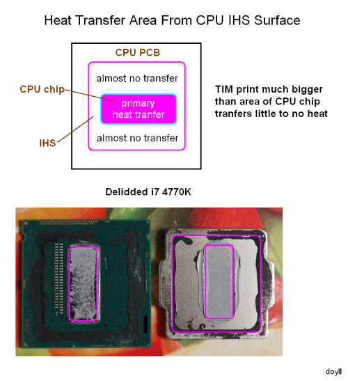

What laddy said. How easy a TIM is to apply and how well it seats is at least as important if not more important than what the actual heat transfer ability of specific a TIM is. Get a TIM that is not to stiff and use a small dob in middle of CPU. When cooler base is pressed down an mount tightened the best print is one that just reaches the edges of IHS .. at least on most CPUs because all the heat is coming from the actual CPU chip, and that is usually 1/4th or less in size compared to size of IHS .. and the IHS does not spread heat but very little. I'ts size is bigger than CPU chip to give a good base area for cooler or block to mount onto, not to spread heat. IHS is too thin to spread heat much.
We want as thin a layer of TIM as possible so as much metal to metal contact as possible is made.
Sorry for small size. But you can see how less TIM and smaller print transfers heat better than more TIM.
