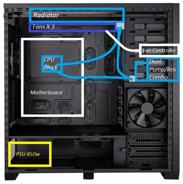

ok i have recieved my case today and will be getting the outher parts soon, before i order the watercooling parts that were recomended to me, ive done a drawing of what i understand is how ill be fitting it, can someone take a look and tell me if this is correct, the only thing ive changed in the parts is the rad (Hardware Labs Black ICE Radiator SR1 360) and res/pump (they have none in stock) to XSPC D5 Dual Bay Reservoir/Pump Combo, i have no idea what fan controller to get theres to many to choose from, I want one that doesnt look out of place on the 800d
thanks:) edit sorry meant to ask about having some sort of drainage fitting, will this be a good idea and where to put it
For fan controller you want a lamptron or a sycthe imo. Stay away from nzxt.
Look for one with a brushed aluminium front as that will look at home on the 800d. I quite like the scythe kaze master ace I'm using as it has a brushed black ally front with a chrome rim around the screen, edges of the front and buttons and chrome indicators on the buttons. Lamptron are probably more highly regarded for solid fan controllers though.
Loop order looks fine.
Not a fan of the airflow design of the 800d myself, but the exterior look is one of the best imo. Plenty of potential inside for a good looking system too.

yeh ive been looking at them the Scythe Kaze Master Pro and the Scythe Kaze Server (only place i can get them from is ebay), i must admit i am worried about the air cooling on my gtx460 they idle at 39c and 60c full load in my phantom but i have 3 x 200mm 3 x 140mm 4 x 120mm fans and the noise is horrendous i was planning on watercooling them but i might aswell put the money to buying some newer ones, do you think i should put some sort of drainage system in my loop for easier maintenance?

As for drainage.. IDK. My watercooling is external so I didn't need it, and this is my first watercooling. If you want something specifically for drainage you're looking at either a valve like Pgreenwo used
or, (and this is what I'd do) Use a pair of koolance QDC fittings at the lowest point in the loop. Pop them apart and either plug a spare in to one of them (costs £11~ extra) or simply take off the compression to drain.
edit: I would expect your 460 temps to be a lot more than what they were in your phantom if on aircooling in the 800d. (I assume they are axial fan, not blower?). For air cooling the 800d can be a bit of a hotbox.
But yeah I wouldn't spend money watercooling them. It'd be £30~ each for a universal block, then idk for heatsinks. You'd be better off trying to sell them and putting it all towards a better card.
To drain a small loop like that I would unseat the CPU - wipe off the TP, hold over a bucket and unscrew the compression fitting.
sounds fairly easy, i thought i could put a t piece in where the tube comes out of the res/pump and run a tube down to the psu compartment and put some kind of tap on the end, and then i could pull it out of the psu compartment and open the valve, tp that reminds me whats the best to use? :)
