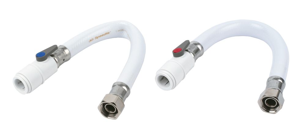

I've run 22mm Speedfit feeds to each item in a flat as it's on a shared incoming supply (so 22mm to basin, toilet and shower) and am looking at the easiest/simplest way to connect to each.
EDIT: Just realised that the basin taps will likely be M12s at the tap end so thinking how to easily connect them to 22mm Speedfit.

Answering the original question... The theory is OK, but check sizes. From the looks of the picture, the reducer is the wrong way round for what you'd need. It looks like it would connect a 15mm pipe with a 22mm "socket"
I've found Speedfit to be really poor in detailing which way round the parts are unfortunatly.
You might be better using a tap connector: https://www.johnguest.com/speedfit/product/10-15-22-28mm-size-fittings/straight-tap-connector/
Tap threads are normally imperial 1/2" or 3/4".
What tap are you looking to connect?
I have 22mm going to each item (shower, toilet, basin).
The basin taps I am looking at are these:
https://www.screwfix.com/p/bristan-blitz-basin-mono-mixer-tap-with-clicker-waste/410gf
