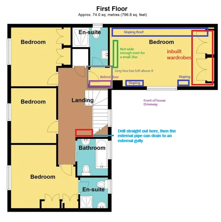

Suggested only one place in the main bedroom. Where our radiator is now. I said no to that straight away. The first guy we had suggested another place in the main bedroom which was behind the door opposite en-suite. This could work as Mitsubishi Electric do a 2kW mini split which is a small size. My wife is having none of it though. Floor mounted Daikin is not going to fit where you said because of chest of drawers. The floor mounted unit is quite big.
Anyway he’s going to quote for the landing 5kw (Where I initially said) and snug (easy this) downstairs 2.5kw. When I suggested routing condensate through wall into bathroom and then into sink waste he wasn’t keen at all because bathroom is fully tiled. Pump will go in the loft.
5kw landing, 2.5kw snug. 3 port external which I think is 8kw. Daikin Prefera What we thinking? 5.5k? Oh he also said electric work on top as I need 20amp for external unit. I think he also installs Fujitsu Airstage which I’ve read is good and cheaper.

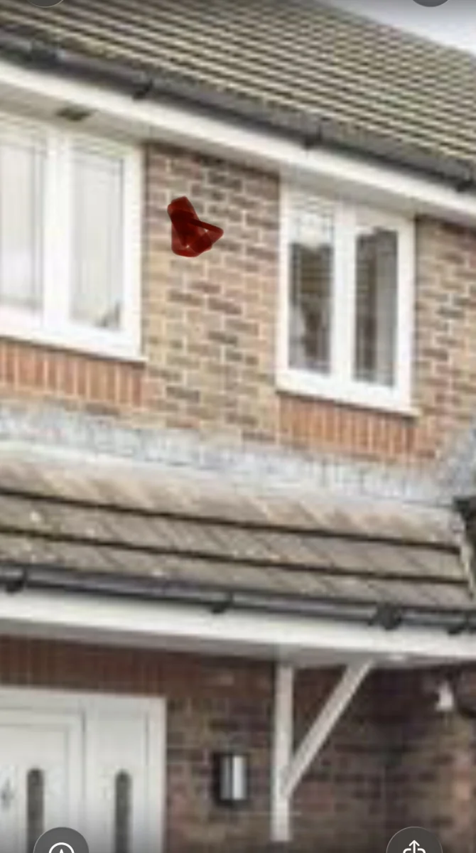

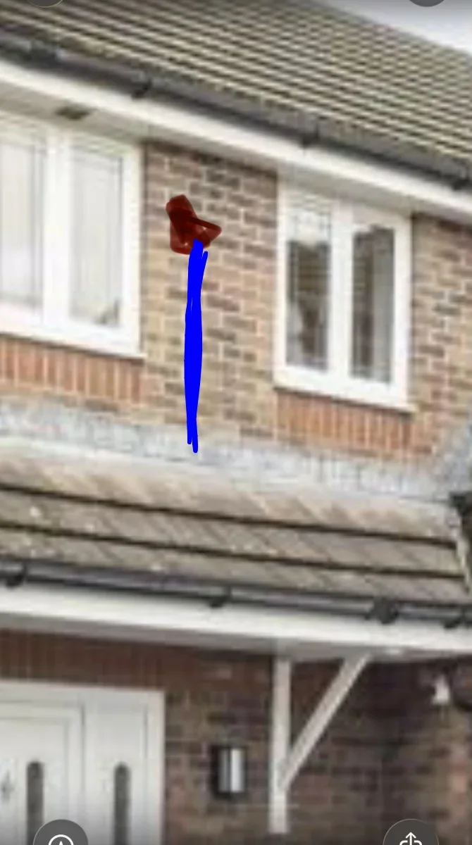

an alternative is to have trunking inside the house on the wall to hide the condensate pipe, then drill straight out of the wall
(this is what i'm having done for mine so mine is a fully pump-less system, despite having all my internal units mounted on internal walls)

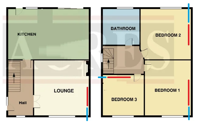

this is mine:
It would likely look a bit unsightly. Not just the pipe, but when the AC is running in hot weather you'll have a constant wet patch on the roof that over time will likely stand out. This is why I asked for my drain pipe to be connected to my gutter down pipe because if was on my drive way I'd end up with a noticeable damp area that over time will look worse than the rest of the drive.
@RockLobster what @LiE said. You could put a downpipe and let it drip onto the ground floor roof and let it collect onto it's gutter, but yeah, will leave a wet patch on the roof in the summer.
Depends on which you prefer more
Pump = more noise, extra part to break, more maintenance, technically more difficult install (not your problem, but you may be paying for it)
External condensate run = looks more unsightly
Yeah it’s tough one. I might go with the pump and see how it goes. If the pump is a pain. 1) Go outside like you say. 2) Drill straight through into bathroom ceiling height and conduit down in the corner of the bathroom into waste. 2) Chase wall on unit side then drill through into bathroom lower down then into waste.
I’m interested to see what pump he recommends. I did say I didn’t want one of those mini pumps in the corner of the conduit - mini lime green, etc.
