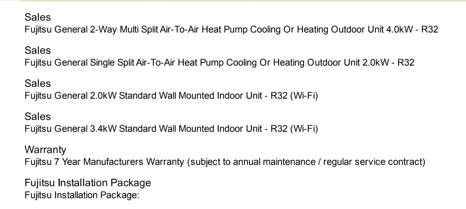

Here's my quote, was hoping it was going to be closer to £1k per room rather than £1.5k.
@NeilMick there's no way anyone can read that I'm afraid.
I was worried when the guy converted the kW to BTU, but it looks like it's a reasonable amount of cooling power for a flat in my quote compared to you guys?
This was £4,200, but looks like a bit more tracking will be needed than he knew and we're moving to a one outdoor unit. I'm awaiting the final quote, but after an actual visit today he said it might be a bit closer to £5k.

Hopefully fixed my image! Maybe I should get a quote for Fujitsu rather than MHI to see if I can save anything.
Does anyone know how the Fujitsu compare to Daikin Perfera? I think I've been told the Daikin are better, which is interesting, as the guys with those are actually cheaper than the guys with the Fujitsu.
