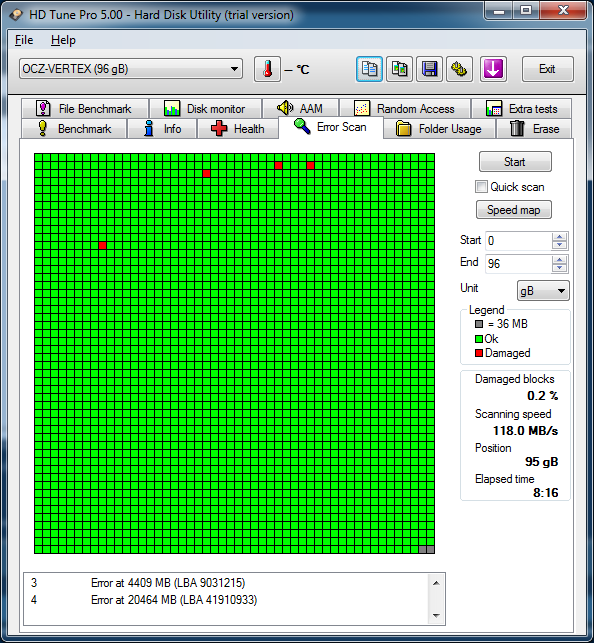

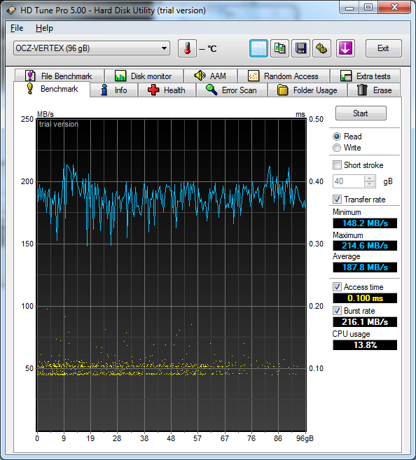

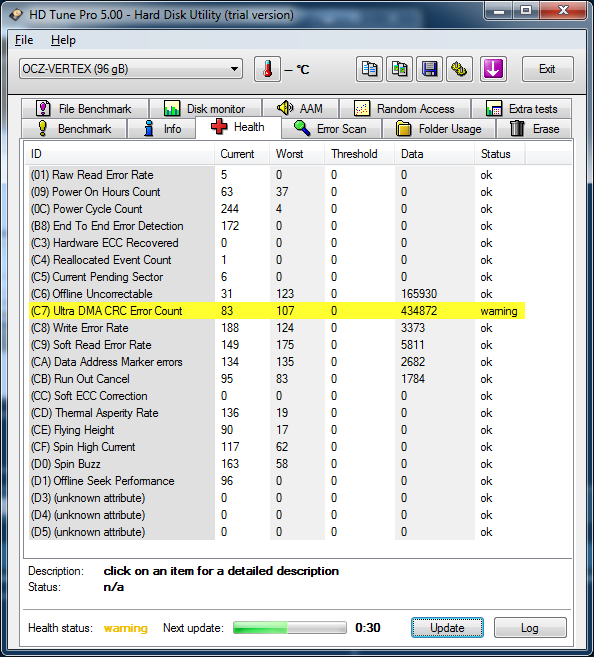

Could this be my ocz vertex dying? Or my mobo? I did the windows memory test and that was fine. I've done these tests on my ssd today:
I'm not even sure if these results are 'bad' or not.

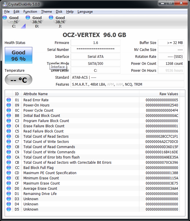

I suspect that HD Tune is misinterpreting the SMART parameters and the reported high CRC error count warning can be ignored. If I looked it up correctly, the crc error count on your drive is parameter D3, which is zero, so while trying a different cable and port won't do any harm I'd suspect it won't help either.
If you look at parameters CE/CF/D0 it looks like your block erase count is running at about 3 times the specification (D3) which if you add the presence of bad blocks doesn't look great... From what I've read the specifications on the limit of erase count tend to be massively conservative but it could be a sign that your drive is approaching the end of its life.
Thanks wonko.
I've changed the cable and put it in another port, and as you predicted, the CRC is still getting a warning, and it crashed in just as much time - 25-45mins.
