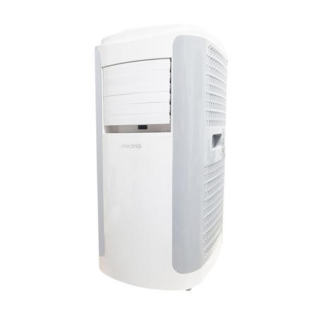

EDIT - Something like this is good enough for a room with a gaming PC and then wheel it into your bedroom on a hot summer's evening to sleep comfortably.

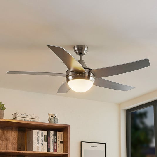

A good quality ceiling fan sounds like a better option... You'd be supprised how effective they are, not to mention the electric efficiency Vs Air-con!

Problem with fan is it does not lower the air temperature, so your PC runs just as hot, but if you do get a ceiling fan make sure it's a DC motor
