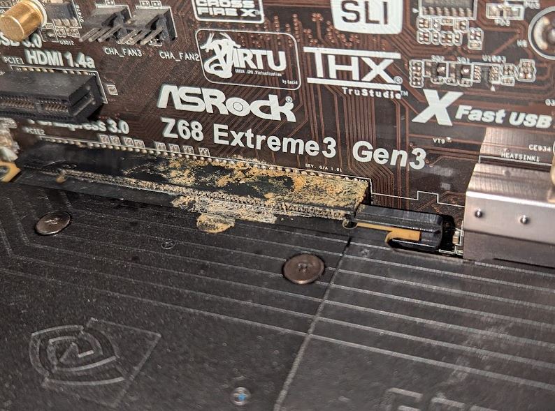

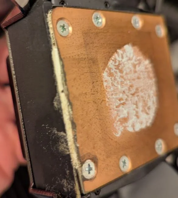

Bumping my 6 month old thread just in case anyone has this kind of issue.... It was a leaking AIO! :eek: (10 year old H80i)

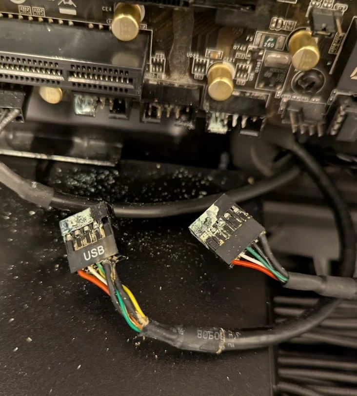

I noticed after moving the PC, a leak from the heatsink area had left a yellow, oily residue down the side of the CPU socket, onto the top PCI-E slot, and further down onto some mobo USB sockets.
Cleaned it all up with alcohol and she's now running fine, albeit both USB sockets died quite quickly afterwards - I couldn't get all of the corrosion off of the pins - probably fixable but I should probably just buy some new kit anyway :D
