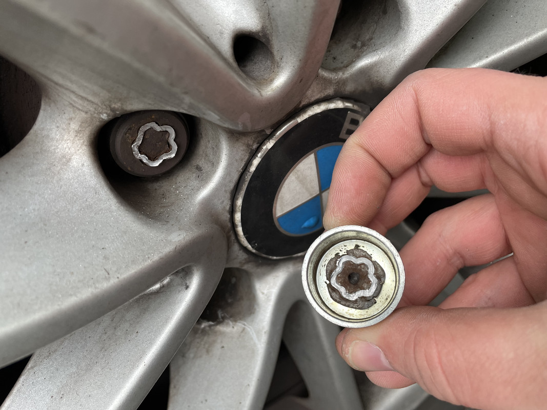

Yeah, it might be different if I had something with some rare and expensive 19" or 20" alloys, but for cars with normal common wheels I'll take the risk. Especially after having this happen to my wife's car last year:
That was the reason I vowed to remove lock bolts from any car I get in future :)
