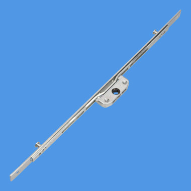

I read this as the THREAD of the screw isn't stripped, but the cross for the Phillips screwdriver is obliterated to a smooth female cone?
If so drill out using a drill a bit smaller than a suitably sized Torx bit, so you can tap a bit into the hole and the bit's splines will bite hard within the drilled hole. Hopefully you can then undo what's left of the fastener.
But I think you said the handle the screw secures is scrap? Why can't you hacksaw a screwdriver slot in the screw even if you hacksaw into the handle as well in the process... ?
If It's a UPVC opening window frame they are easy to remove so you can work on it laid flat on the bench and use things like pillar drills. I mean the window laying flat on the bench, not you....
Edit: You MUST use a decent cobalt, known branded drill bit, not something from eBay of unknown origin and material, if you snap the drill inside the screw you're in a pickle...
