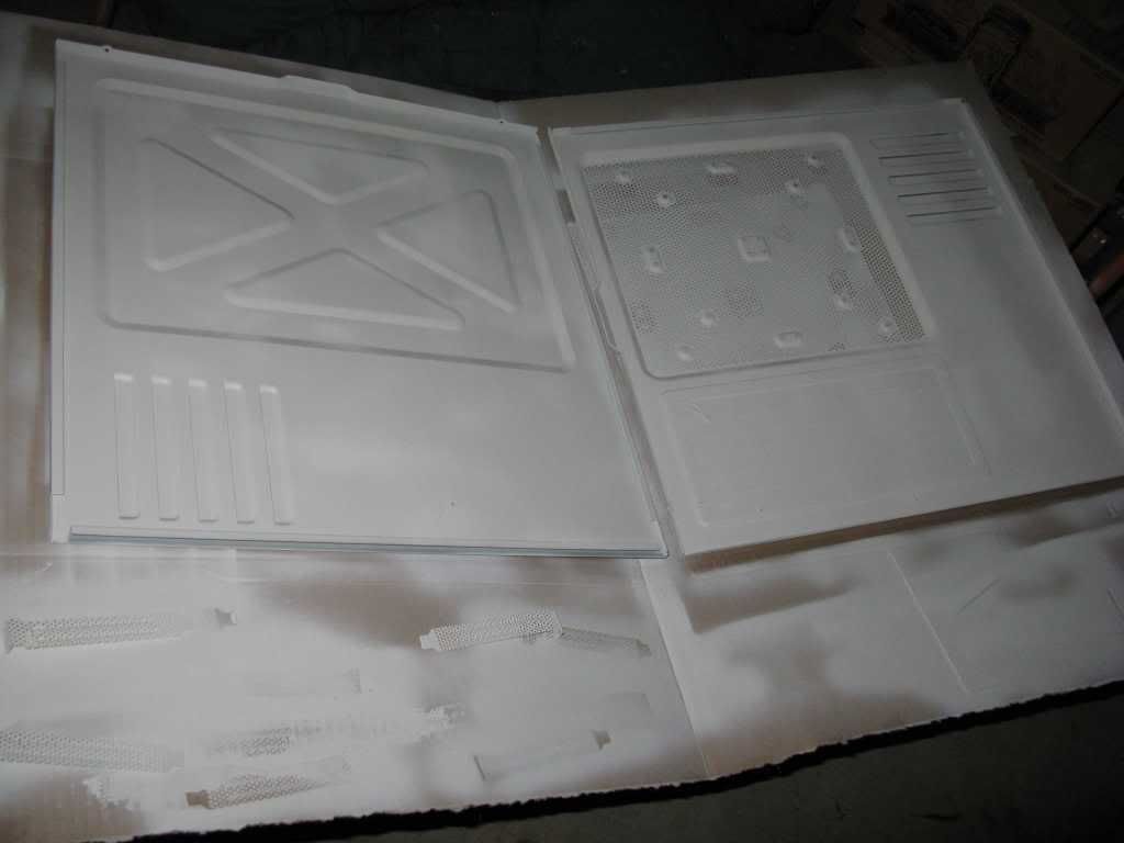

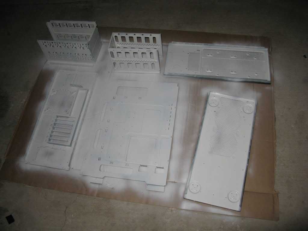

I have dropped a couple of smaller firms an email and hopefully I will get a decent quote. Did you take your case to them to get a quote? If not how did you best explain the parts? I have included these pictures:

Them pictures are not actually of my case as I have not de riveted mine yet. I guess I will have to get the paint stripper out and remove the current paint in there. I will call a few tomorrow morning and see what I get!
