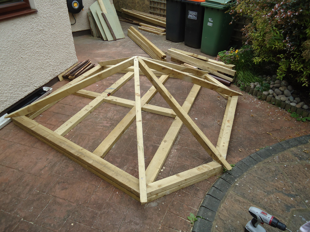

Started off making a base and another the same size that would serve as the roof.
The shape is so that it fits perfectly at the bottom of the garden to maximize what little space there is.
Rather than a flat roof I wanted to copy the nice pitched roofs I had seen on some posh summerhouses.

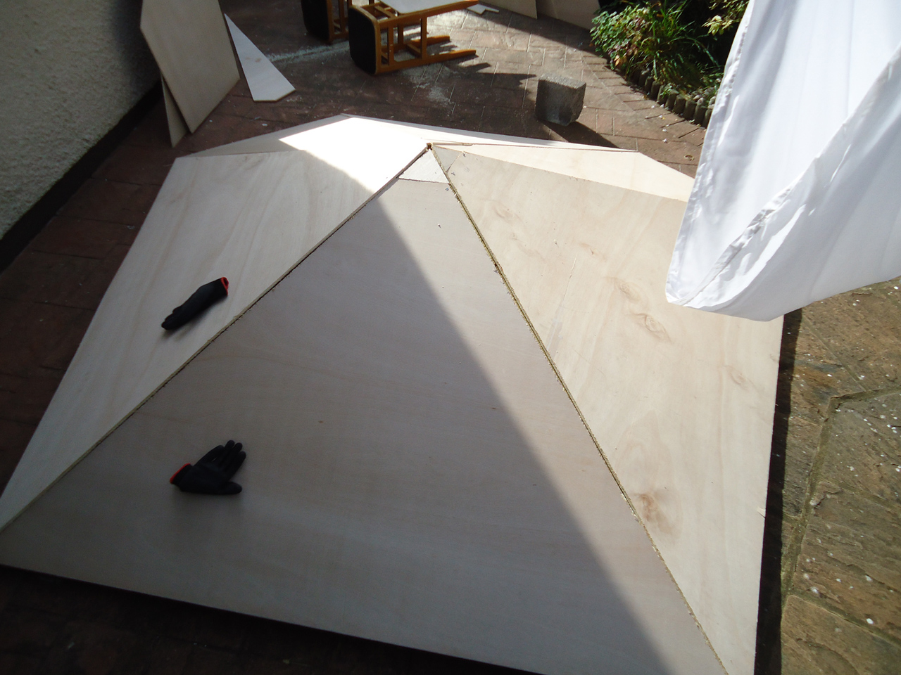

Ply wood on the roof:

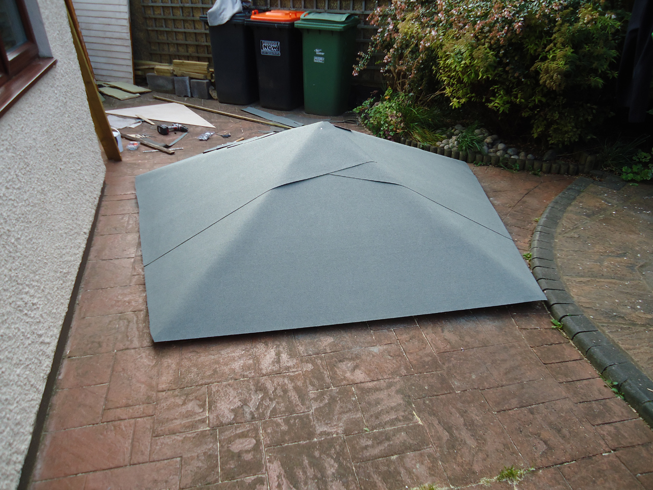

base layer of felt

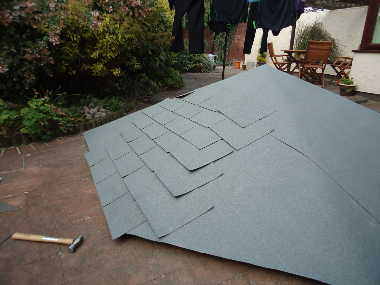

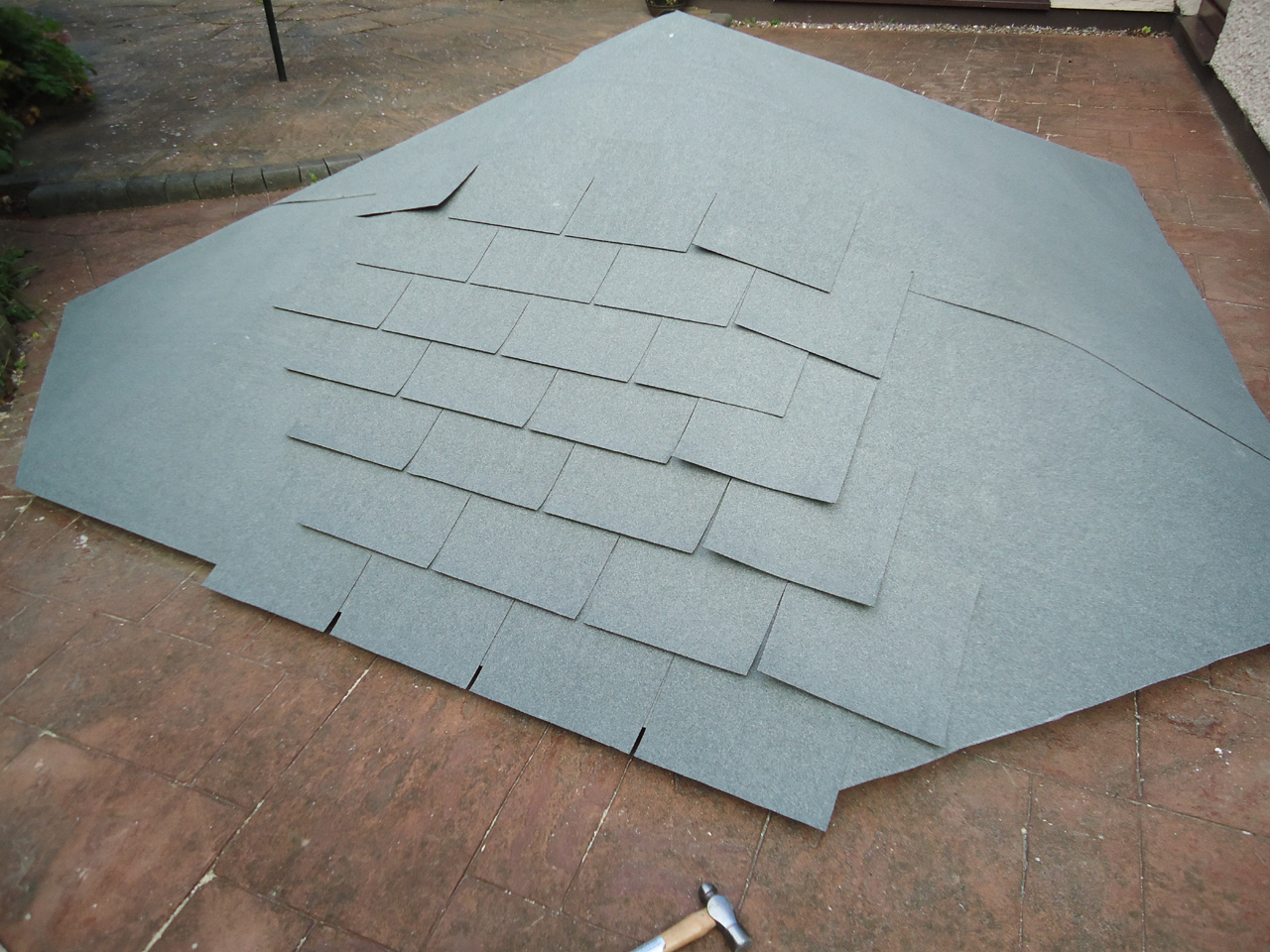

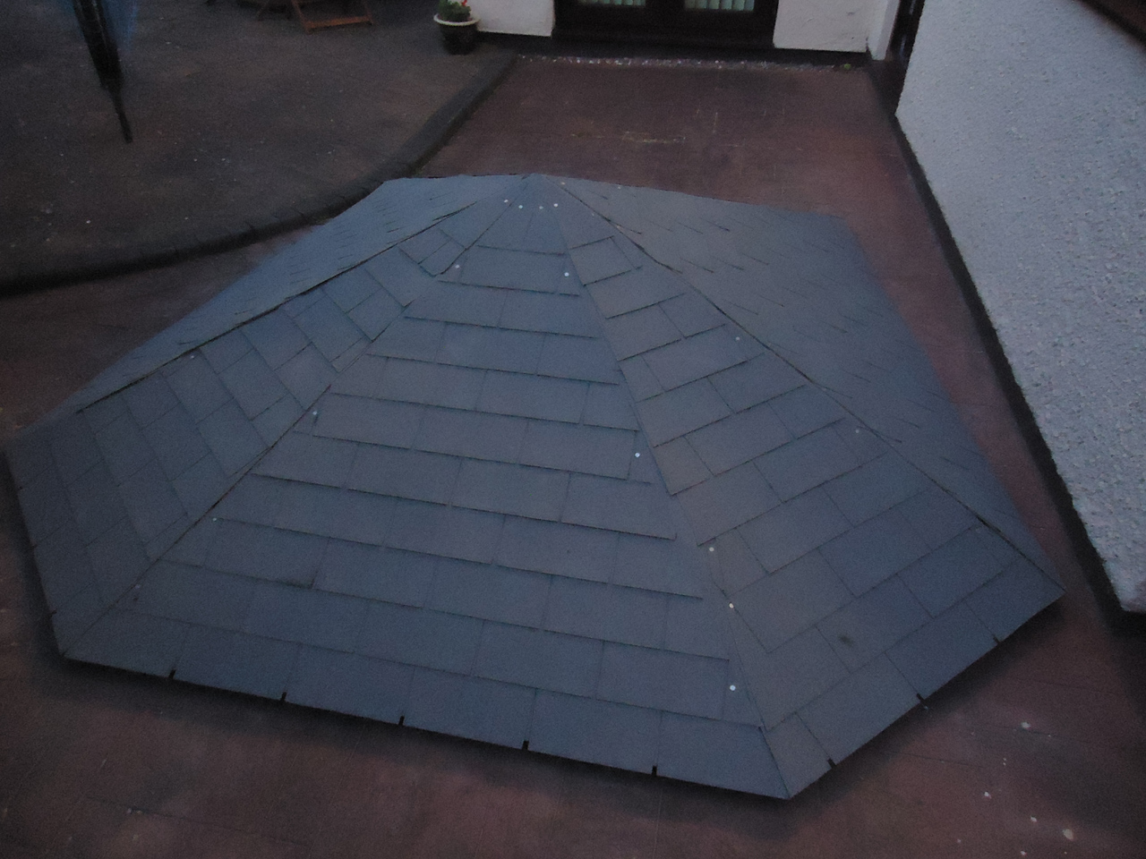

I looked at roof "shingles" and worked out it would be about £150 to do the roof. So instead I thought i'd try and make my own out of roofing felt, this may or may not work!
The picture with them all flapping up in the breeze was just a trial lay in place, I have mastic'd them all down when I put them on proper.
