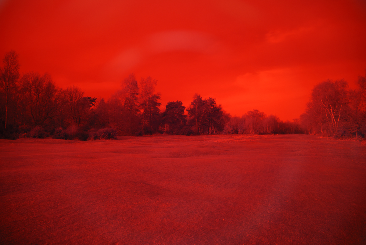

I did set the camera to the "pre" mode (well, it did automatically) after selecting the grass shot. Hang on i'll upload that.
http://www.tiltedsky.net/files/images/grasswb.jpg
I took that, then used the menu option "White Balance -> White Balance Preset -> Use Photo -> Select Photo (That one)"
After that the WB on all the images I took stayed at PRE.
So... when you do it right the pictures shouldnt come out completey red huh?

Can anyone identify what was wrong with the image I took for white balance?
Could anyone please post a picture that is correctly taken, before processing, so I can see what mine should look like on camera?
i thought you were supposed to take the WB photo without the IR filter.
Set that as your custom white balance now.
go into your menu and press custom WB. it will bring up your photos, choose that one. Then in your white balance selector choose the custom one. Its a triangle logo or something.
