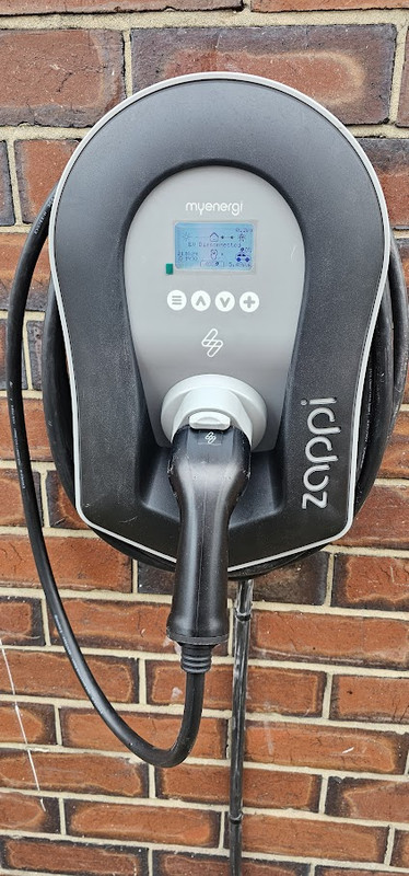

I had a Zappi fitted on Saturday morning and it does look quite neat.
The cable folds around the outside of the charger so looks OK.
I had the Zappi because it integrates better with Solar Panels if I eventually have them, Octopus don't recommend the Ohme Pro if you have panels and an EV charger.
Something I will say, I nearly bought my own charger and was going to look for an electrician but after watching the Octopus professional fit it I realised how it isn't easy and I'm glad he did it. It still took him 4 hours of non stop work for what I thought was a straight forward job.
