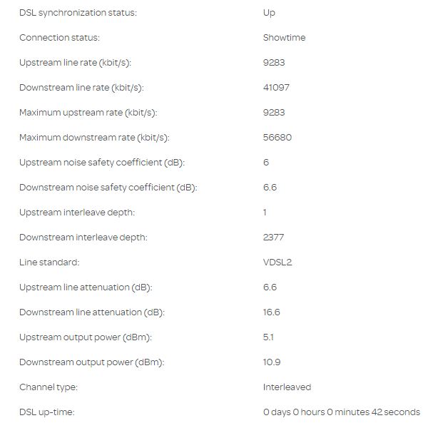

Hey, I recently ordered TalkTalk fibre for my new place, and decided to pay the extra for their large service. My estimated download speed from TalkTalk is 68-76mb/s. The service went live this Thursday just gone and straight away the router showed downstream at 40mb/s and upstream at 10mb/s. Since then it hasn't moved at all, the connection has been solid but still nothing like the speed I'm expecting. I am less than 100m away from the cabinet (if I lean out of the bedroom window I can see it at the end of the road) and the exchange is around 800m away.
Should I expect the speeds to increase over time as the training period does it's thing? Here's what the router is saying:
The DSL uptime is only a few hours due to me accidentally switching the router off at the wall.

It looks like you're on a 40/10 profile although this might fix itself. The sync rate of 56 Mbps is below even the lowest estimate for the impacted range, and your upstream rate is nearly half of that.

The OP clearly has an issue as their attainable is way below the estimate and also their attenuation is very low (16dB approximately) so they should easily be able to get the full 80/20.
I don't think the profile is capped either as the upstream is below the cap of 9999. Although I suppose it could just be the line performing below that cap anyway. Either way, OP has an issue.
