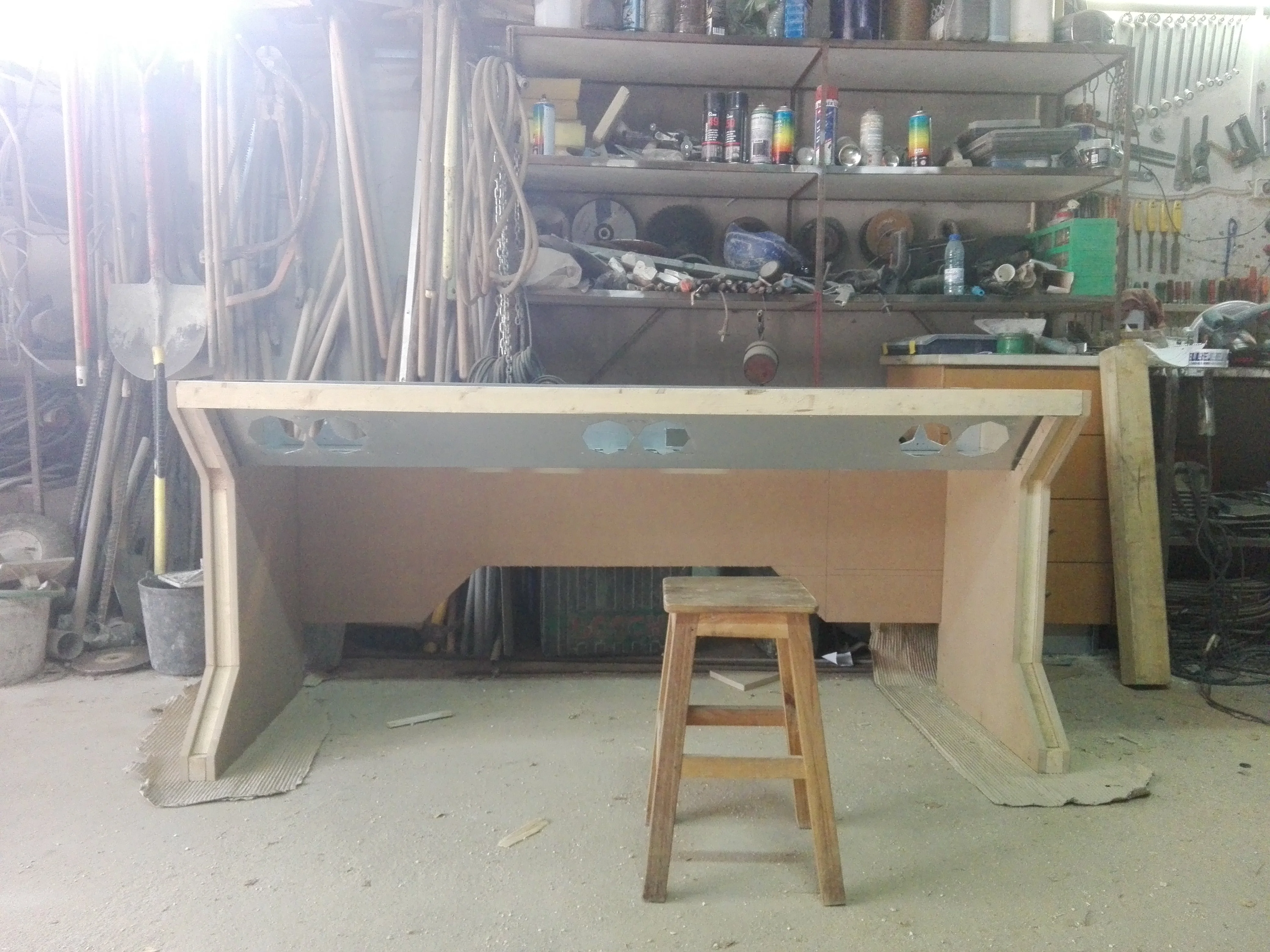

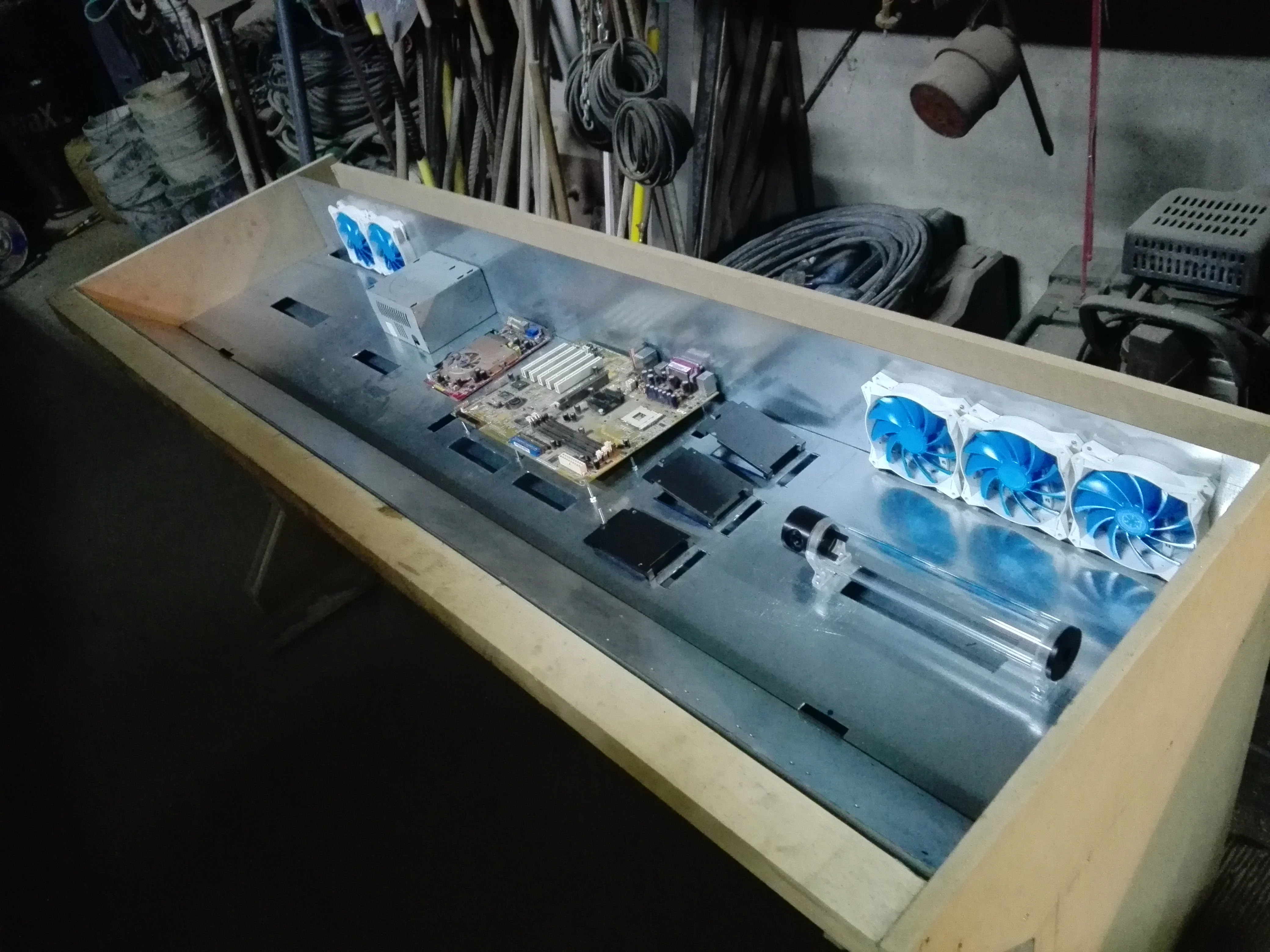

Hi everyone!
As I promise big update today, work myself hard these Saturday to place everything together, IM EXCITED!

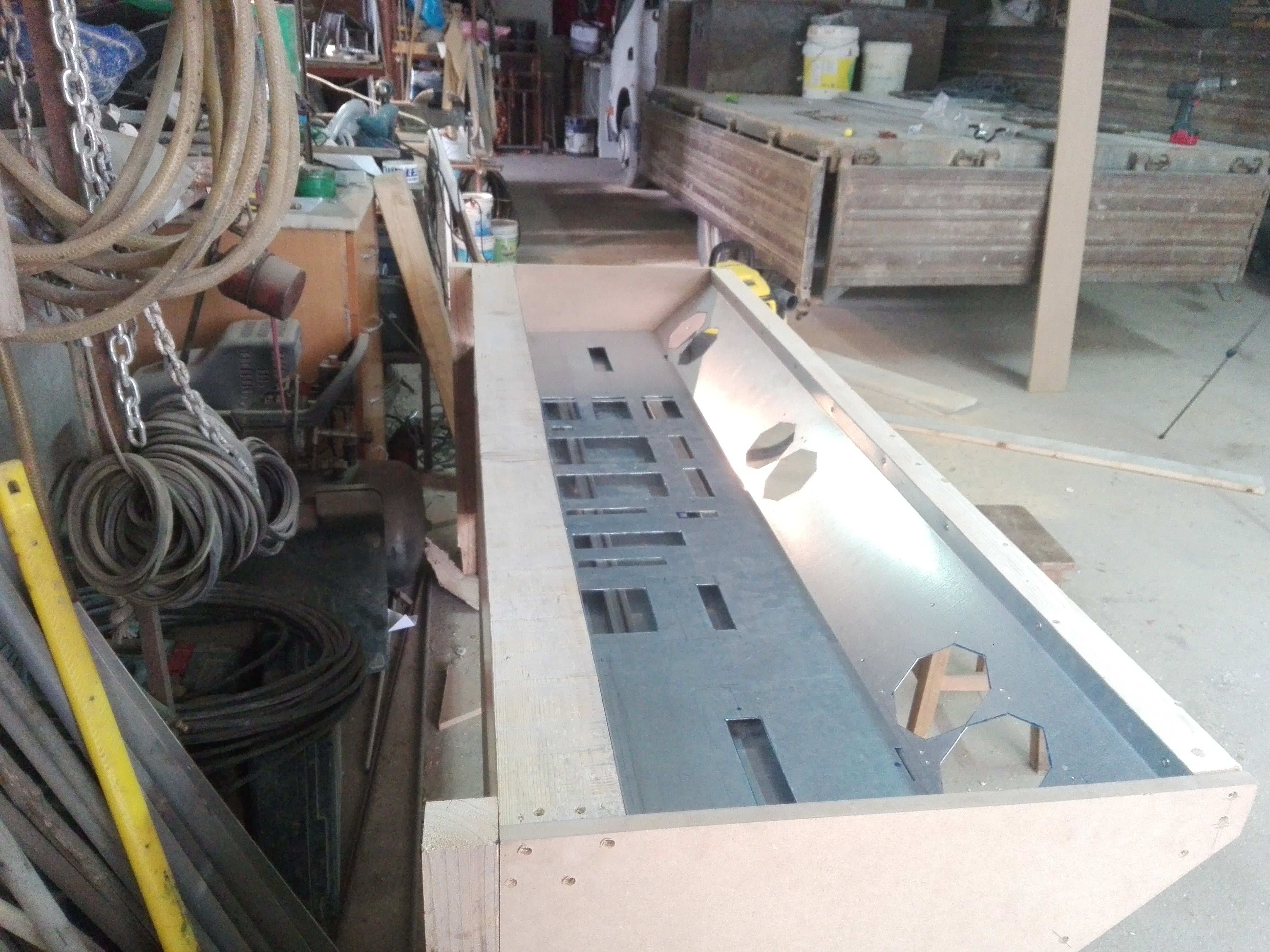

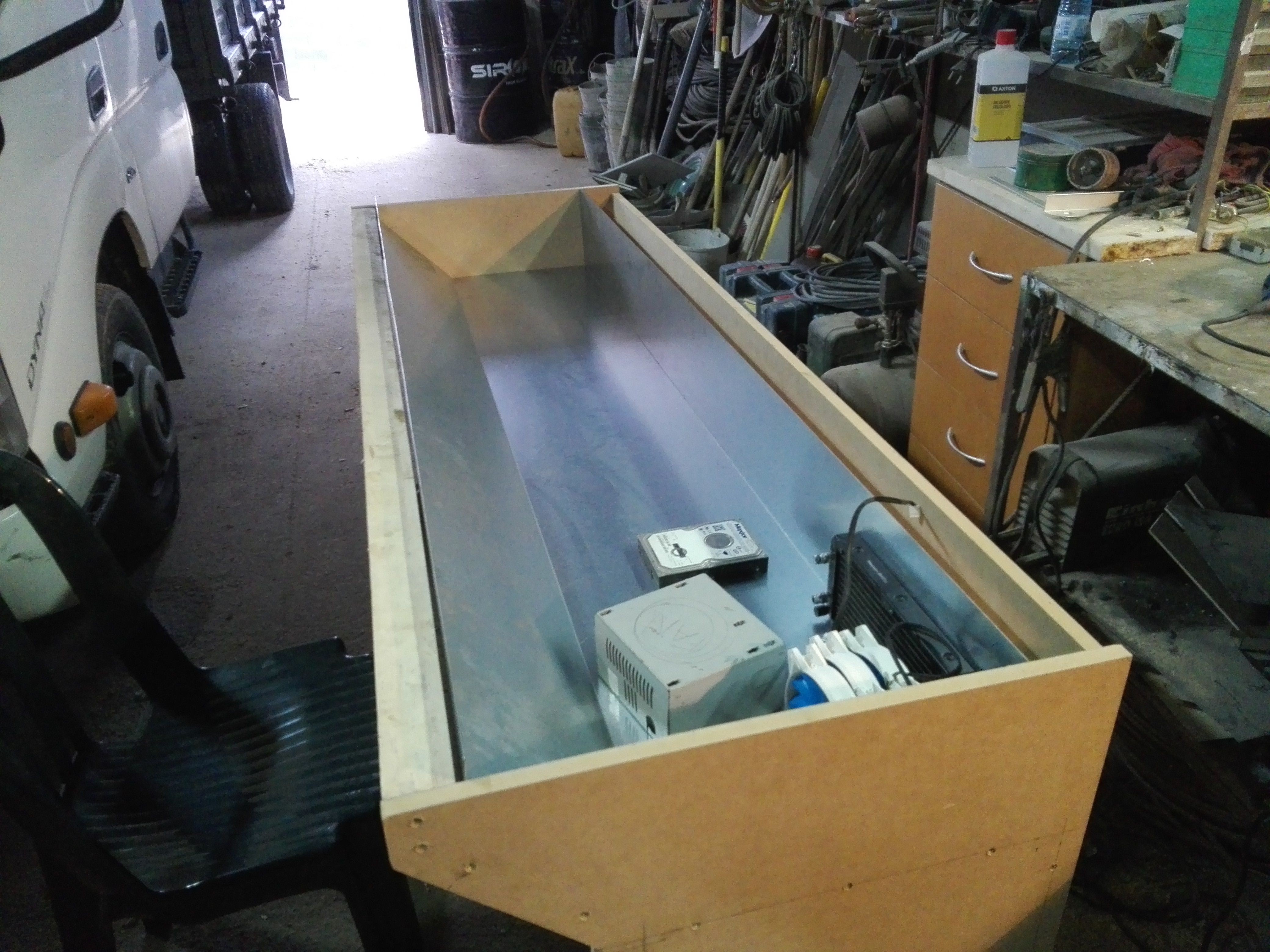

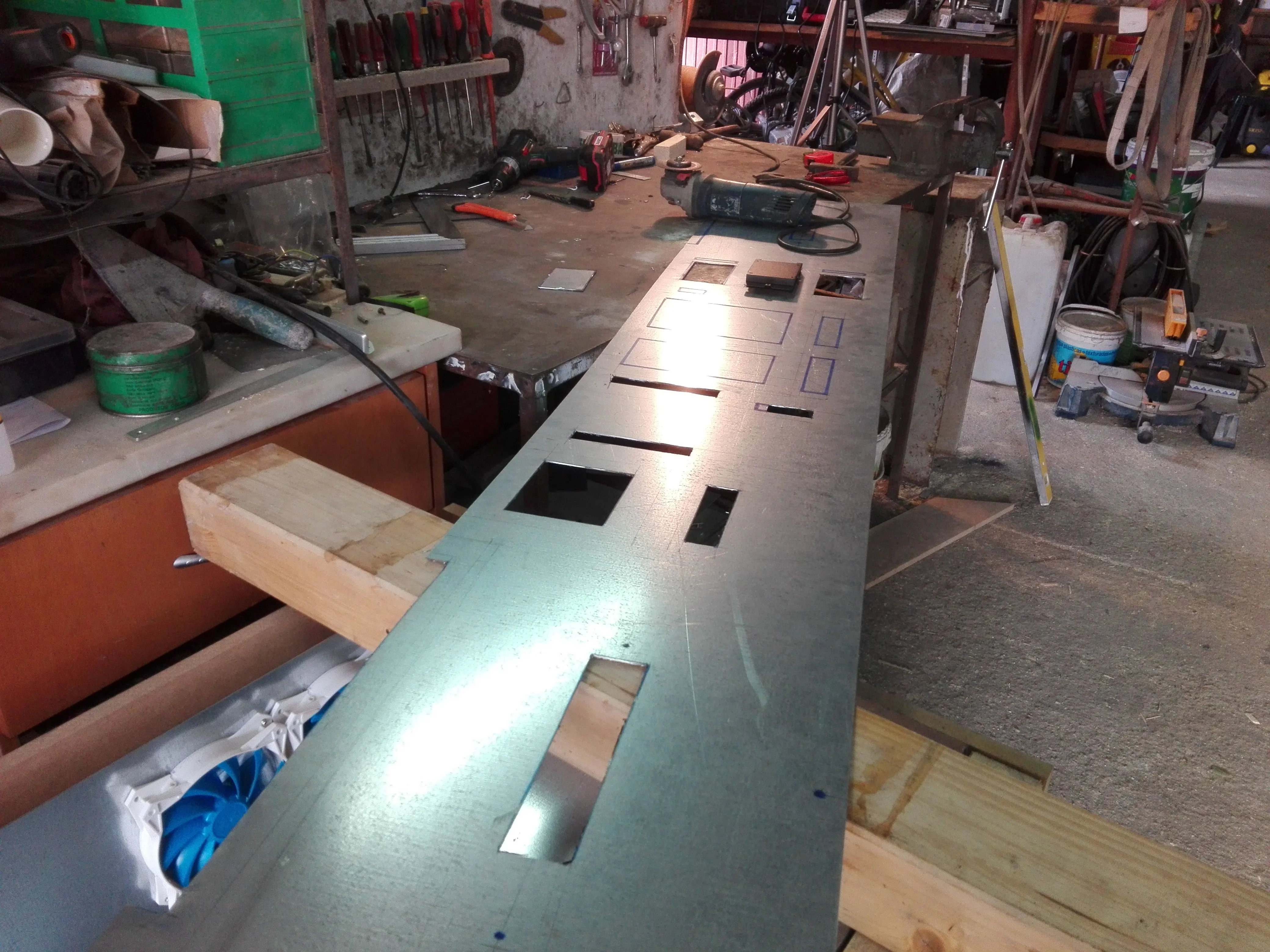

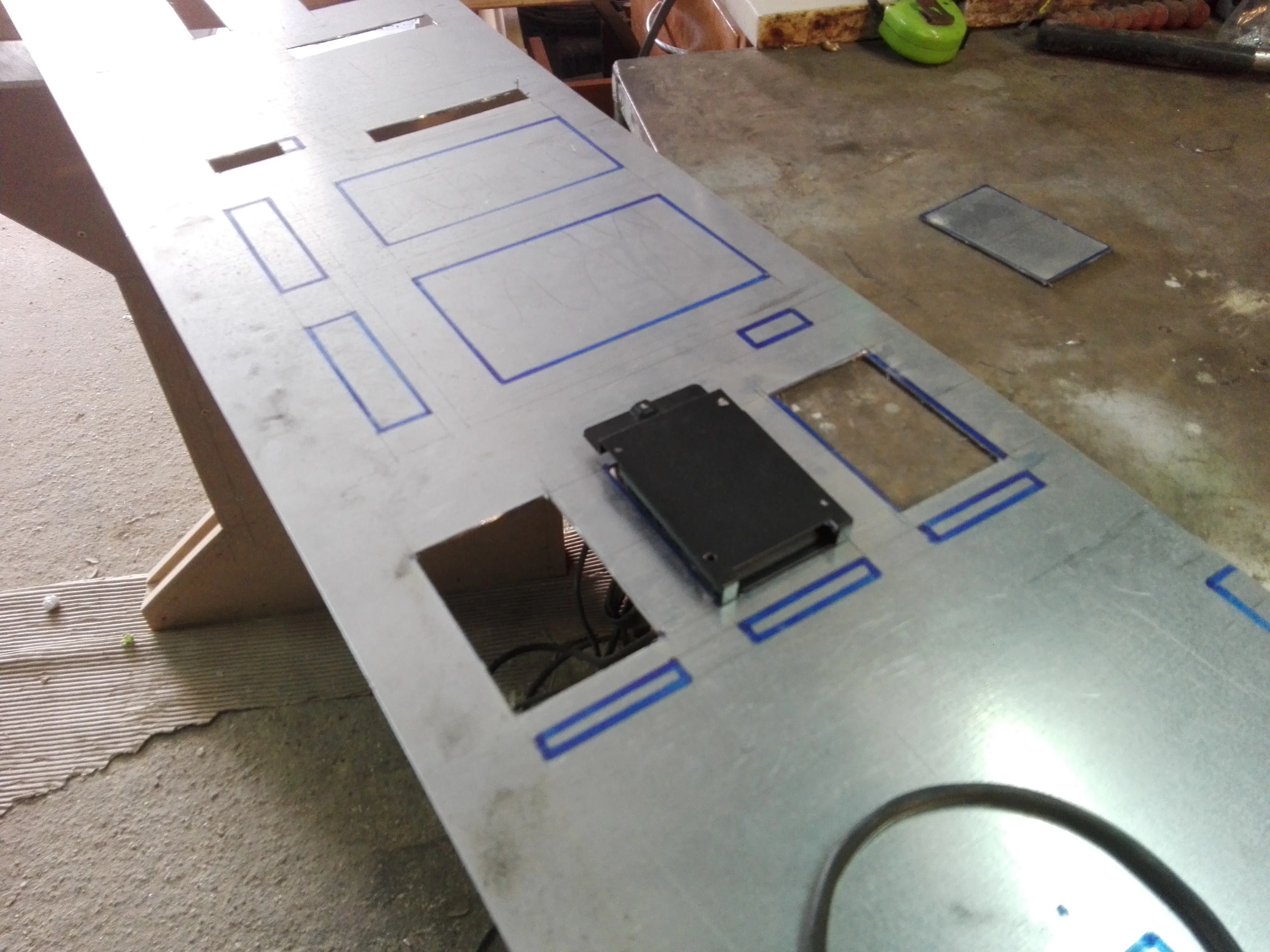

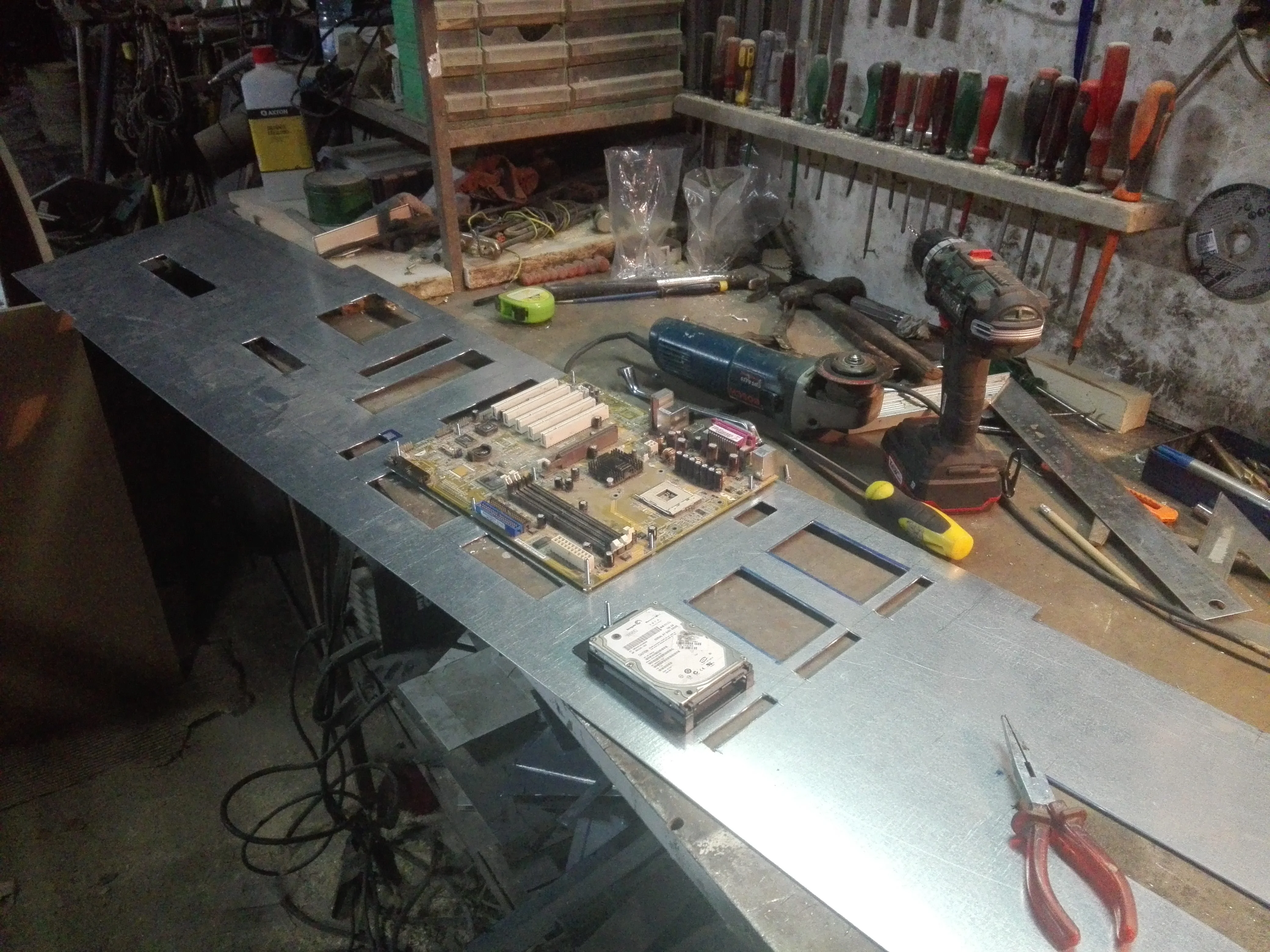

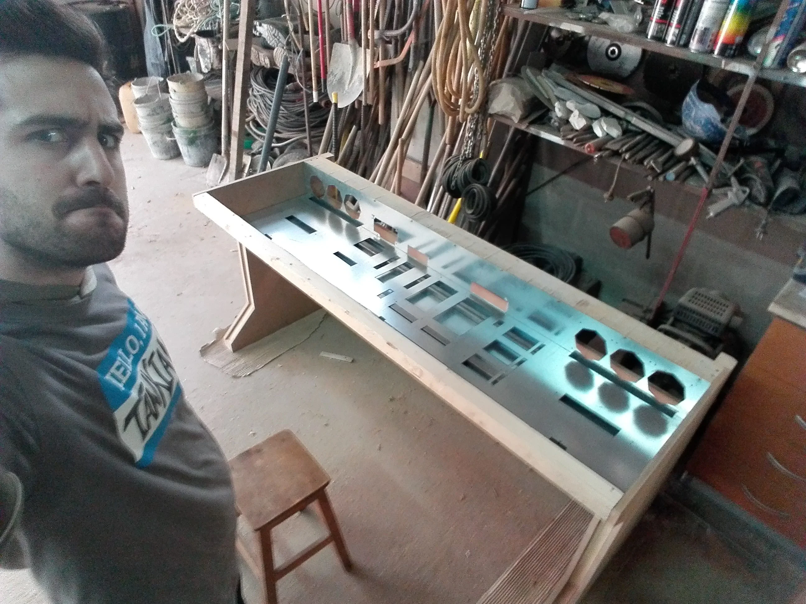

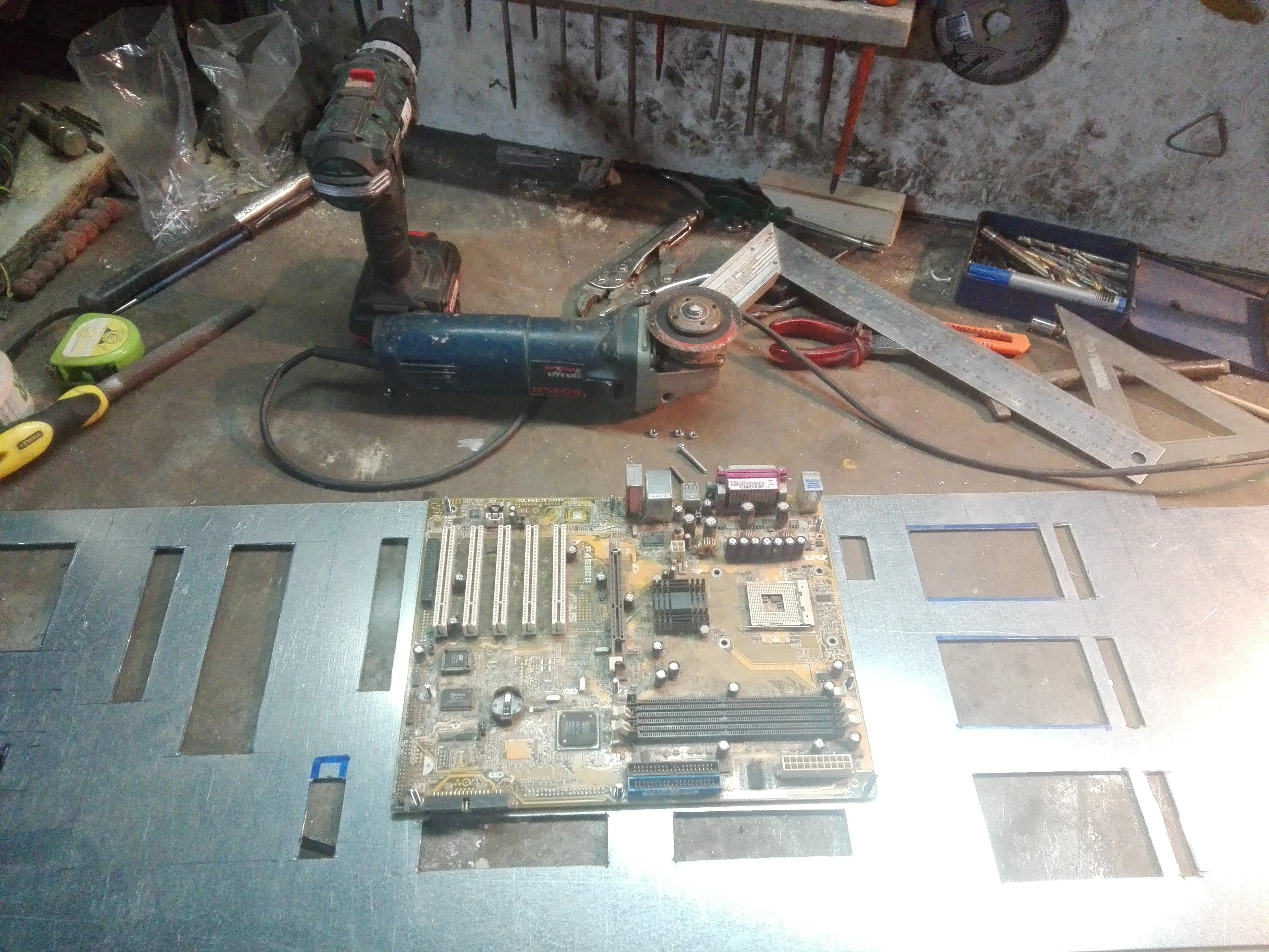

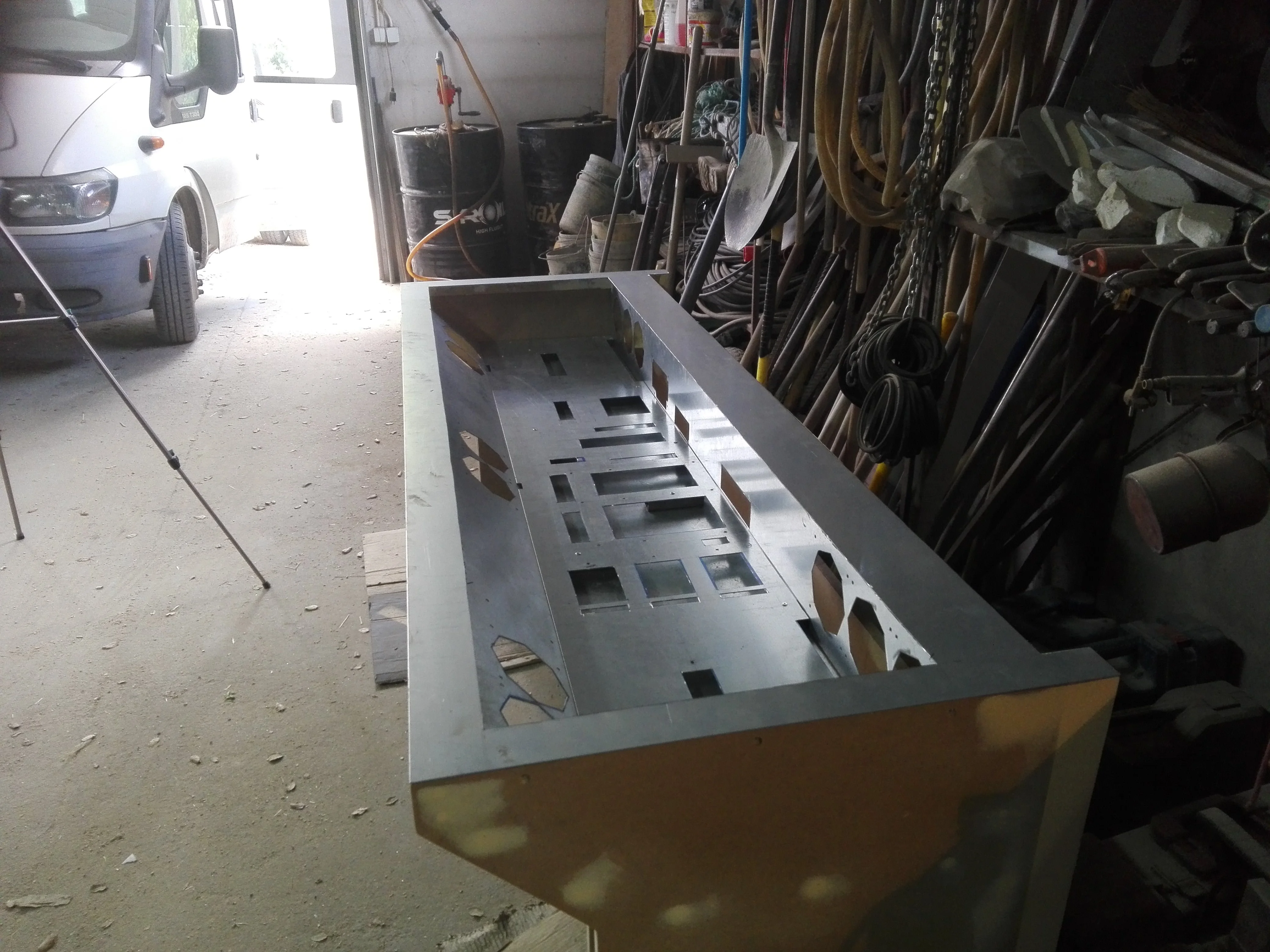

So I started with the fake bottom, making all the holes for cable routing/management. I don't want to attach the "fake bottom" in "bented" plate mostly because if I decide to redo anything in the future I will be able to remove it.

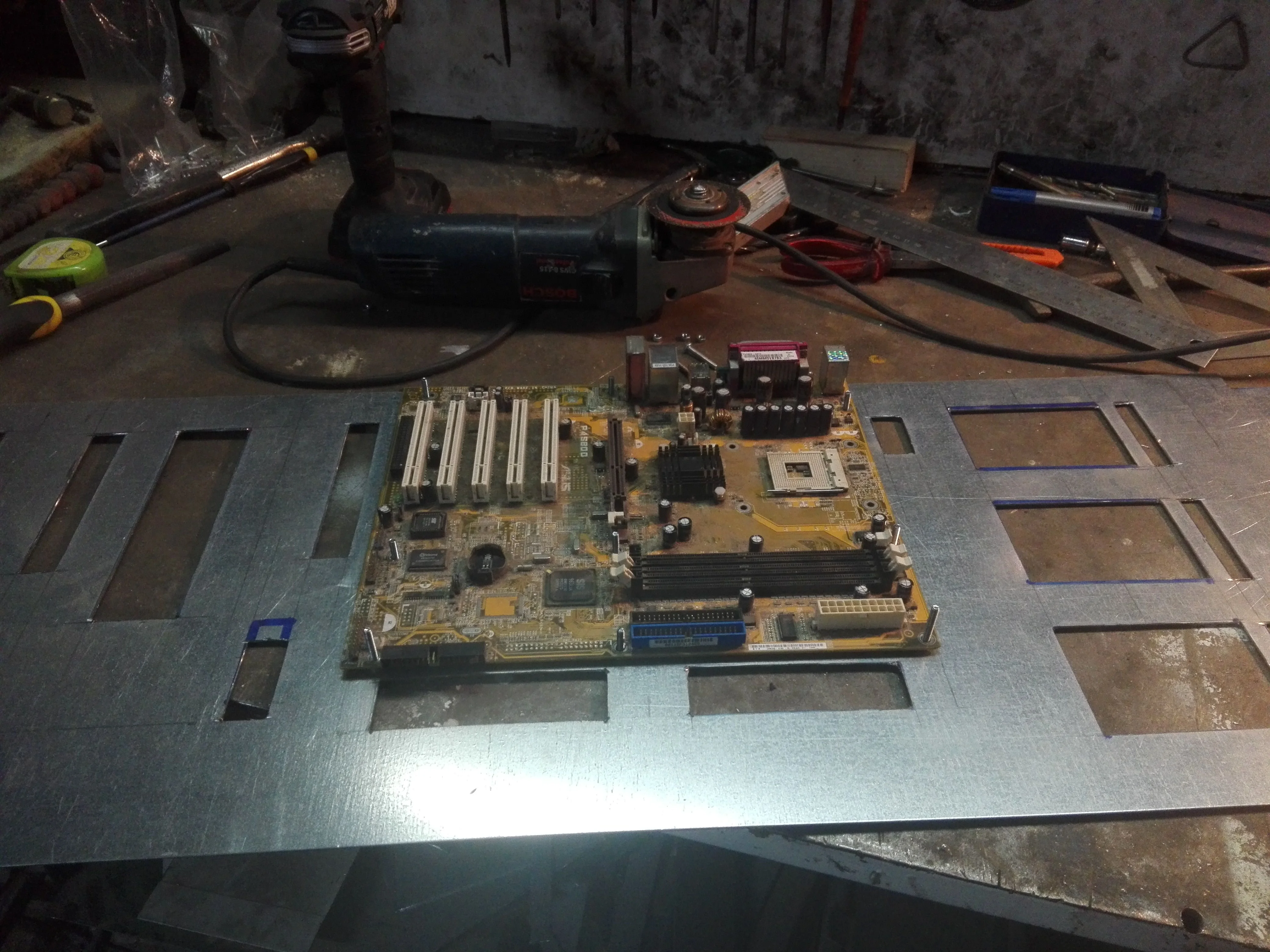

As you guys saw I did all the motherboard standoffs holes with a old motherboard only to be easier and more accurate, It ended up really well!

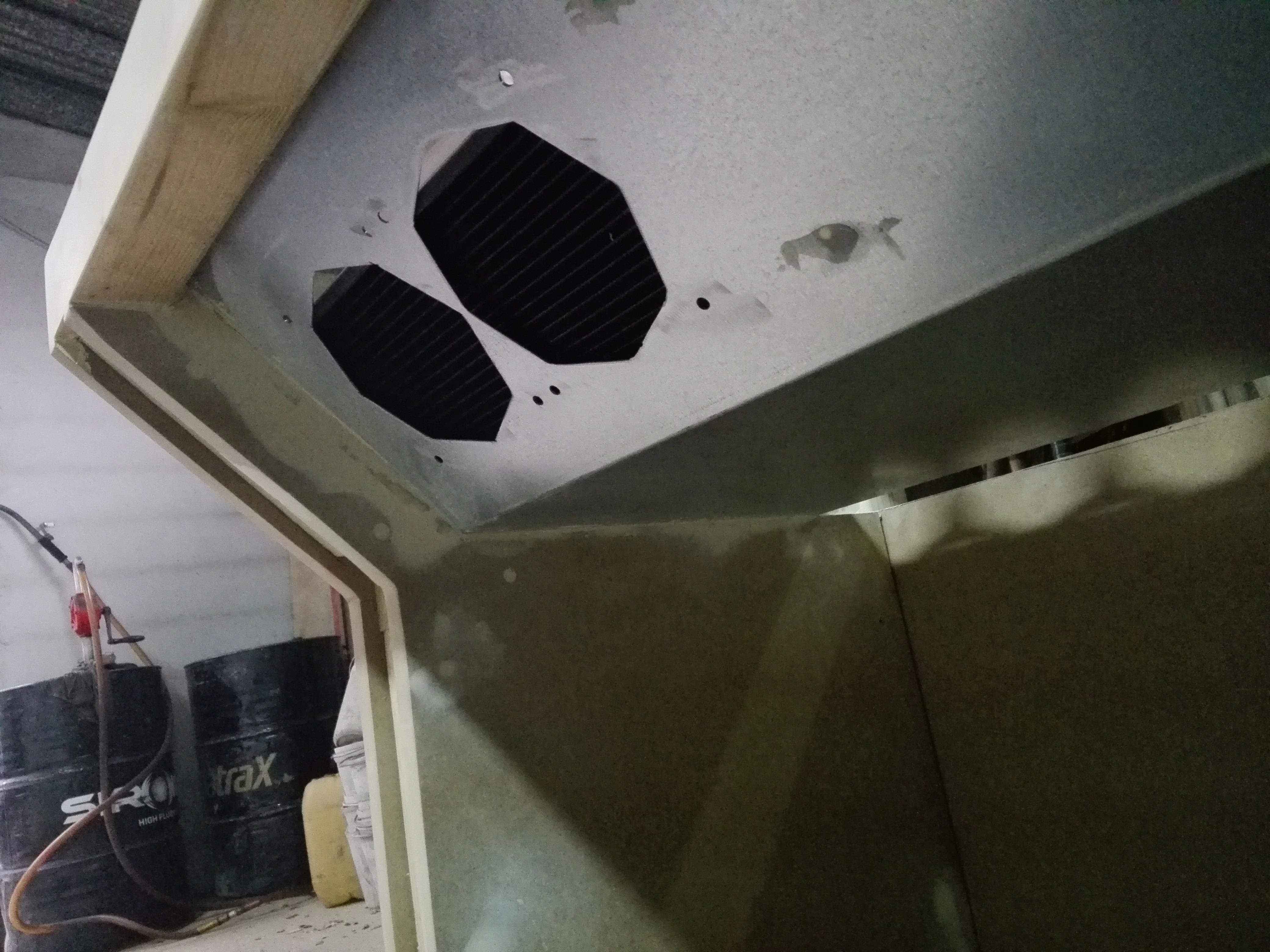

The fans was a bit disappointing I wanted to use a big drill to open a 110mm circle for each fan, but after waiting 1 week for that drill the store told me that I need to wait 3/4 mouths because they doesn't had stock available, so I decided to go with the octagon style.

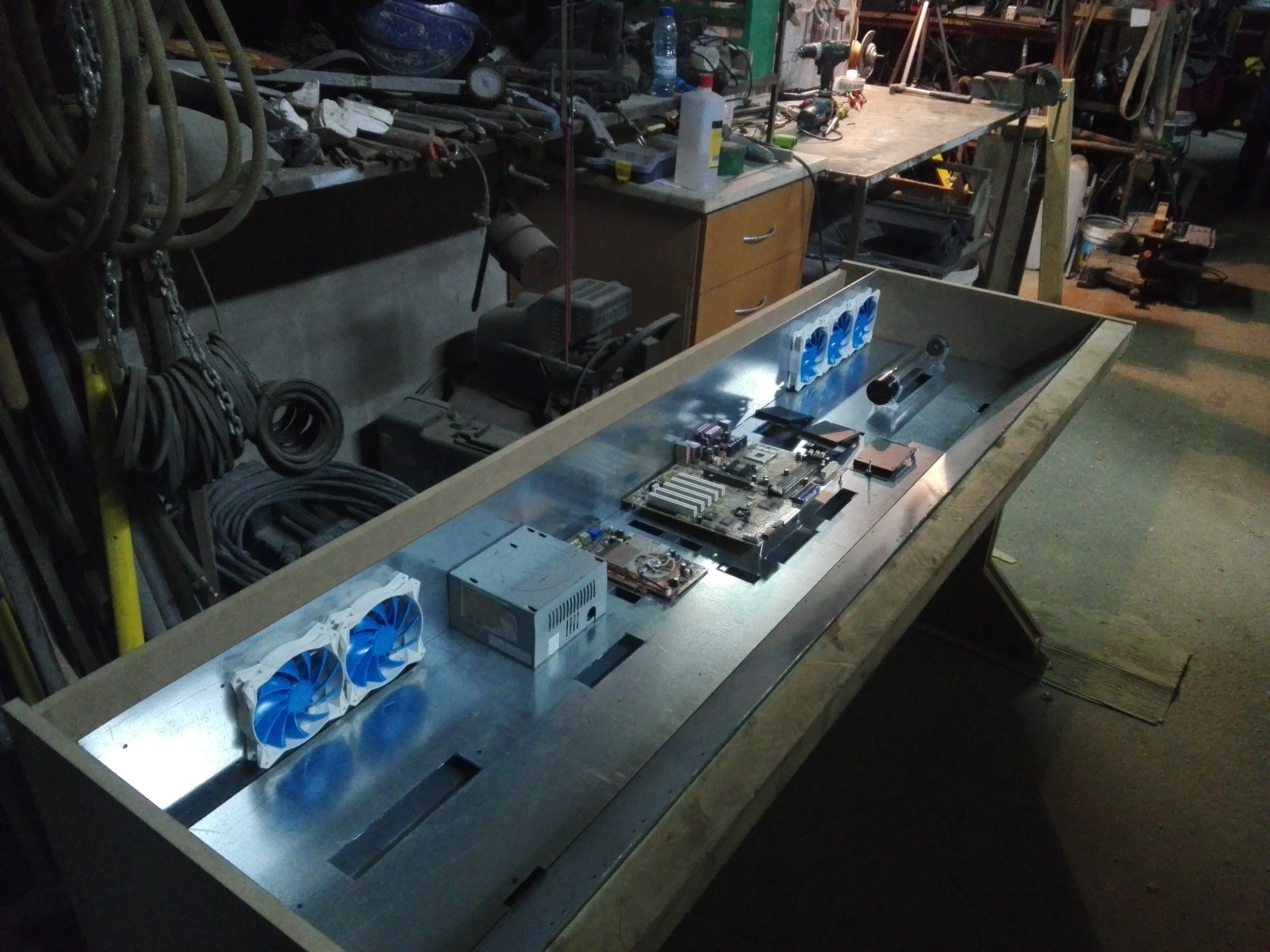

After doing all of these, big moment, atatch everything together, I was a bit afraid with the plate that stay in the top back, mostly because it will be use to secure the monitor holder, but after screw it against the metal it got really strong, so problem solved!
The two wooden bars that I use in the back are basicly to pass cables between the wall and the wood plank in the back, creating 50mm of space between the desk and the wall for the air that comes from the out-take fans go away.
Well lets move on to the photos and video! :rockout:

When the plate arrived
Cutting holes for cable routing in the "fake bottom" plate
Motherboard standoffs holes done.
Fans Holes
First Idea with the fans then I decided to go for 2 in each side and 2 in the middle

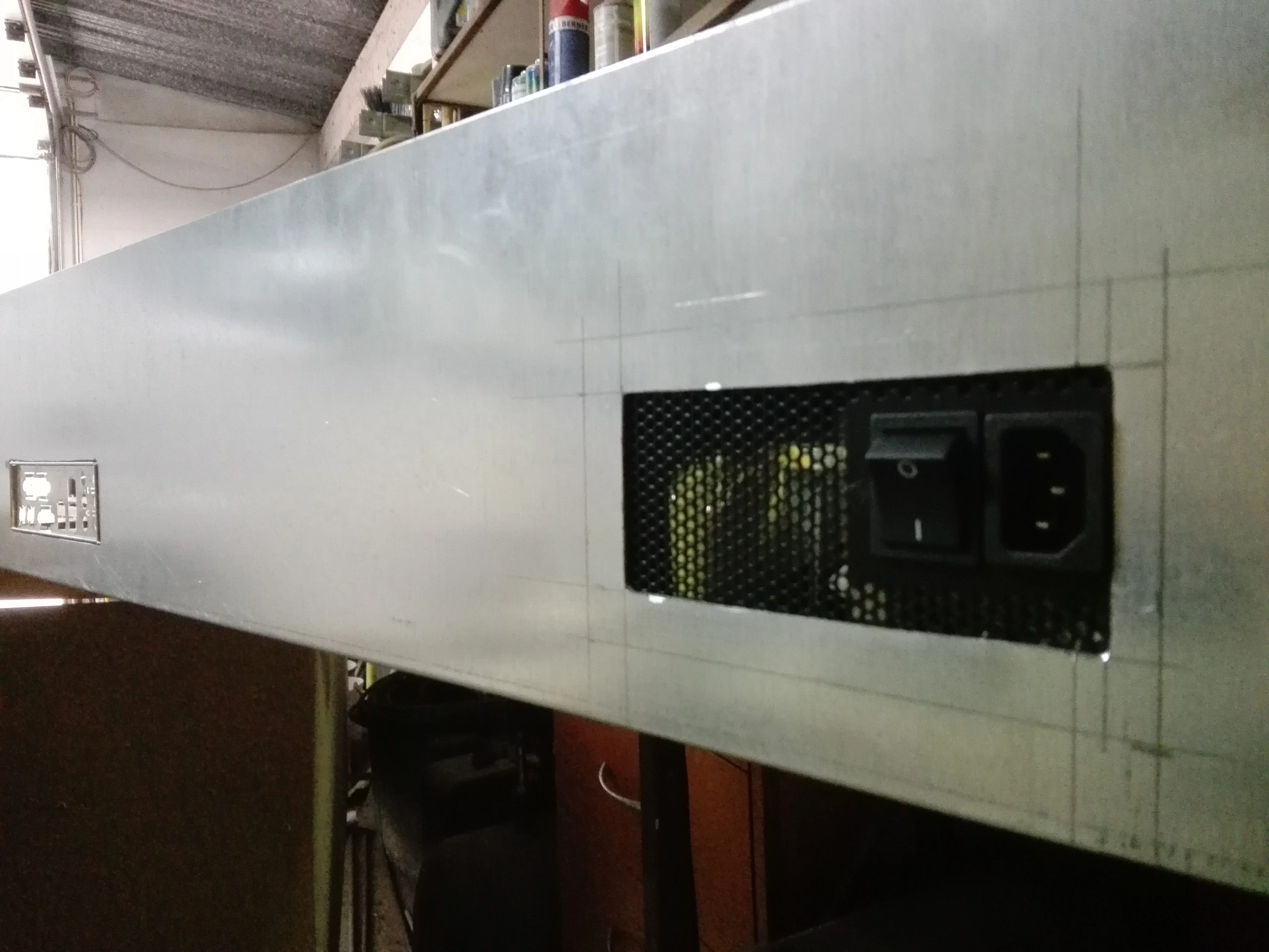

Power Supply back hole
Motherboard shield hole
GPU hole, with the 1080 ti testing is future home ahaha
Current state photos, here you can see the wooden bars in the back giving me the extra 5cm for cables and air flow

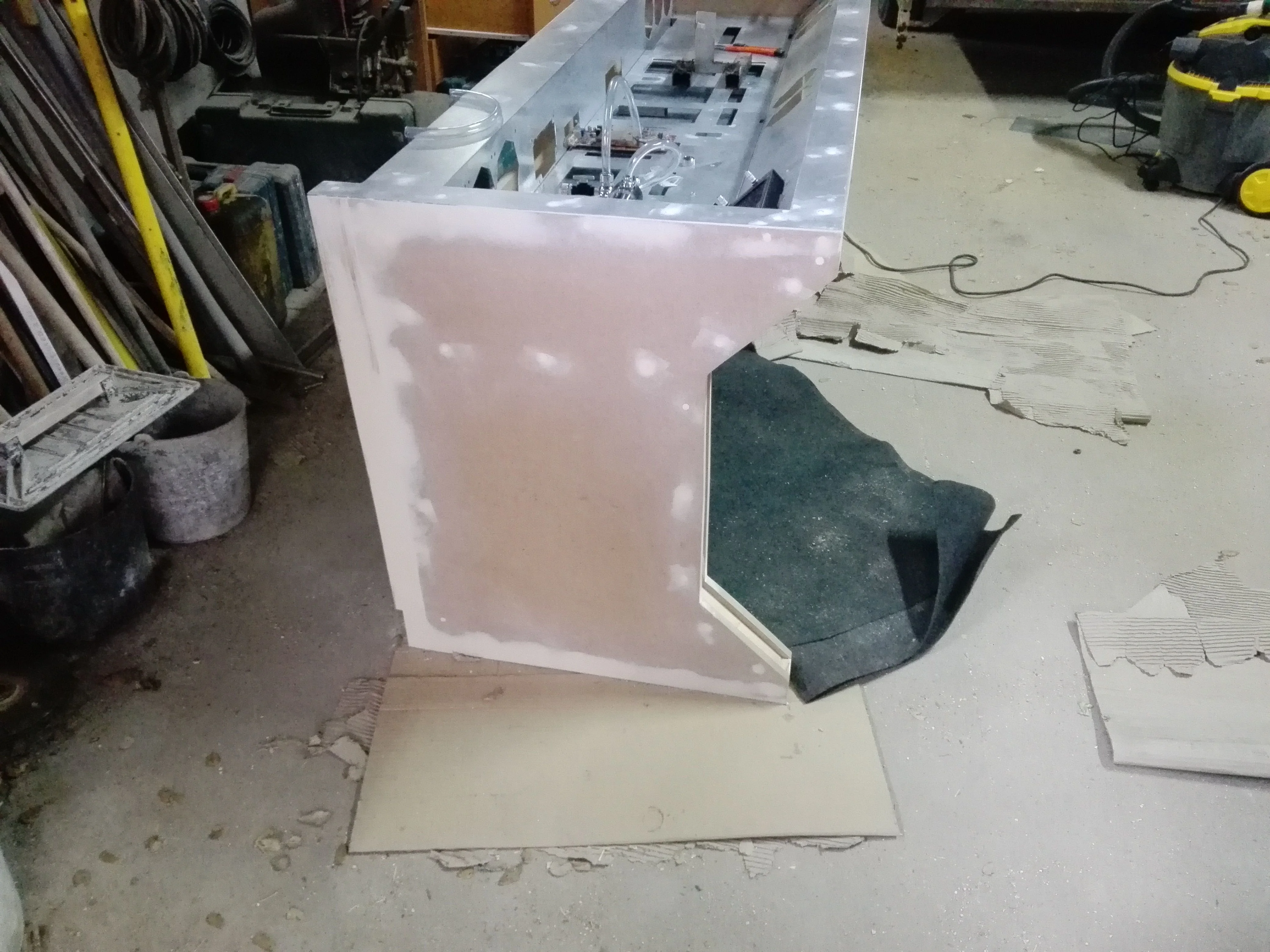

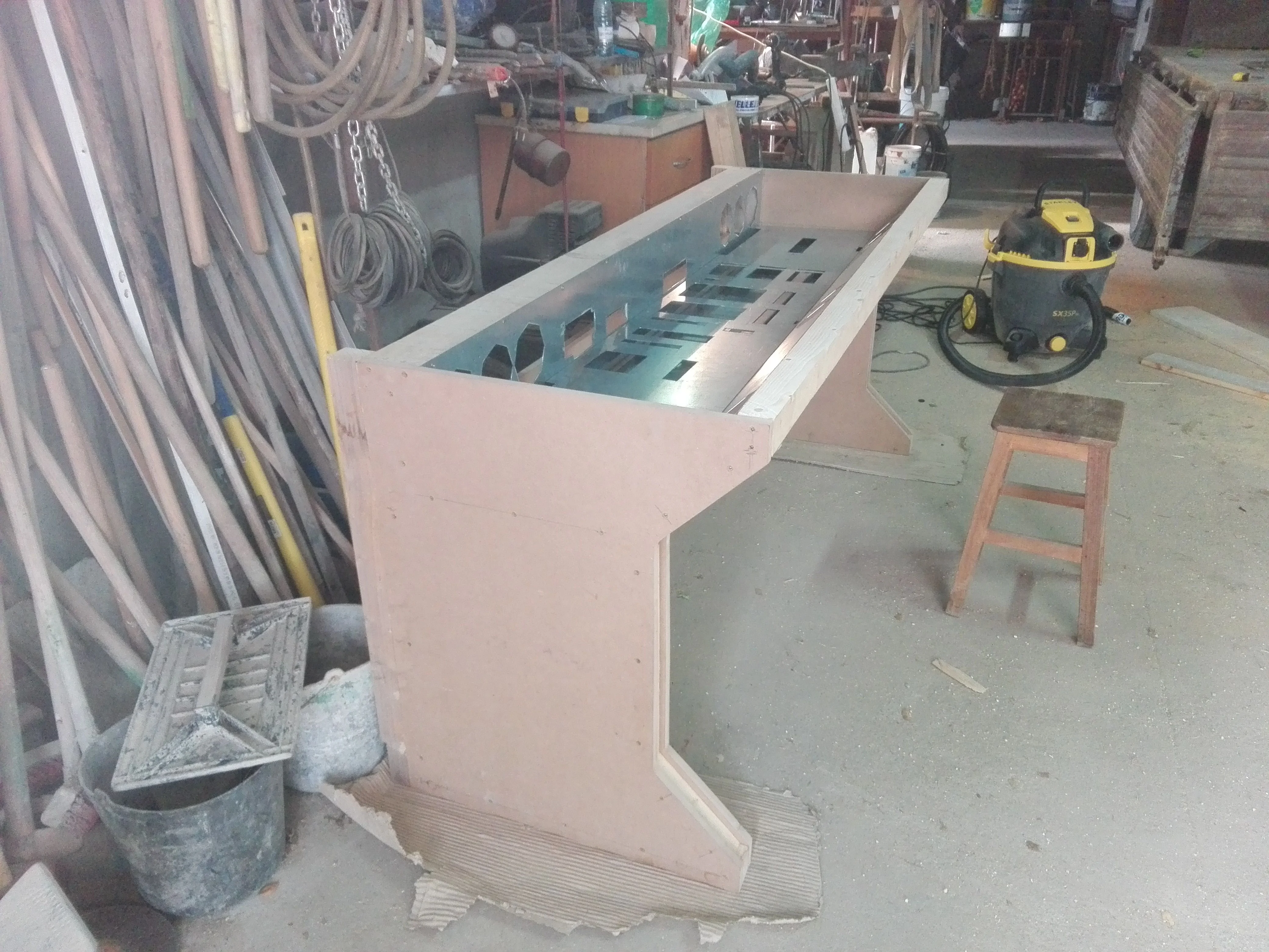

Hi everyone!

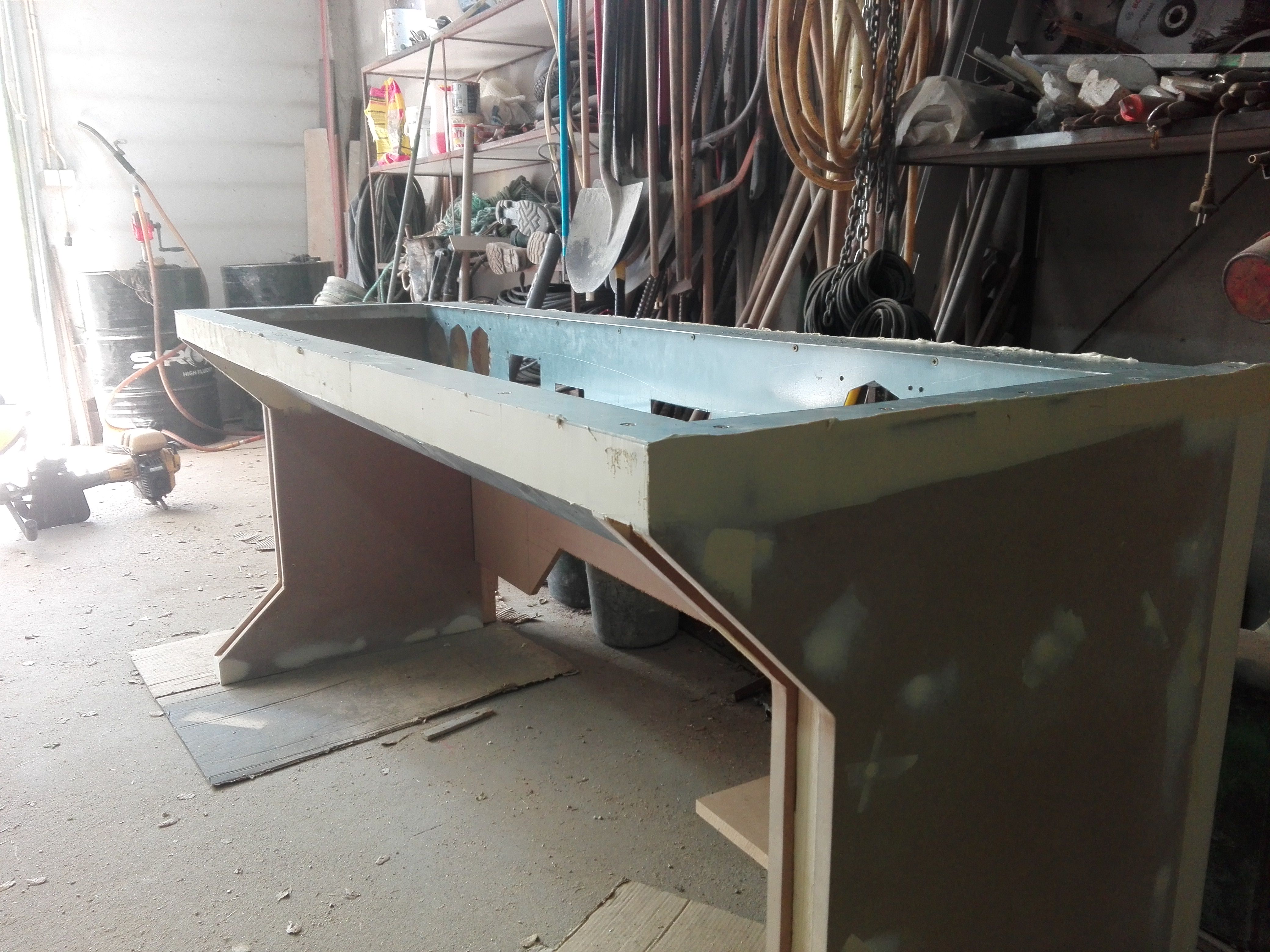

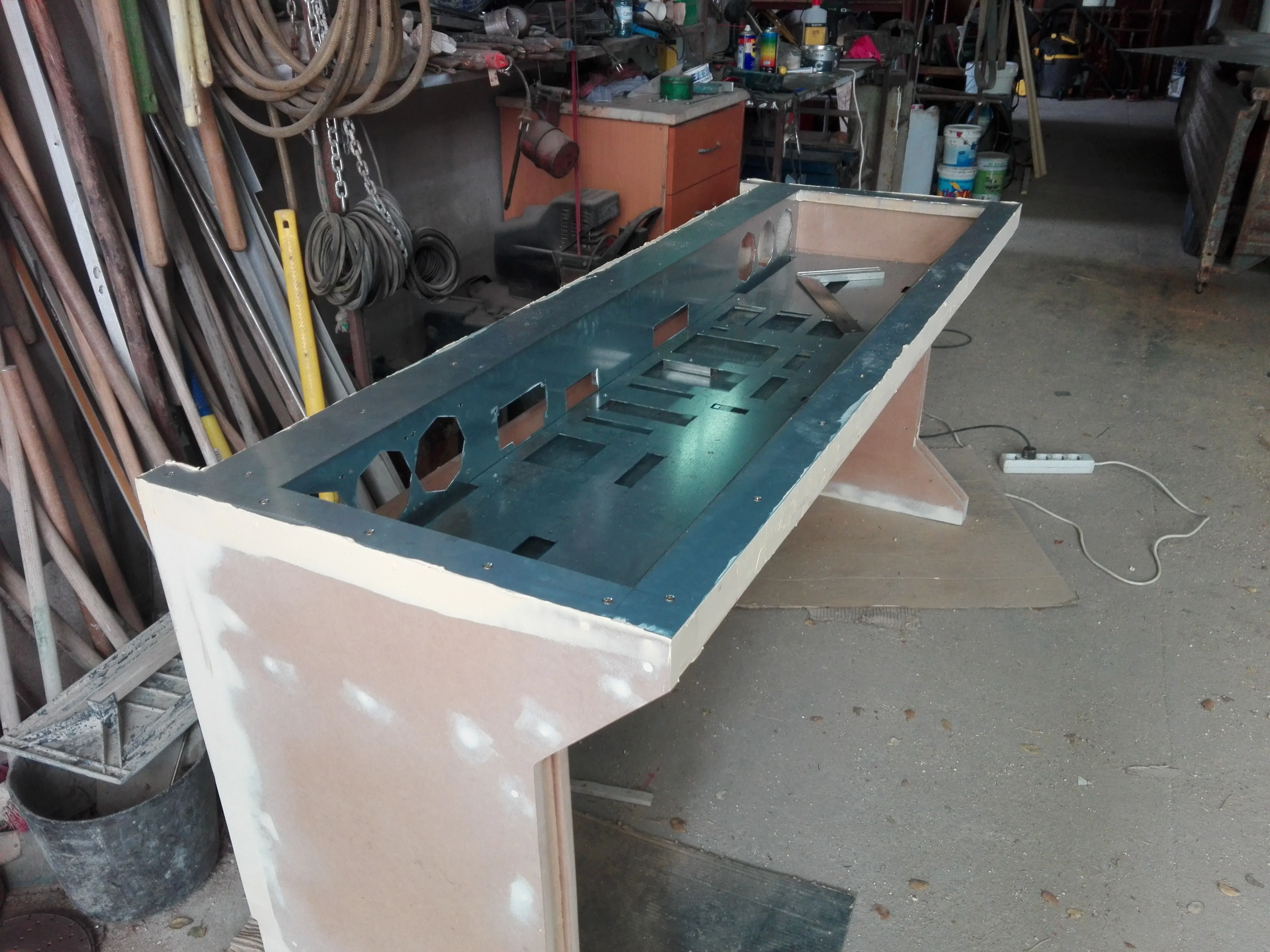

Well after 3 week I have news about the project, I manage to sand all the wood and metal pieces to apply the primer and even make some "upgrades" to the project concept.
So first I had to apply all the polyester in the areas needed, I even had to apply it more thant one time in the same place, something I expect but took me a bit more time to set everything ready to primer the desk.
After aplying it in some areas I decide to make a rim all arround the top area to give a bit more resistance to the desk and provide a better surface for the glass, at the same time providing a trim all around the center "hole" to place some LED if needed.
Then was time to apply once again polyester in some areas to make everthing look better.
After sanding and applying the primer I realise something was a bit miss align in for the glass so before painting and get mad about the miss align thing yesterday I decide to correct it, I applied again primer to the front section and order the glass!

Subwoofer Stand
Polyester and sanding
Water Cooling "ideas"
Primer applied
Small correction I did

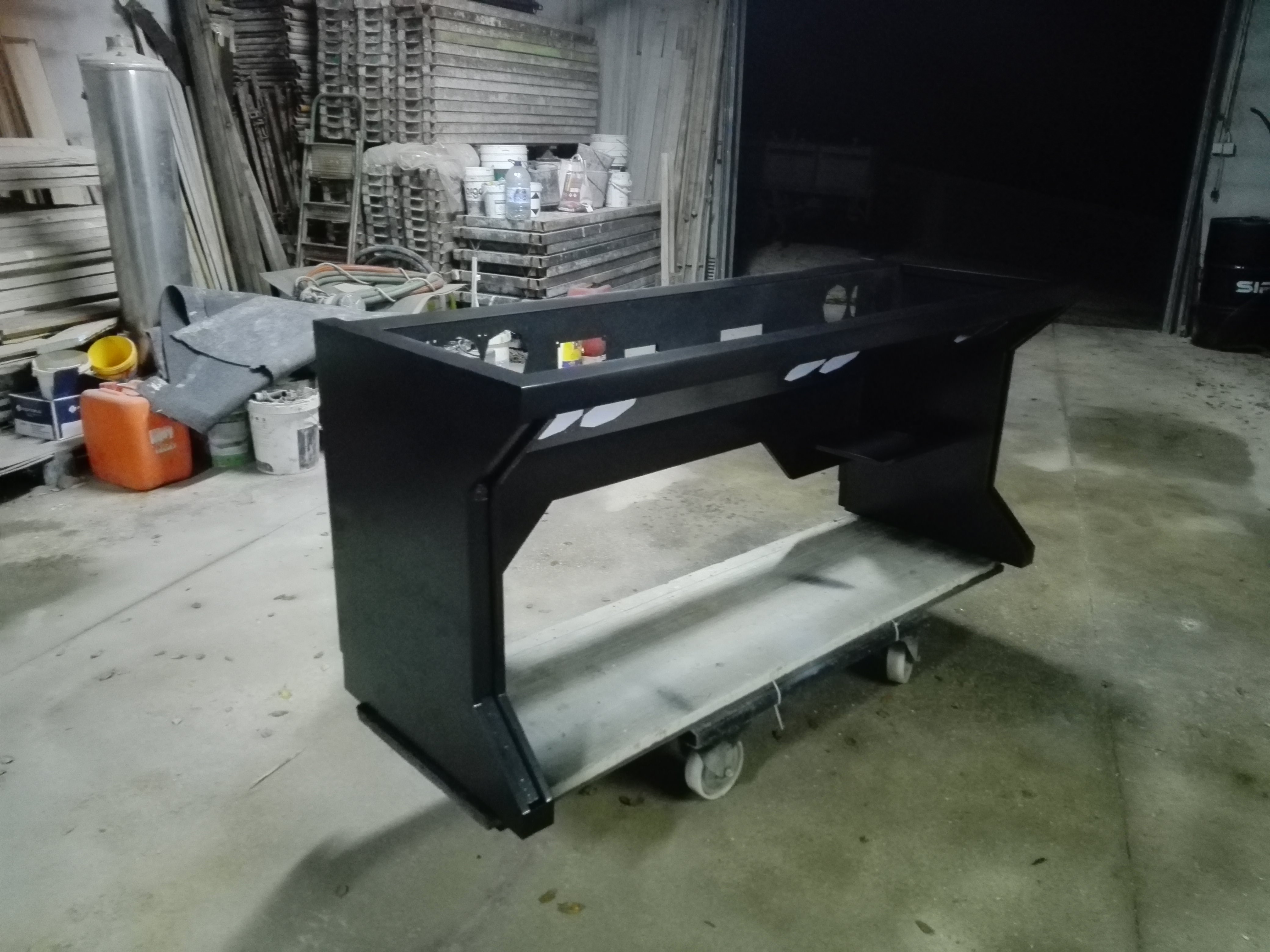

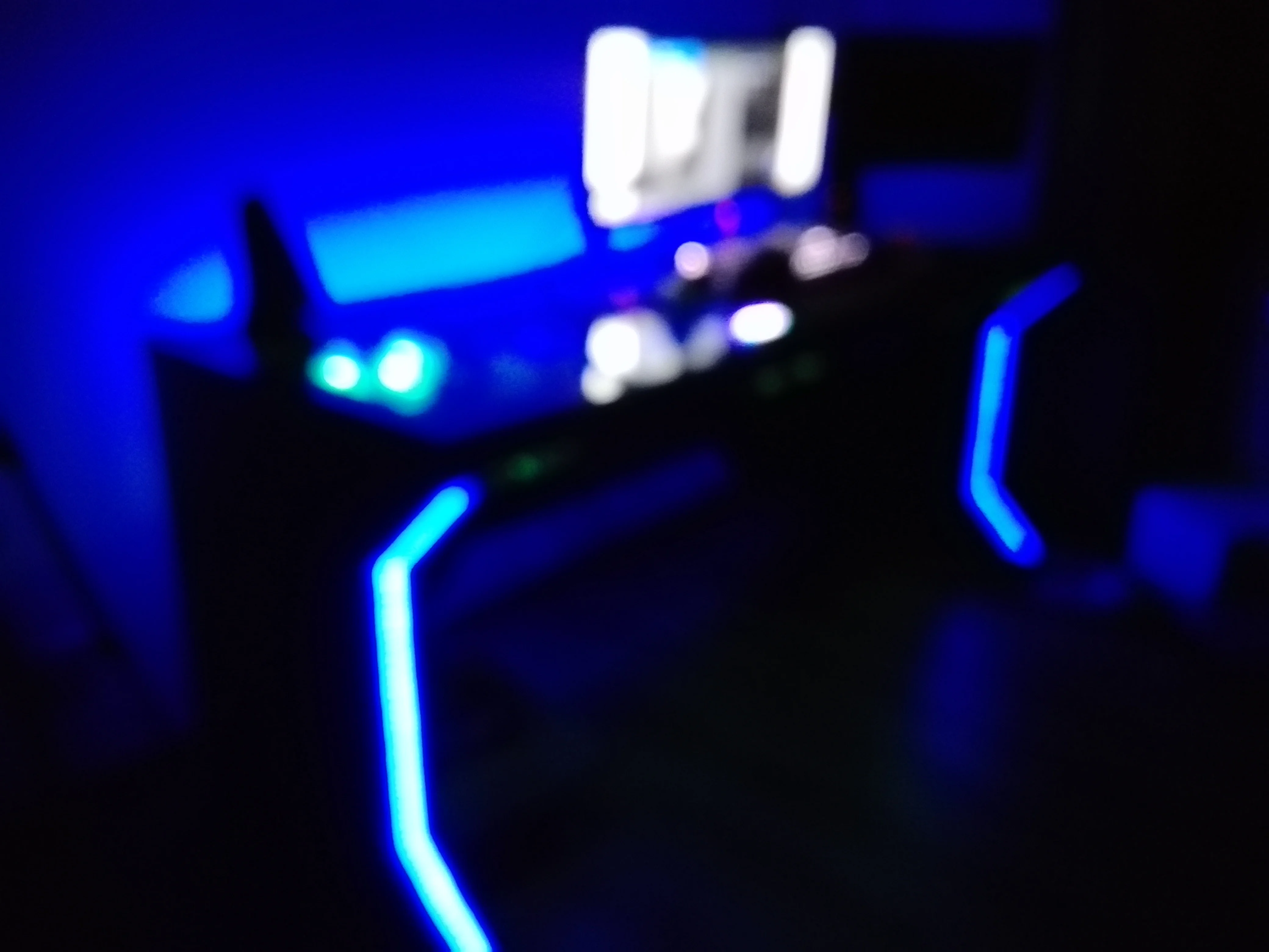

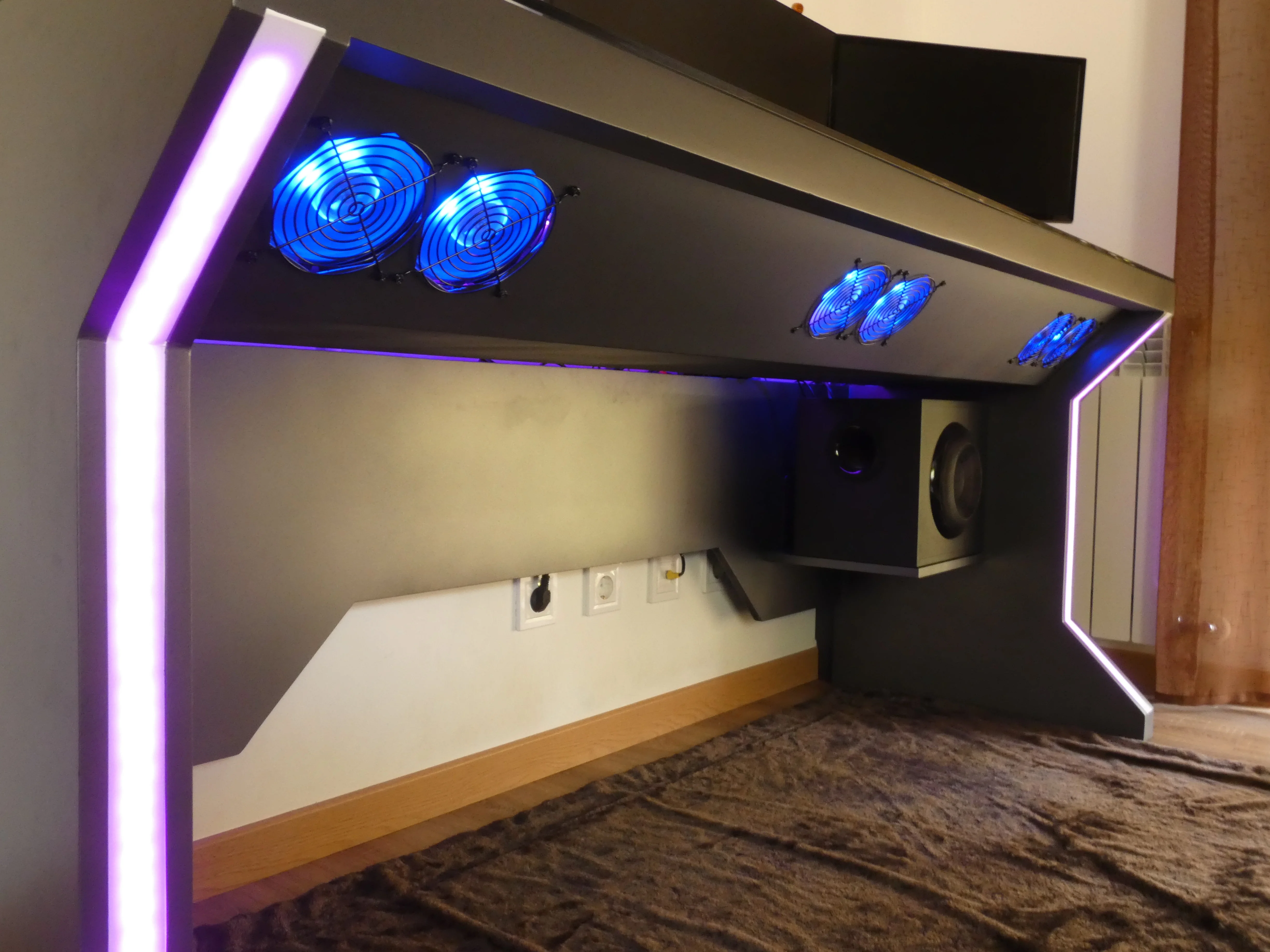

Hi everyone another update!

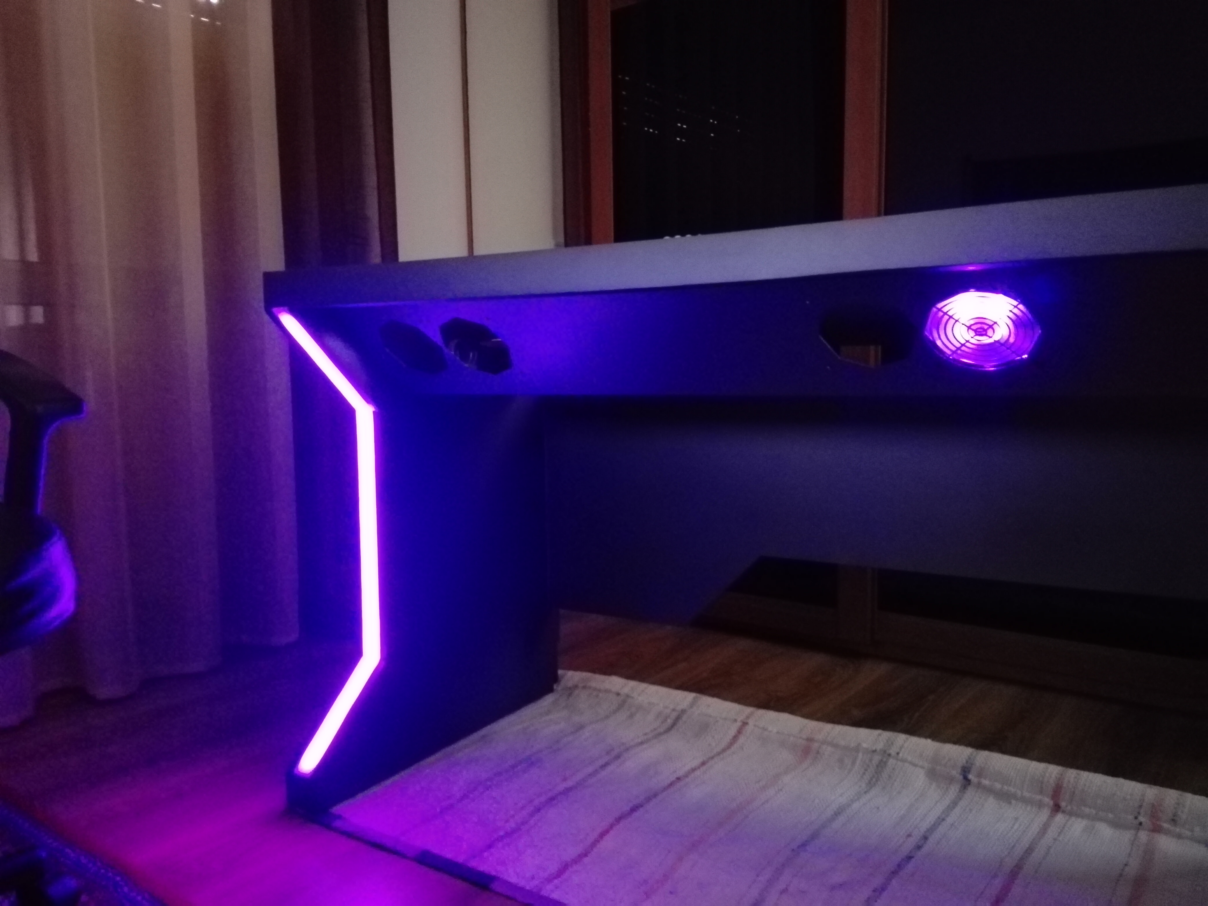

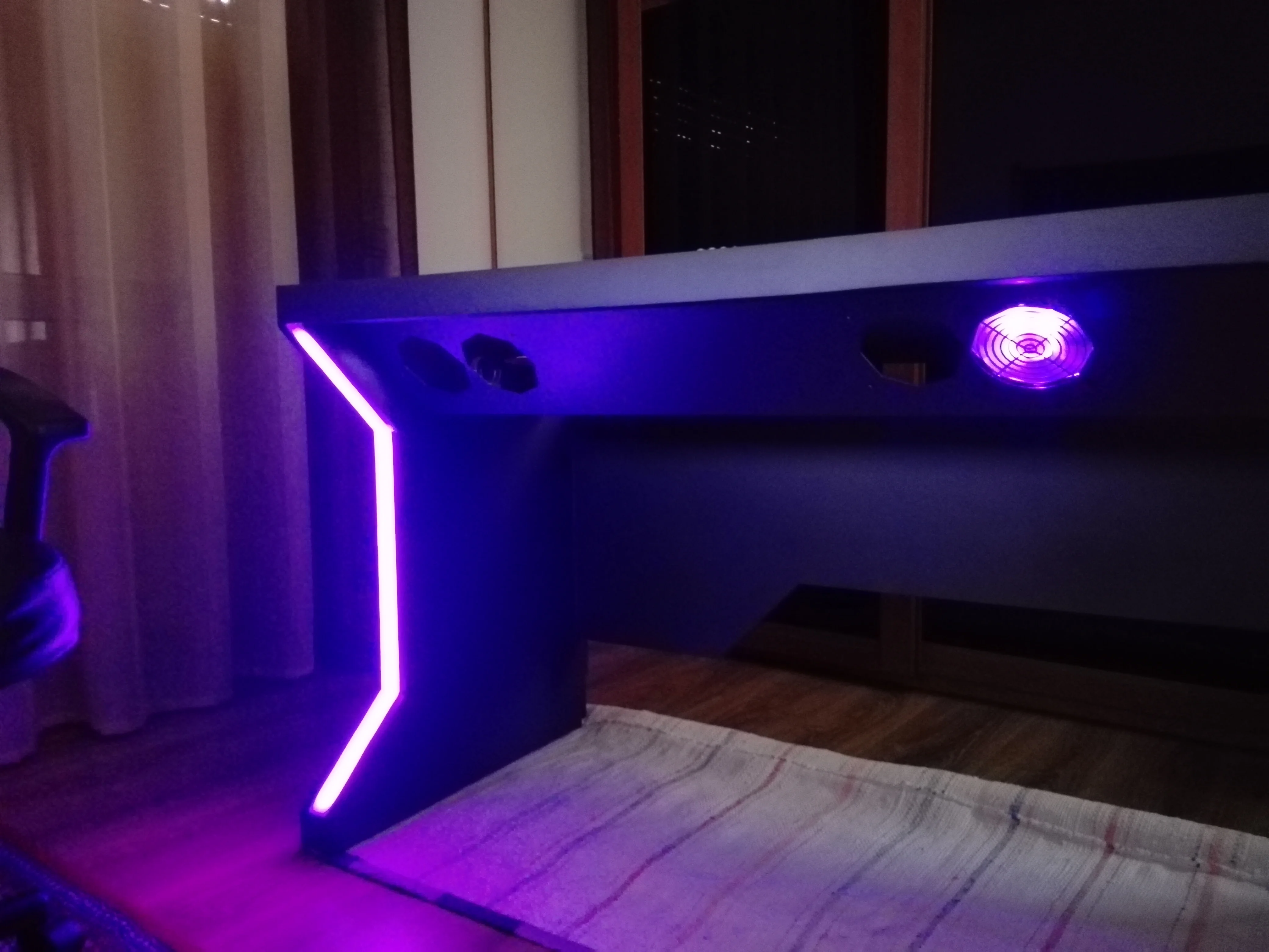

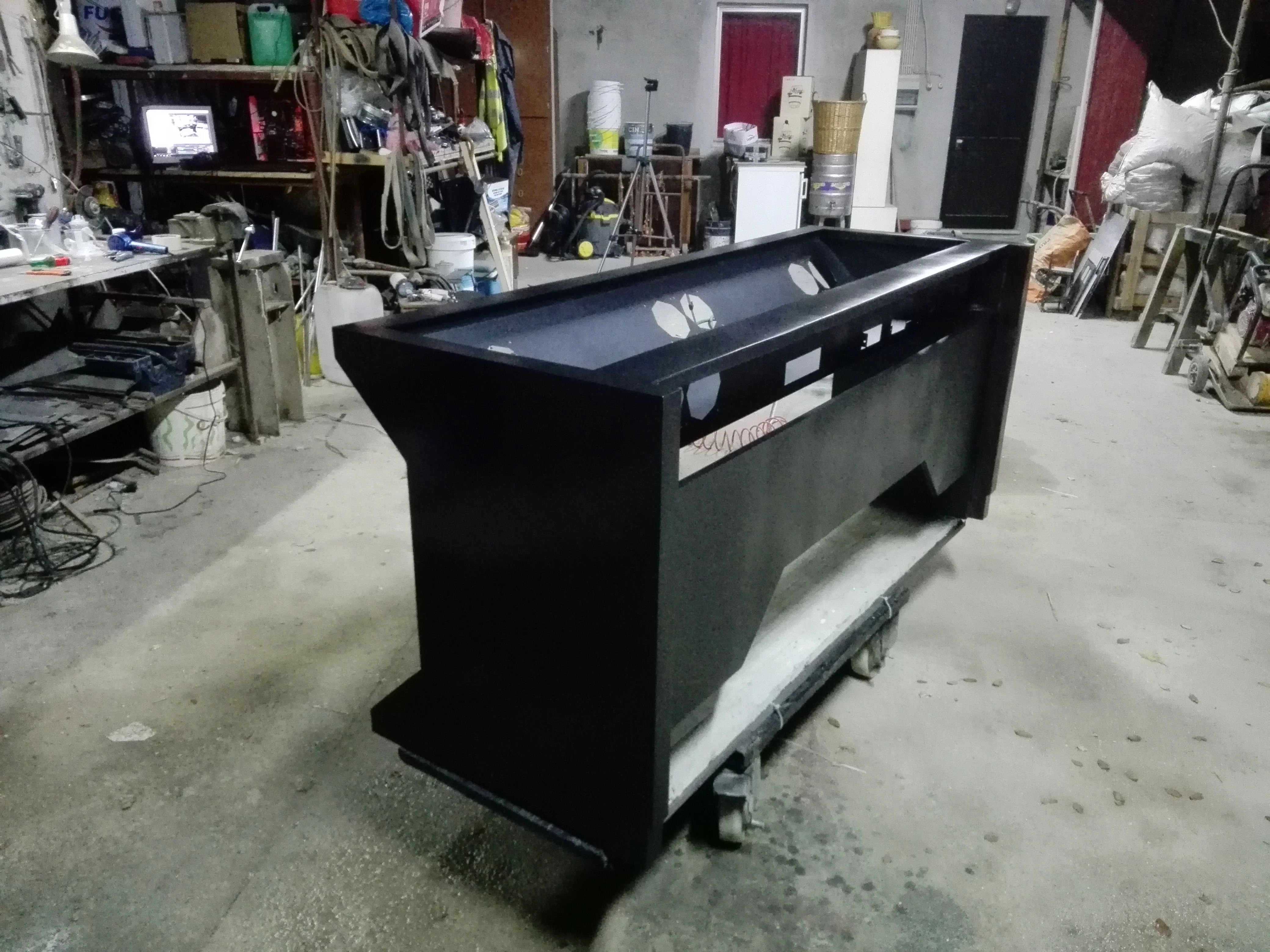

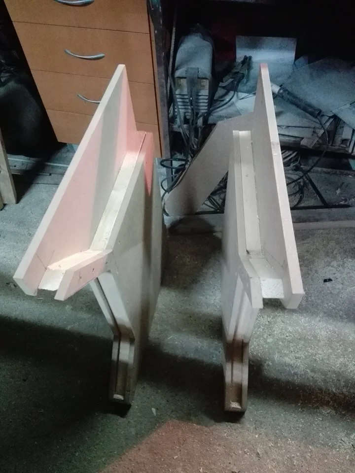

So I manage to paint the desk, even painted 2 times, in the first time the coulor was to dark so I had to paint the desk again. After painting the outside I used black matte spray for the inside.

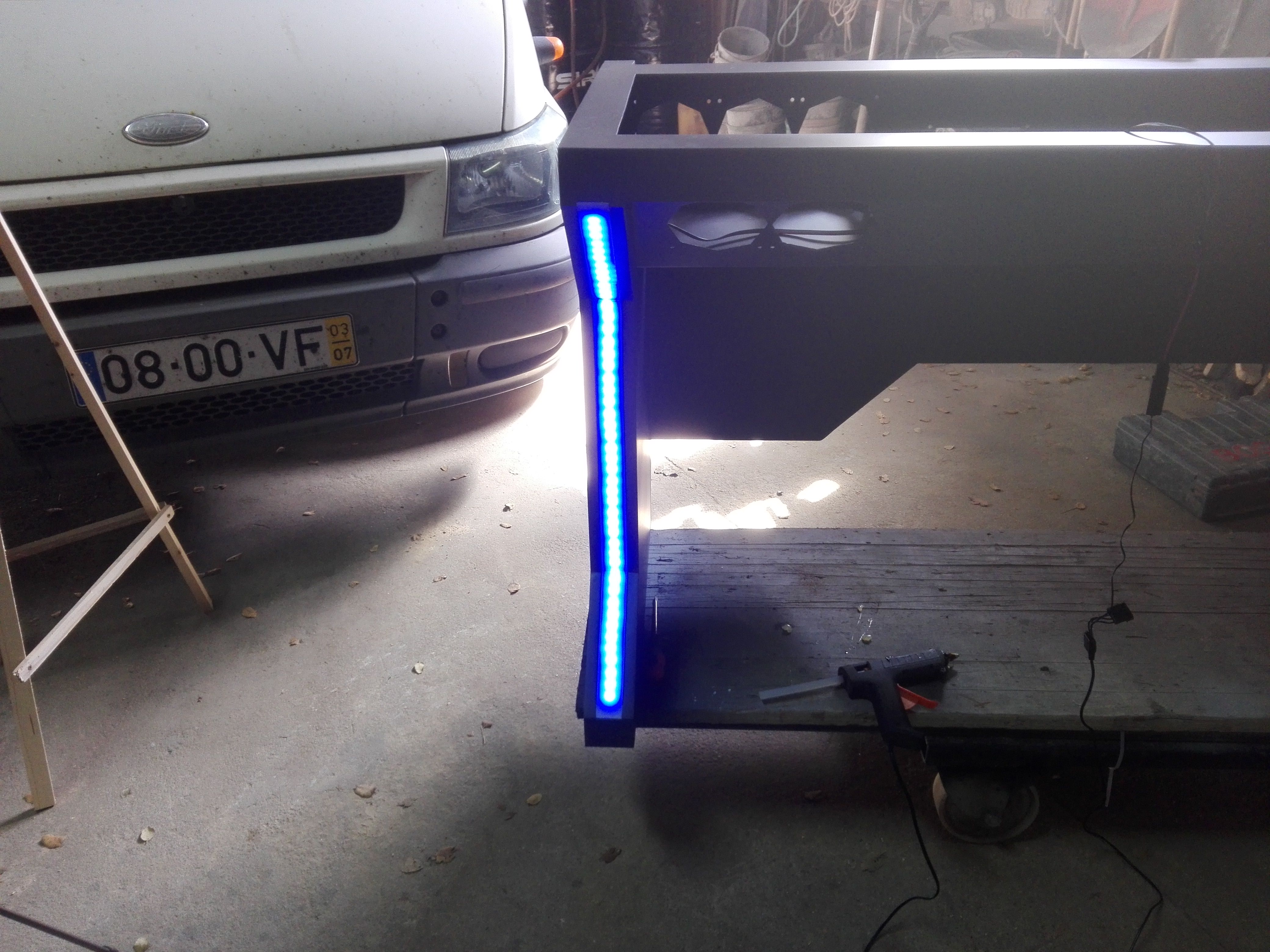

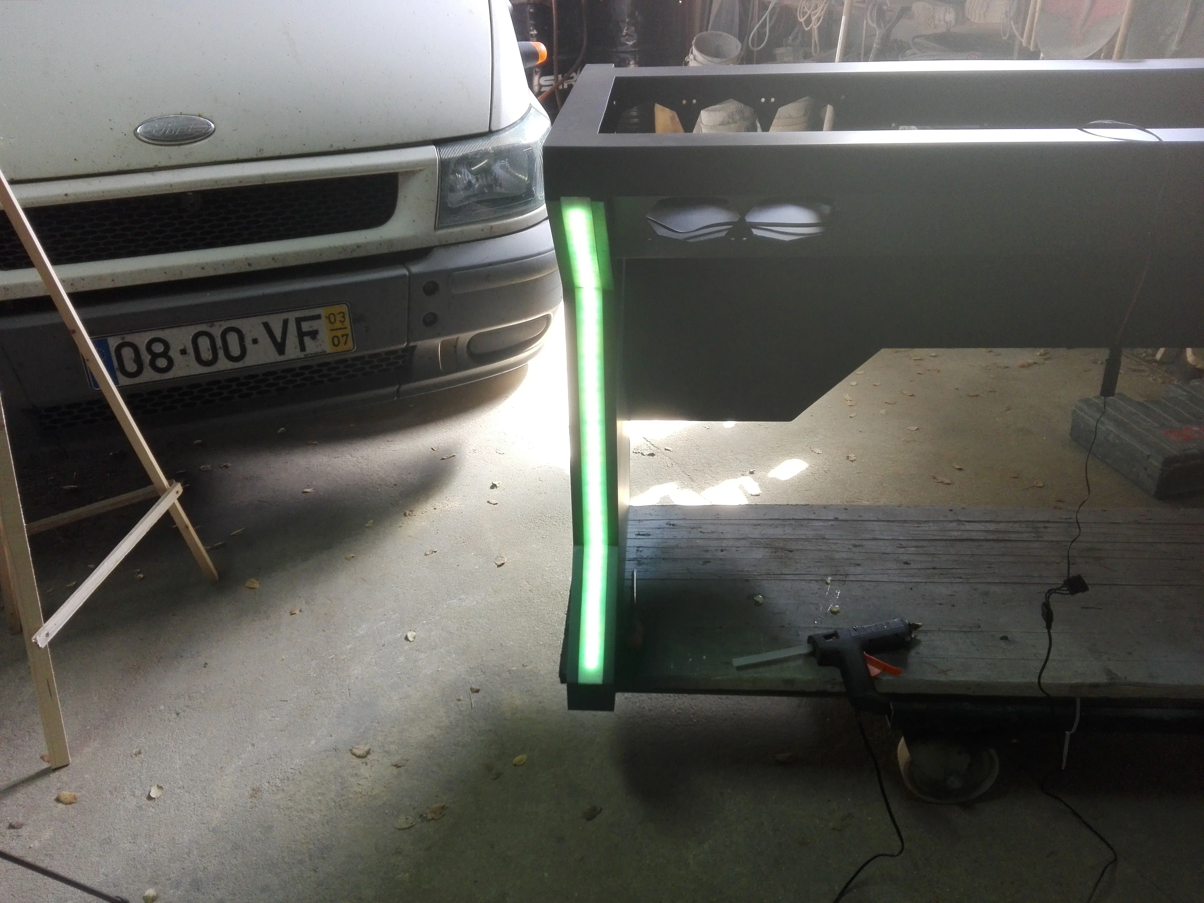

Then I moved to the legs, I dont know if some of you spot the idea in the beginning when I did the legs but I always wanted to make it like this, so you kinda have the computer connected to the desk (even more).

Desk first paint work (didnt took photos from the 2nd paint work):
Leg lights:

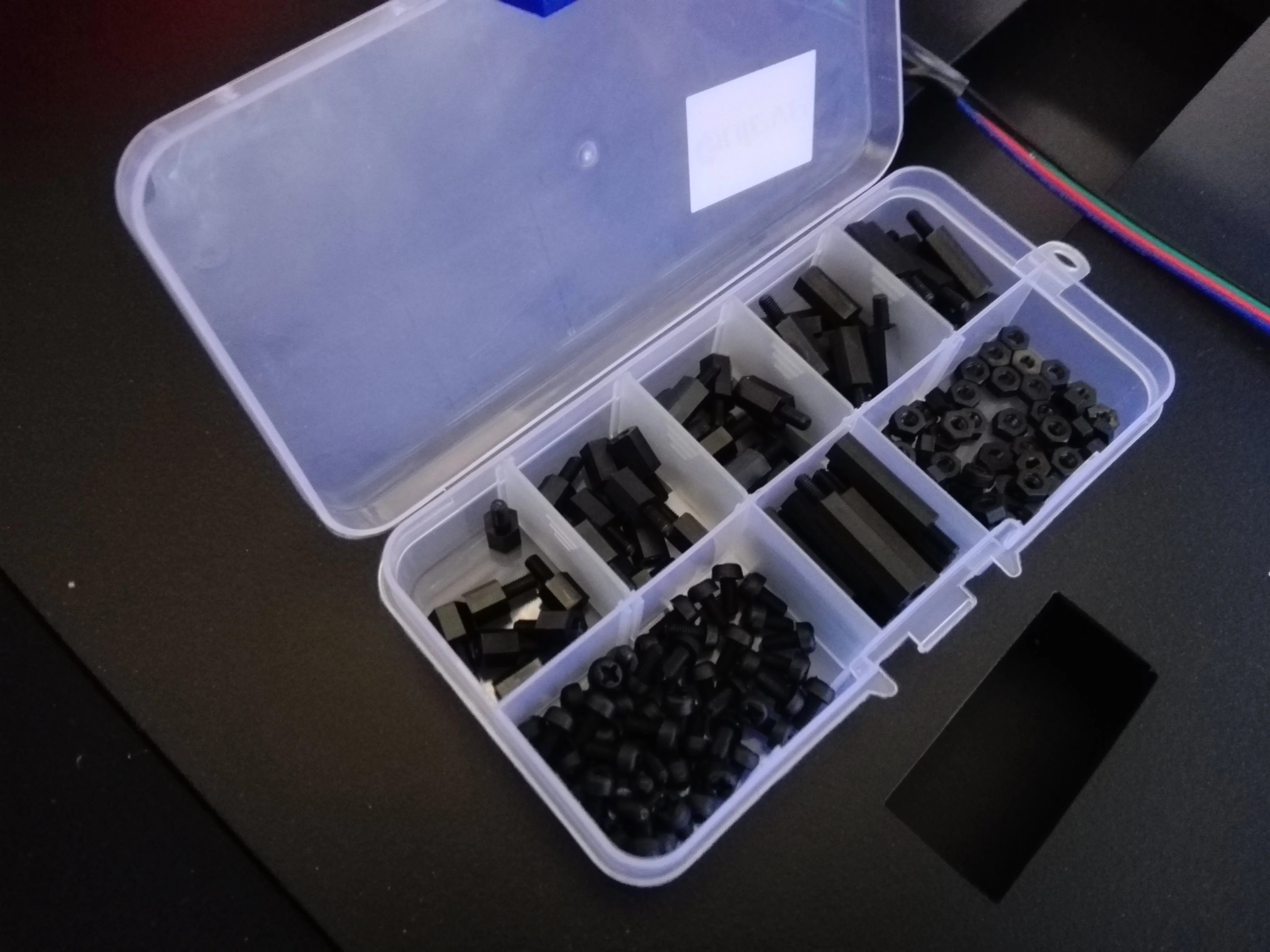

Some standoff I decide to buy:

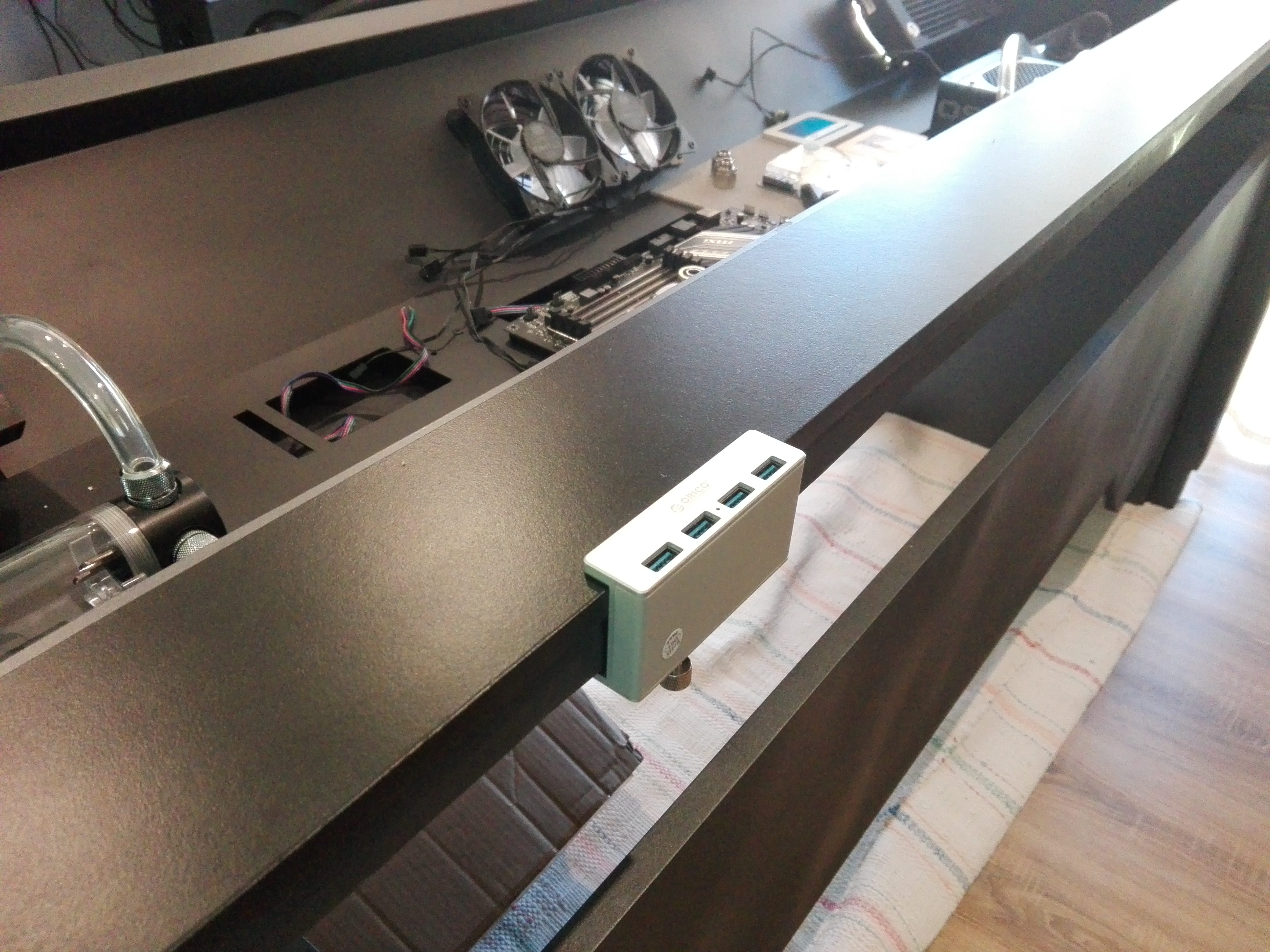

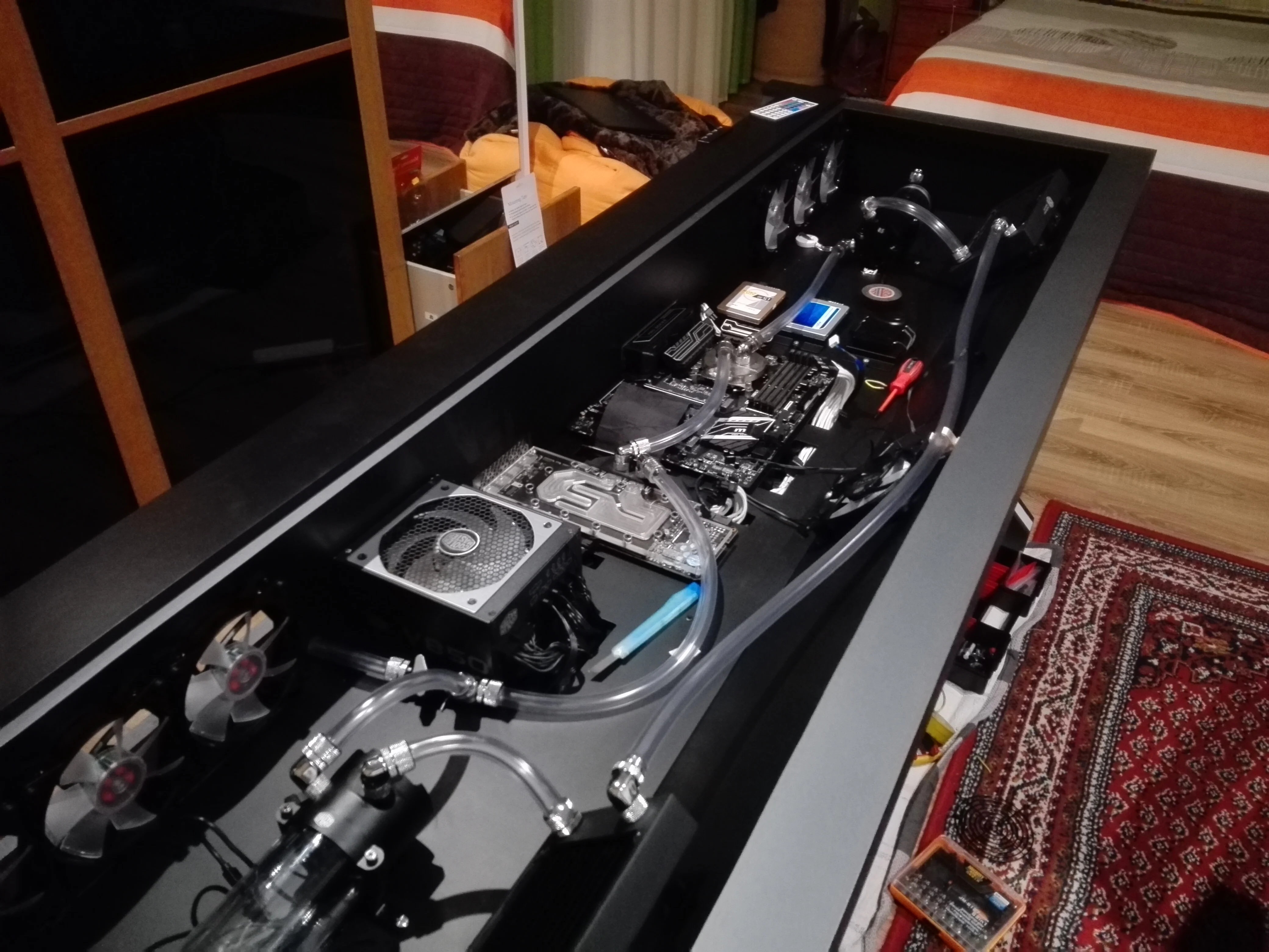

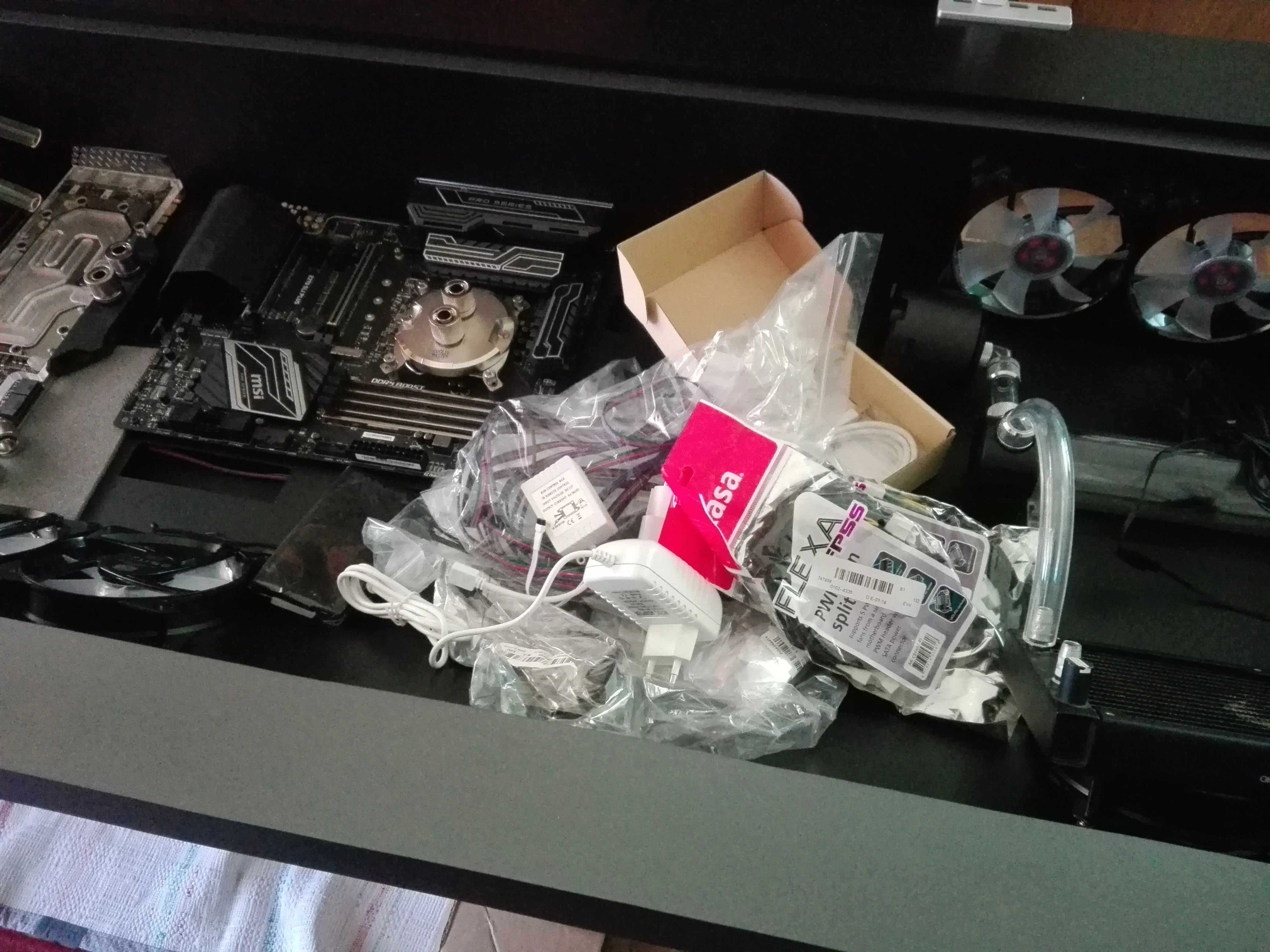

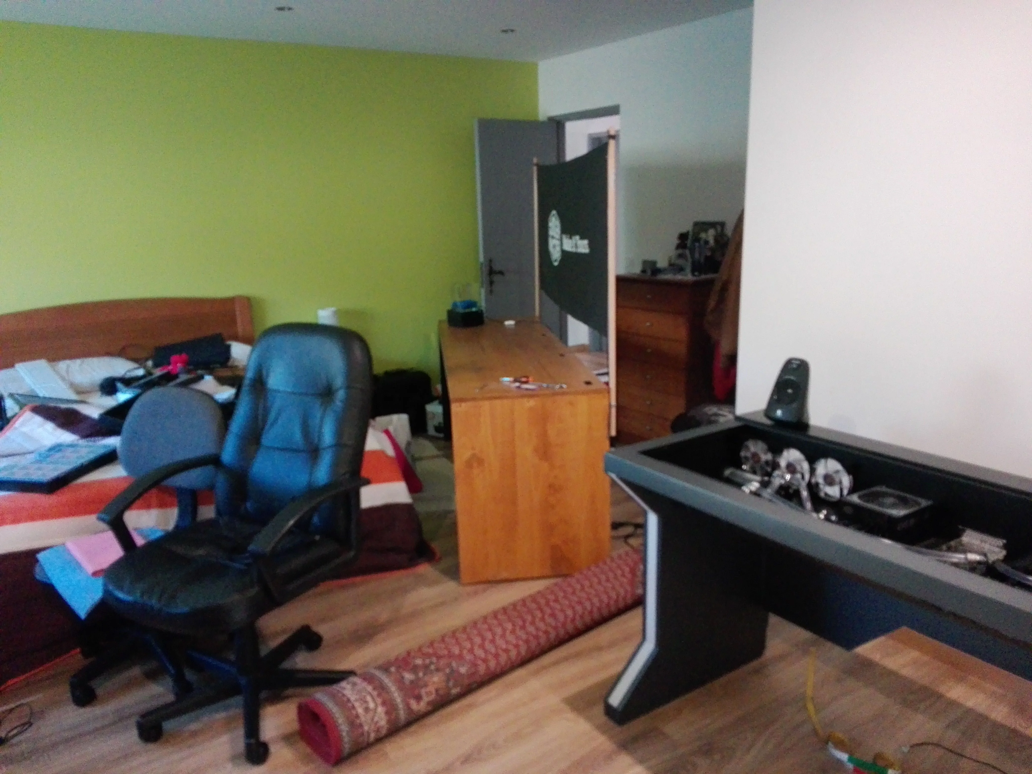

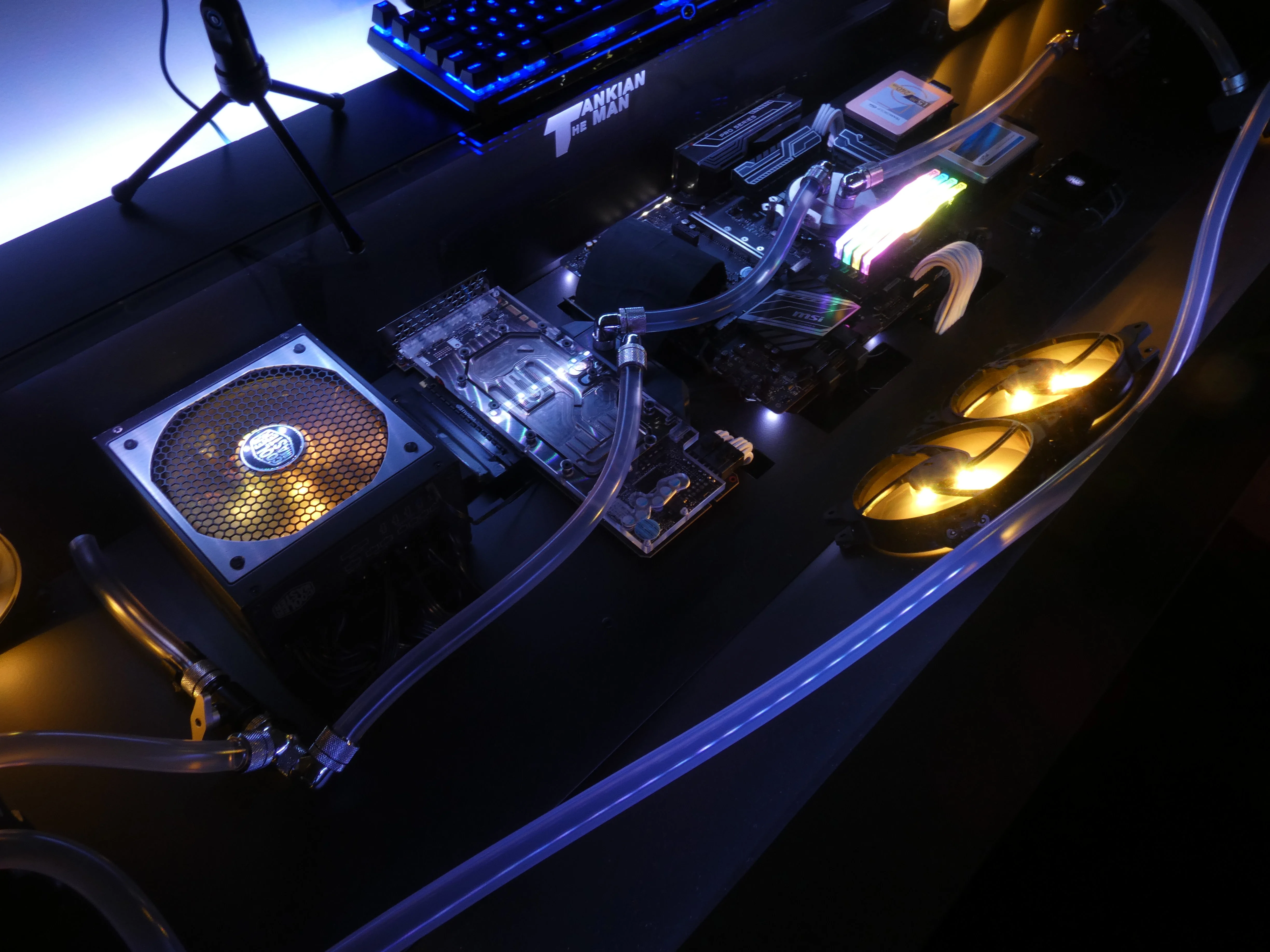

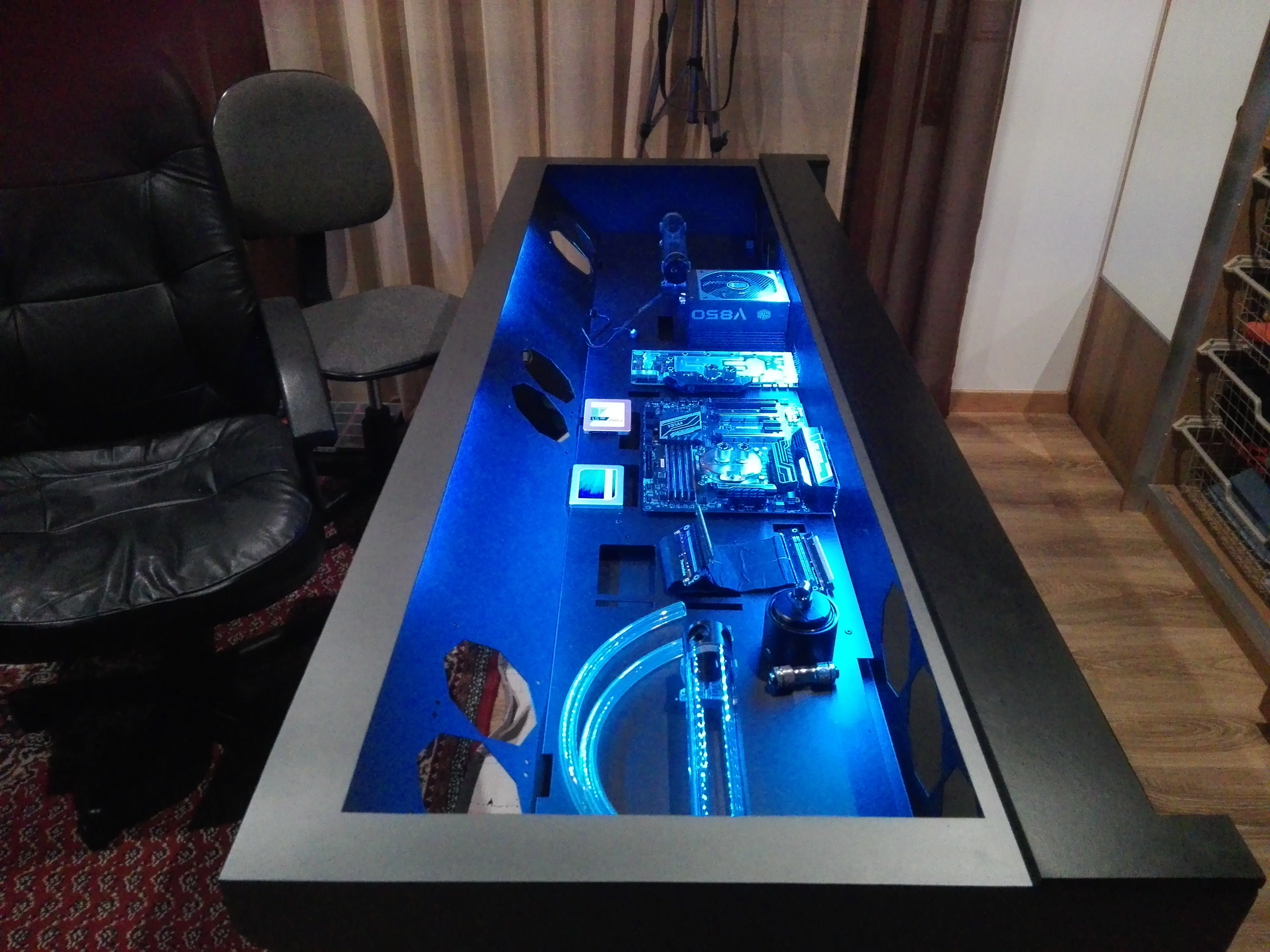

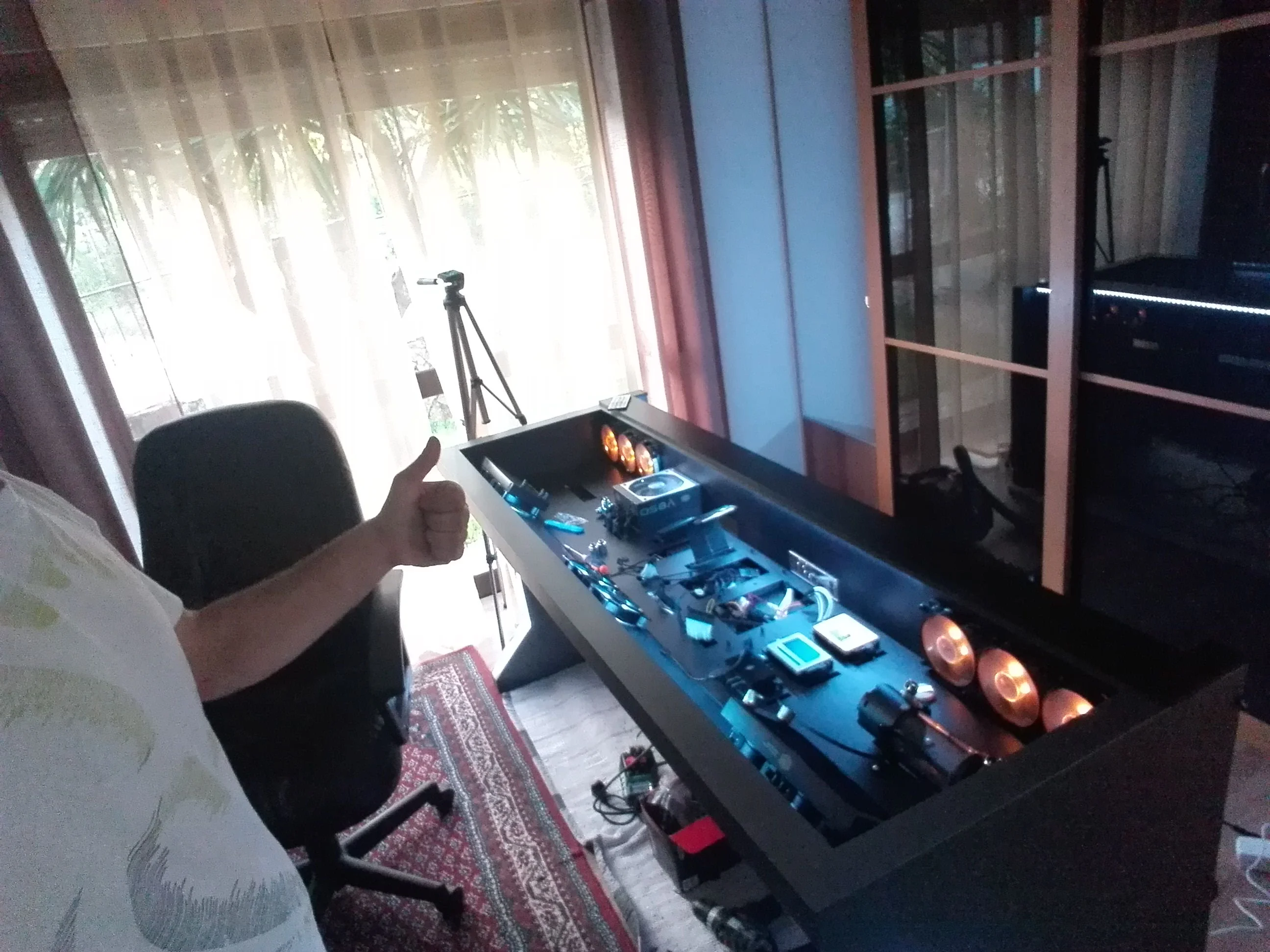

Hi everyone after 1 month of waiting for parts, solving costums insues I'm back and happy to announce the last build phase video.

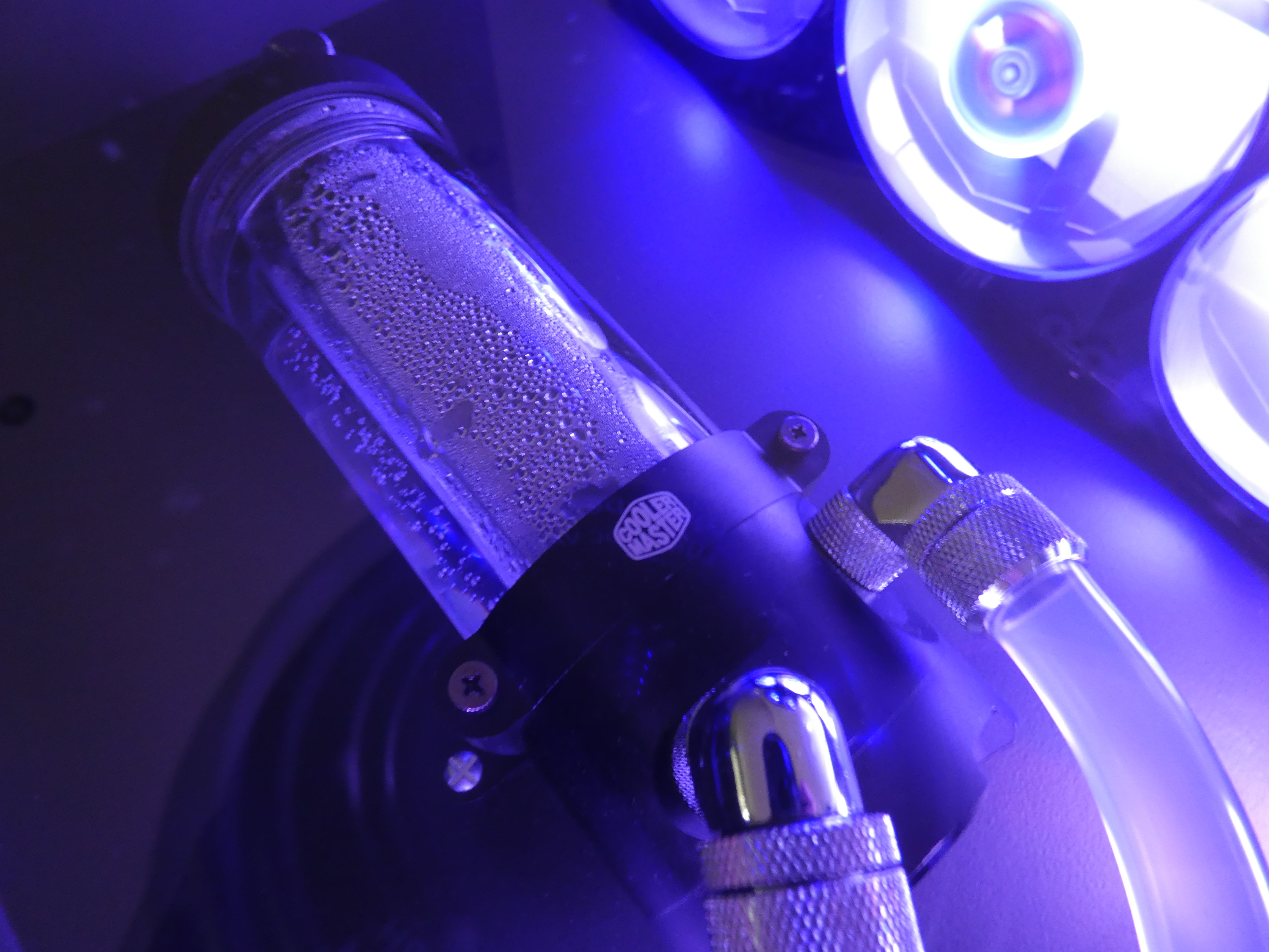

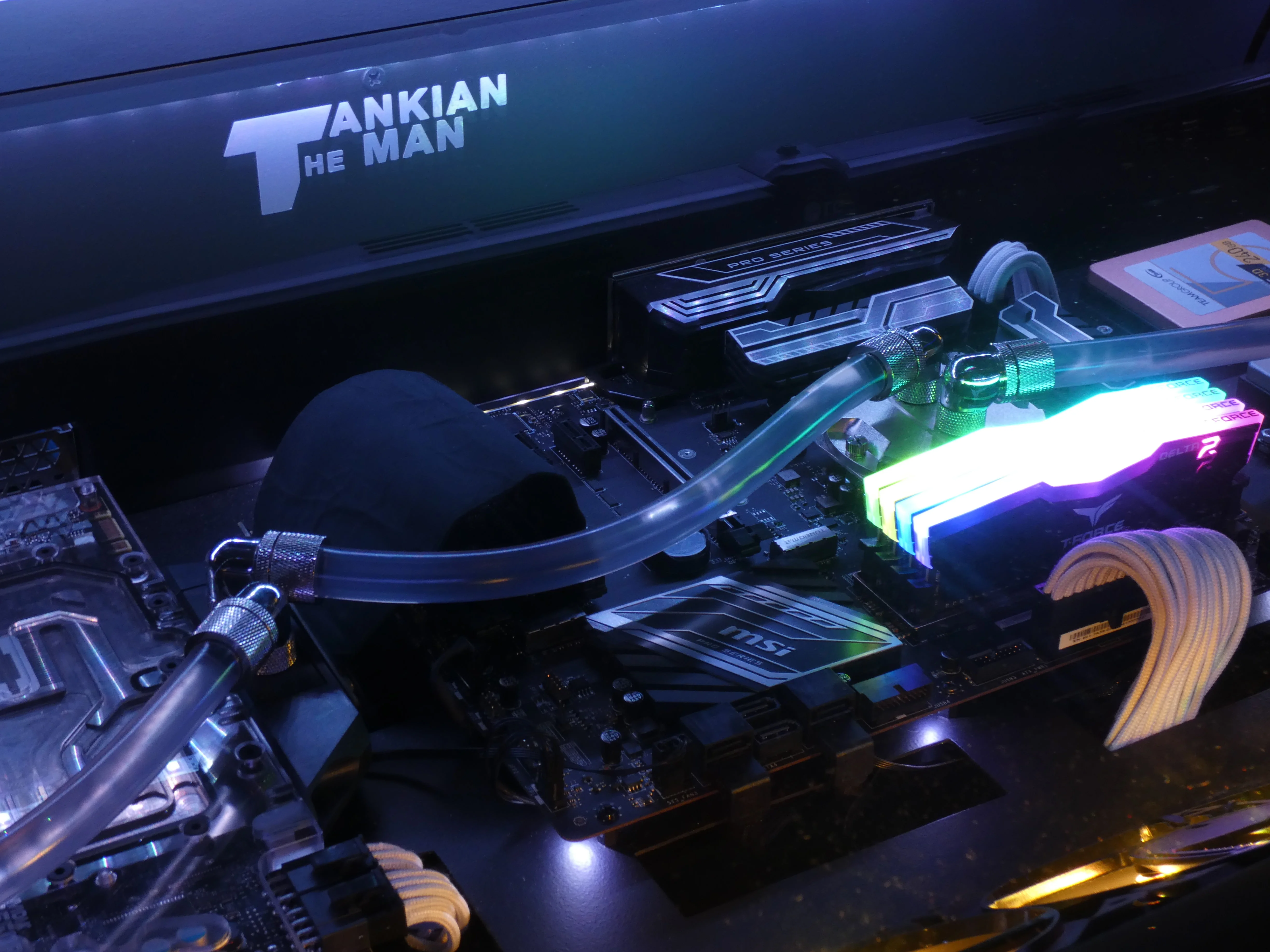

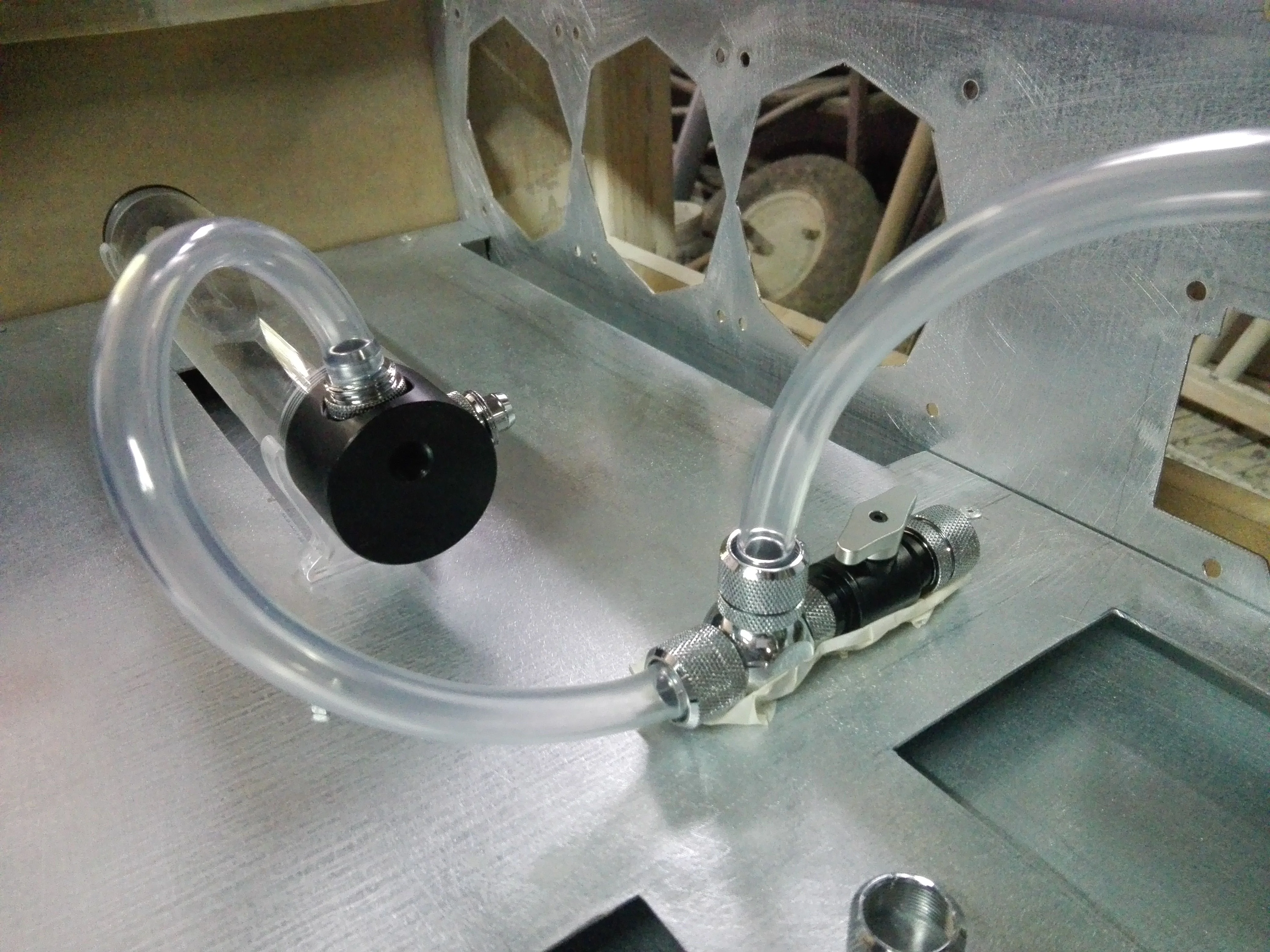

So basicly was about time to bring the desk inside my room and start mounting everything, weld the LED's needed and mounting the water cooling.
The water cooling will be in soft tube, mostly because I didnt found any sponsor, besides Cooler Master that decided to enter in this last month, and to moving for hard tube I needed to buy again new fittings that I already had bought, it was impossible for my wallet lol
So lets move to the video and photos:
Video:
Photos:
Back trim
When I got the desk inside
Started to mount everything
USB HUB
RGB LED's and 5 fan splitter
Welding and testing LED's
Testing with fans
Secound idea and final for the water cooling
First run in 1 month
Moving the "old" desk to place the new one
Sneak peak

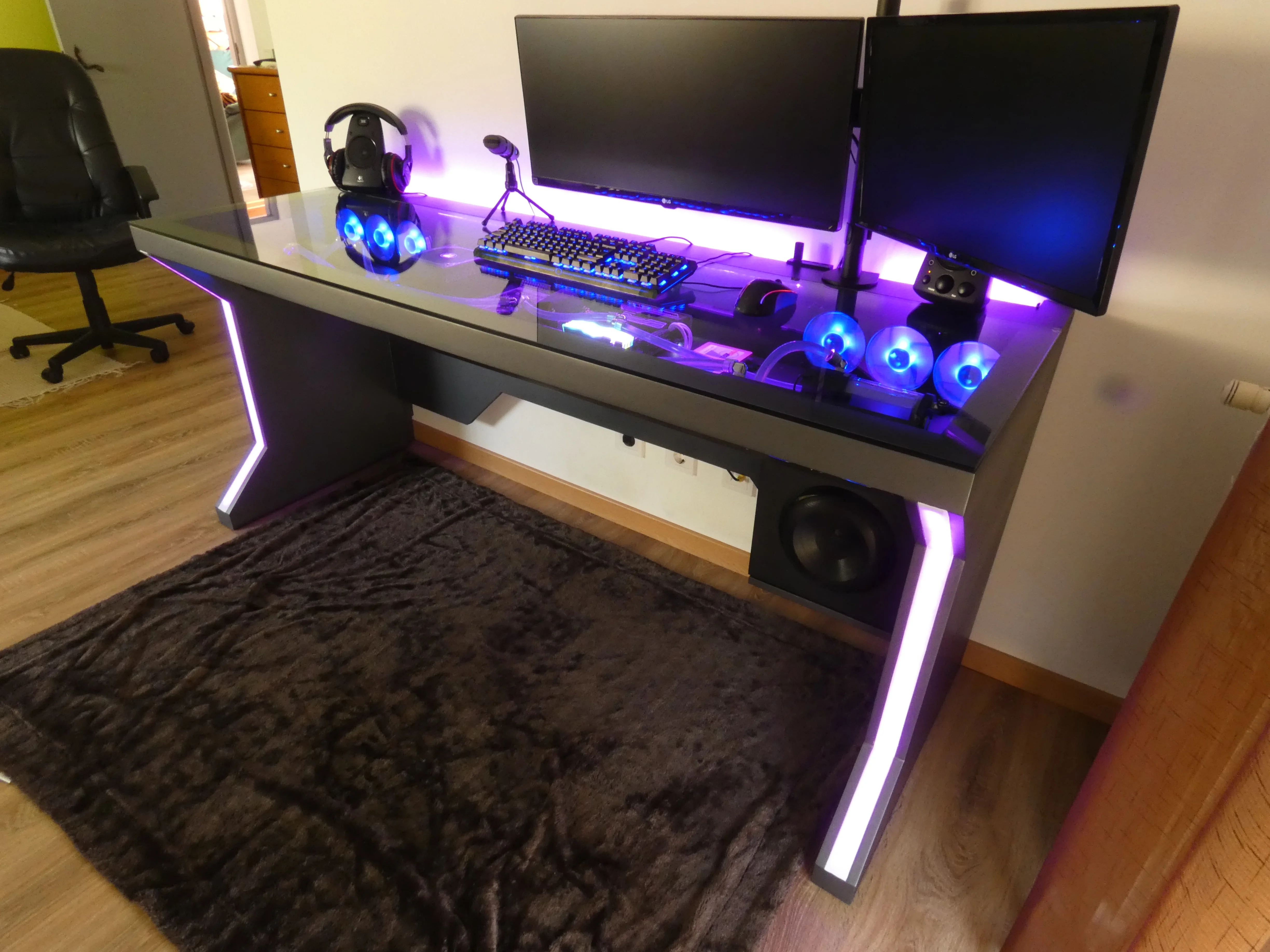

4 Oct 2017
34

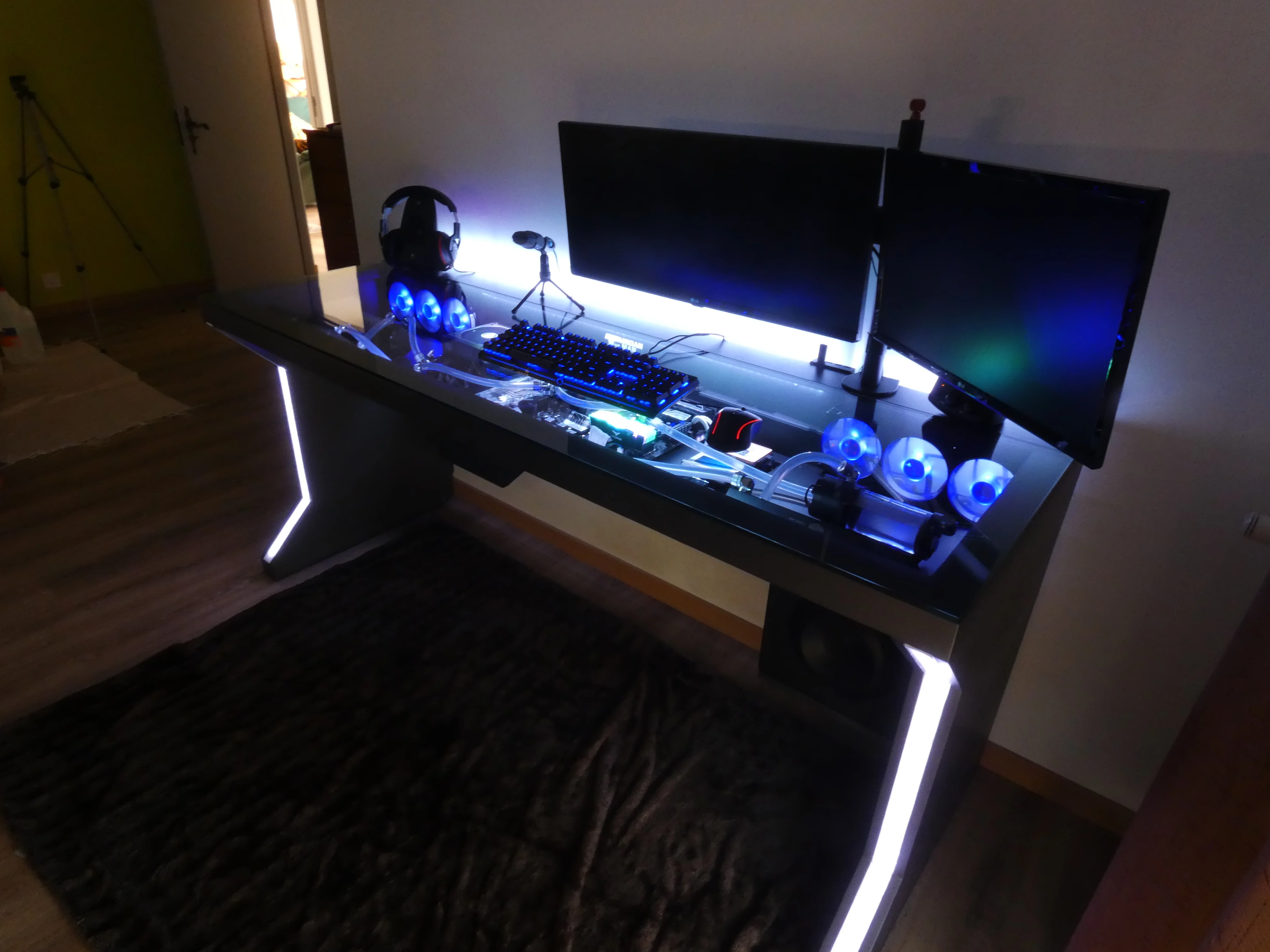

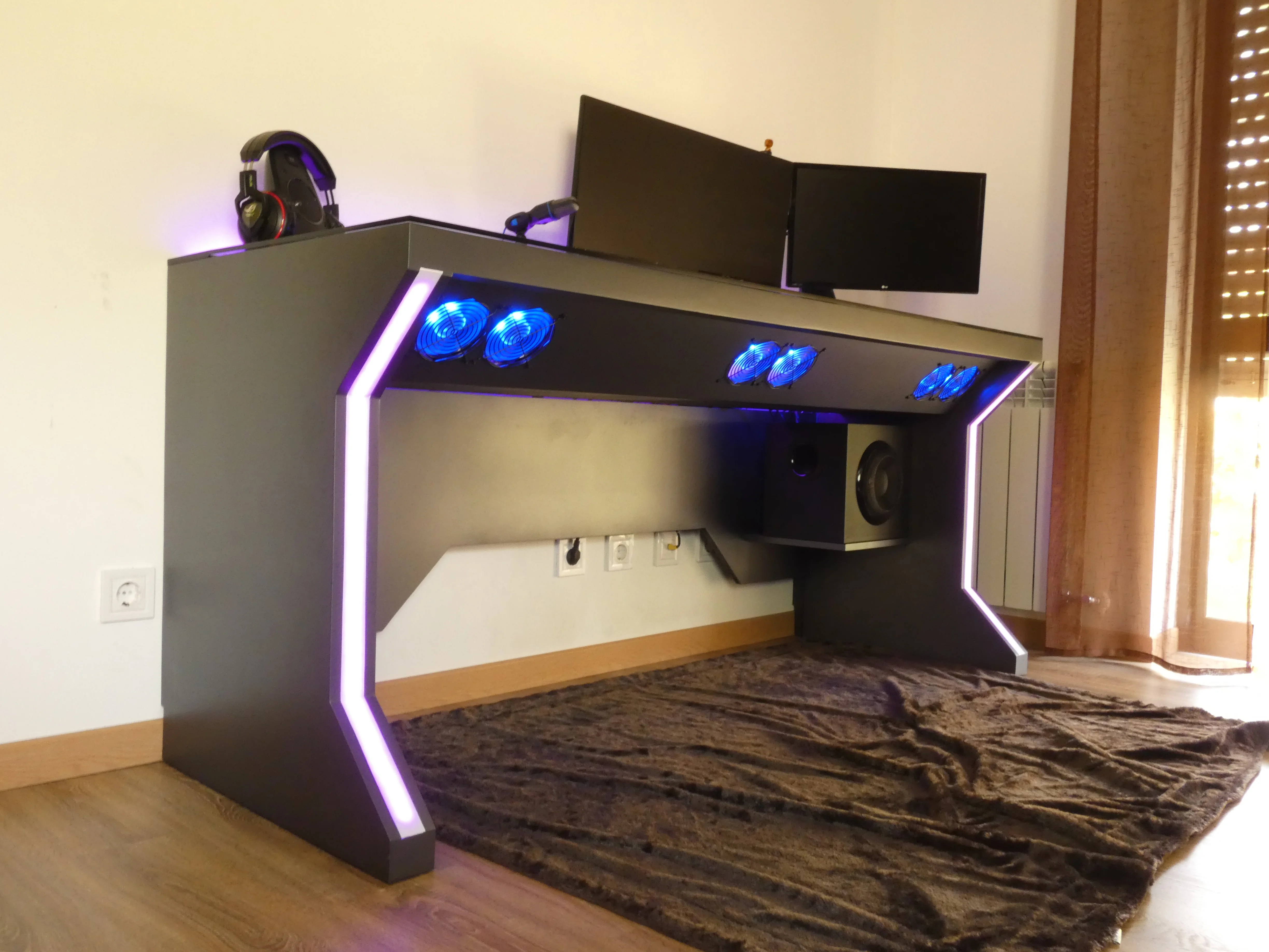

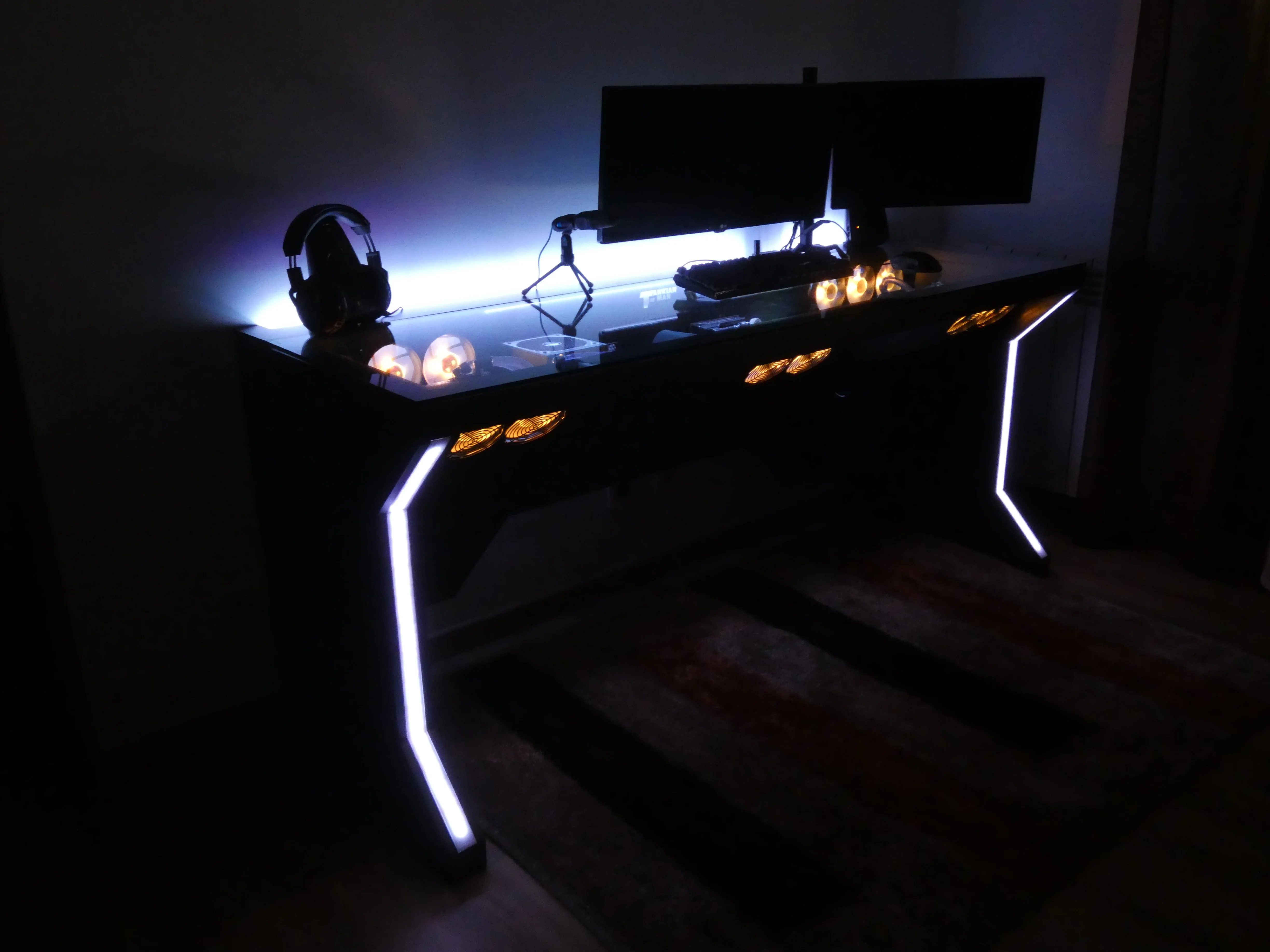

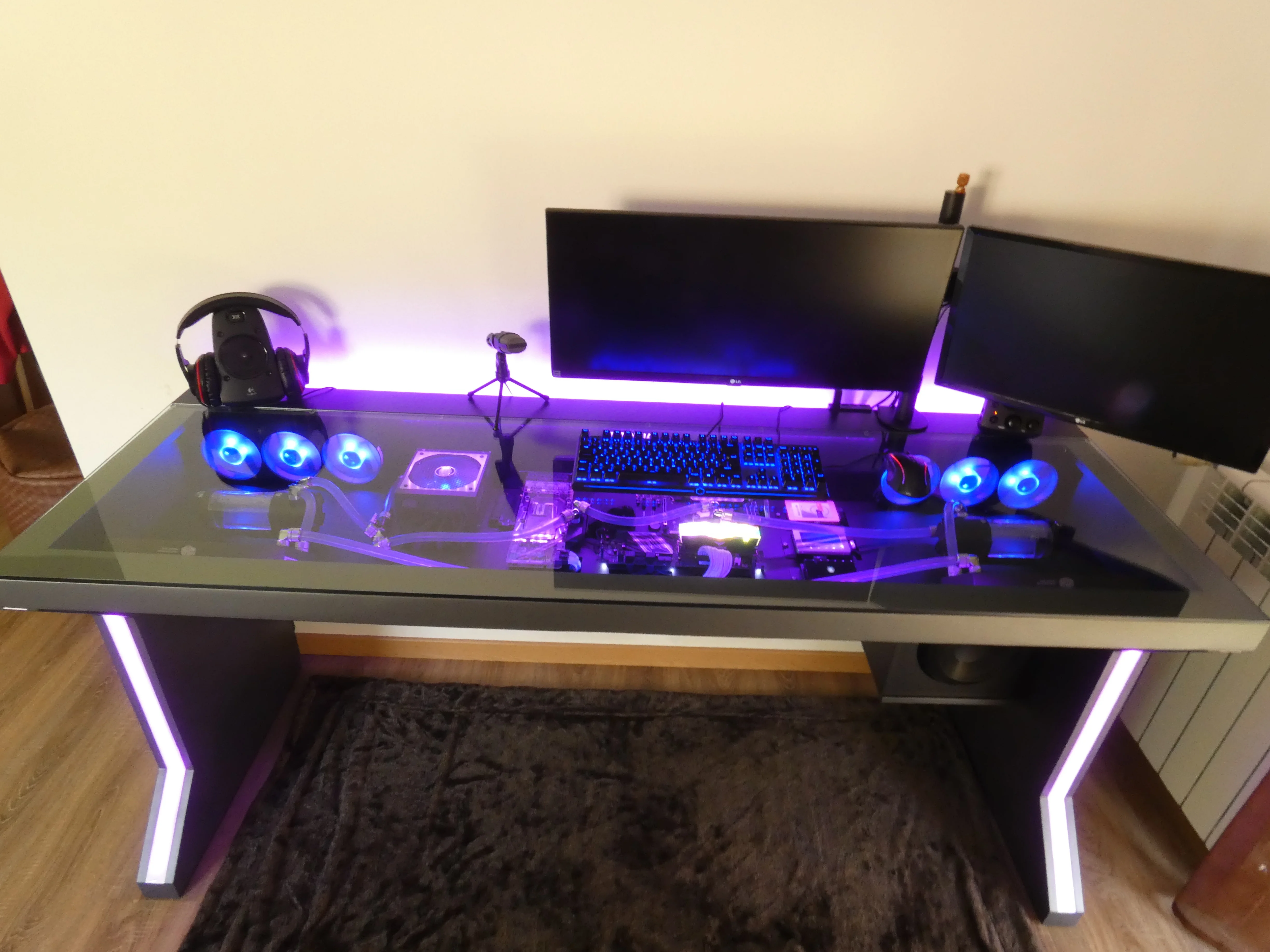

Hi everyone!

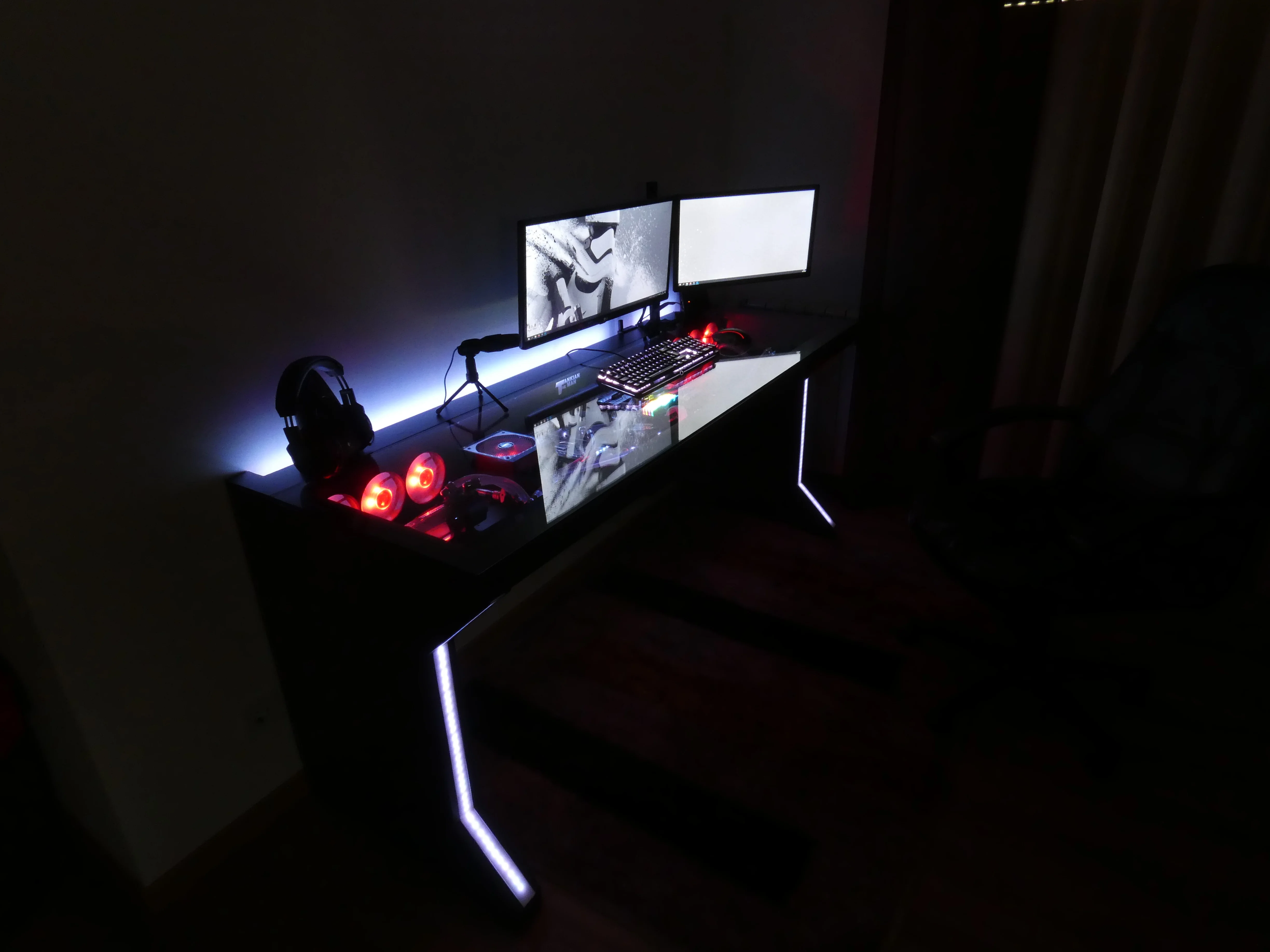

Happy to announce the final result about this project!
LETS GO!
Video:
Photos:
Many thanks to all overclockers uk members that in some way helped me with "good vibes" hope I match the expectations!
I'm curious to see what you guys have to say!
