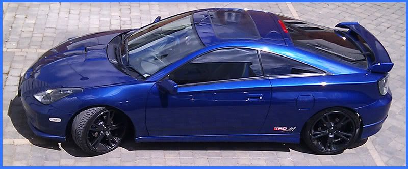

One of the most fun cars I've played in. Mines a TRD edition with a greddy supercharger with blitz exhaust, and it can shift. Its a bit on the loud side due to the weight stripping found in the TRD's, but the chargers whine soon takes over the drone
Cant say its the most comfortable ride though, but maybe standard suspension is a little more forgiving on the old speed bumps
