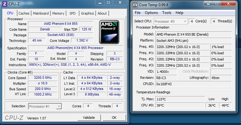

I bought this CPU and fitted it today using the stock cooler, and I'm quite concerned about the temperatures. I'm idling at round 40'c on stock speeds which I doubt it normal.
I plan on OCing the chip to 3.5-3.8Ghz, however I won't touch it on stock cooling. I am using an AM2+ board.

I swapped the cooler to the Akasa Revo today, but much like the reviews say, it's a piece of crap. I reattached the stock cooler with some AS5 and the temperatures are around the same as before, but I assume it will get better once it cures.
I just ordered the Cooler Master Hyper 212 and also a Coolermaster Scout case, so that should keep things nice and cool.
Just a quick update. I got my new cooler and case (Zalman Z9 PLUS) yesterday. I also overclocked my CPU to 3.5Ghz and I am running idle at 32'c with max of 49'c under load for 2 hours, so I'm pretty happy with that.

On mine it shows the CPU temps, which are exactly the same as what coretemp is showing. TMPIN0 is a couple of degress cooler, and TMPIN1 is around 13'c cooler. How can I know which is the correct one? I am more inclined to believe TMPIN0 is correct.
EDIT: I checked in the BIOS. Seems that TMPIN0 is the CPU and TMPIN1 is MoBo. CoreTemp is actually pretty spot-on, only being about 1'c off.
Sounds like TMPIN0 is correct. I guess the best way to check is to start a stress test and see which number shoots up.
You are lucky, I was worried that your real cpu temp would be much higher. My coretemp is consistently about 10*C lower than my actual cpu temp.
