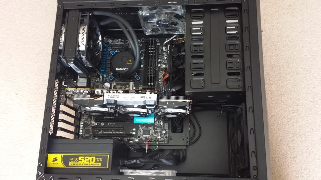

I'm running my 2500k under an Kuhler 620 also. 28-32 idle and 65-68 under prime95 at 4.6GHz. I'm running about 1.28v though, which helps with the temps!
Well my 620 might be under-performing then.
Not too fussed to be honest, i'm stripping out and re-building my system from the ground up soon. New PSU and motherboard in the post, custom W/C parts in my cupboard etc :D
Yea it's the antec 620 I got it 2 years ago .. But yea I run blend test and most it hits is 65c if that. Obv warmer days like the last couple of days little bit more but on average thats what it runs at under load
Can I be nosey and ask what fans you have on it, at what speed, and whether you have it pulling air into your case, or pushing air out? A tad worried that mine might be defective.
You're running 0.1v more than me though, which will make for some extra heat!
