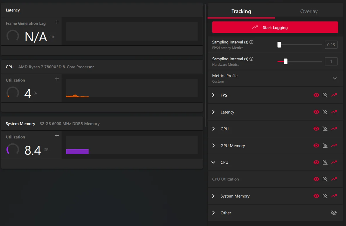

how come on the radeon software i can no longer see cpu temps etc only cpu utilisation????
Yeah I've lost most of the CPU overlay stats. I think the only one it shows now is CPU utilisation.

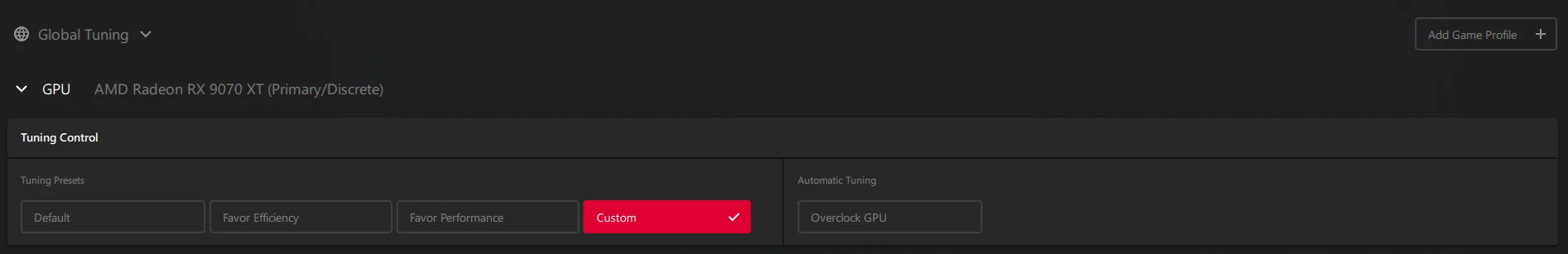

It's also missing CPU info completely from the tuning tab in the adrenalin software.
I've had missing CPU stats from the overlay for the last few driver iterations. Just shows CPU utilisation now

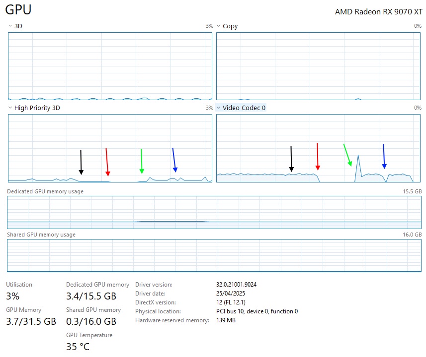

What browser are you using, does using a different browser with YouTube minimising/maximising give the same issue with the HDMI audio?
I observed the same as you, with the Video Codec usage, when minimising Edge. My audio was fine though as I'm not outputting to an AV AMP > TV.
Have you tried a DDU of the drivers and a fresh install?
Have you also done an SFC /scannow and a DISM /Online /Cleanup-Image /RestoreHealth to ensure windows integrity and install is OK?
Does removing the DP monitors (or one of them) have any impact on the HDMI audio?
Cheers post back with how you get on. Ahh I assumed Windows 11 as well. Probs should get off Windows 10 as it goes EOL in October. I know I'm in the minority when I say "Windows 11 is great" haha.Browser is Firefox.
Will try some others but my guess is they'll only make a difference if they keep the load up when minimised.
DDU, yes.
Was on the previous drivers with a 6700XT and the latest drivers came out the day I got the 9070XT.
Will try these when I get time.
Will try removing the DP monitors and try the Amp/TV as the primary and only monitor to see if it helps.
The only test I've done so far with the TV on is just having it as a third monitor (2160p@60Hz), hoping maybe that it sending a full video signal would help but it didn't.

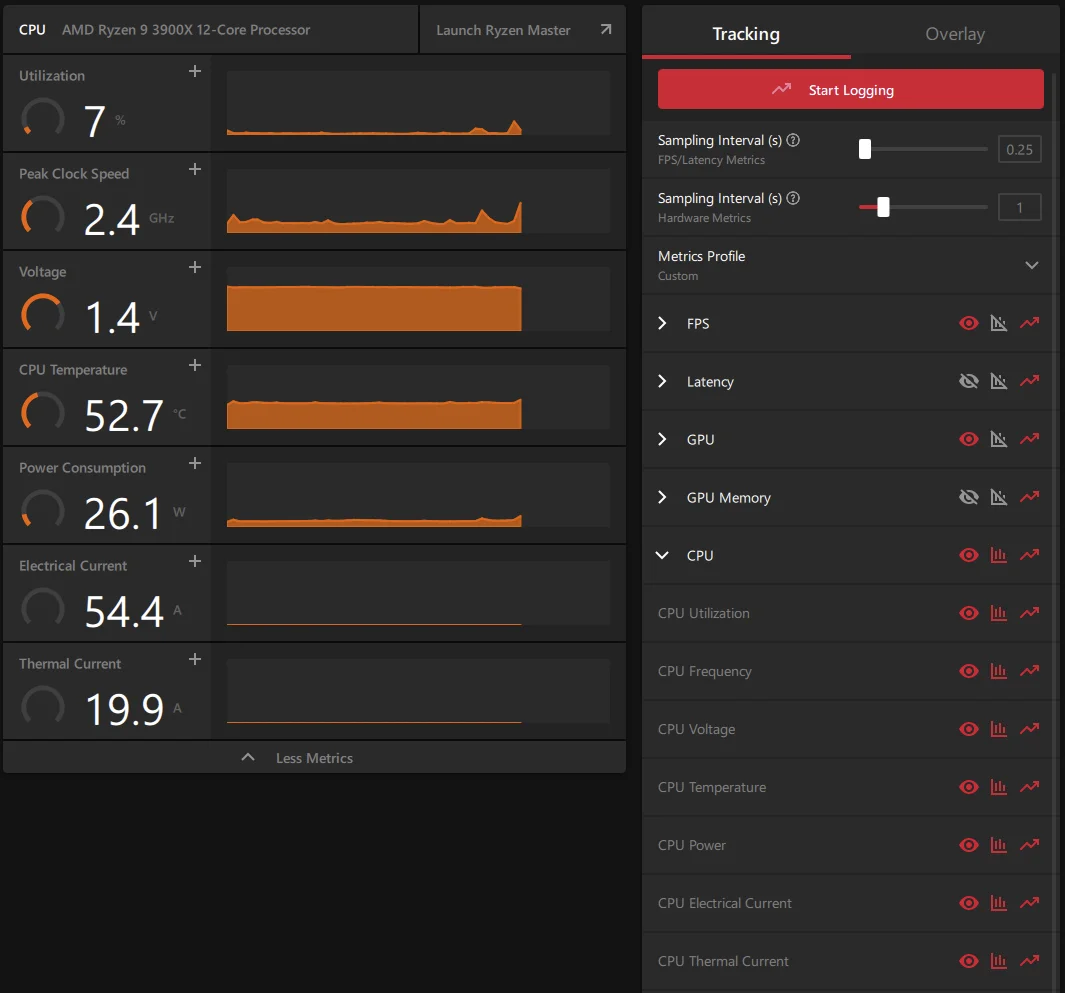

But honestly, can't say I've had any problems with it.Seems OK for me, or am I looking in the wrong places? Utilisation, Voltage, Temp and Power.
<snip>
Yep all i can get is cpu utilisationSeems OK for me, or am I looking in the wrong places? Utilisation, Voltage, Temp and Power.
EDIT: Did you expand "Additional Metrics"?
EDIT: Also, under Tracking have you selected the "eye" icon within the CPU section?
https://i.~ibb.co~/FcMD20y/Adrenaline-Metrics-1.jpg
https://i.~ibb.co~/qYSRKyYd/Adrenaline-Metrics-3.jpg
https://i.~ibb.co~/Q7hJs0M5/Adrenaline-Metrics-2.jpg
Yep chipset and gpu drivers upto date don't use ryzen master tried it a while ago made my pc unstable
Only just lost the cpu monitoring after a fresh install of window's
So strange.All that was there in the previous driver I was using, just seems to have disappeared for the latest ones -
Used to show under Tuning tab, above GPU too, but that's missing too.

Completely unplugged all DP cables from the back of the card and powered up with just the Amp/TV connected via HDMI.
Same issue.
Interestingly the image is fine, audio still bugs out but image is stable.
2160p@60Hz + HDR being more than enough going over the cable to keep the connection alive and show that generally my set up is fine.
TV never shows signs of the HDMI connection dropping, no usual symptoms of flashing screens OSD input pop ups etc.
Amp never shows the HDMI connection dropping or PCM disconnecting, just the speakers flashing on and off.
