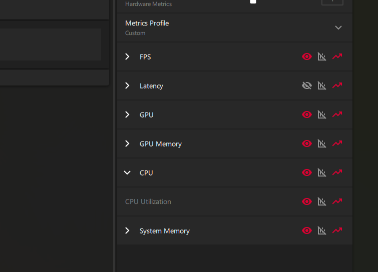

In the preview driver all CPU stats apart from utilisation was missing from the overlay. Hoped they would be back in the release version but nope. All power stats, frequency and temp are gone
This could be an intermittent, install related issue with the included Ryzen Master SDK. You might have some luck manually removing this module via 'Programs and Features' and trying again. There's a chance you have multiple copies (older and newer) installed on the system. If you can identify the older copy, try removing it.@AMD_Vik
Any idea why all the CPU stats from the overlay other than utilisation have disappeared for me in the preview and latest driver? Back on 23.12.1 drivers and cpu temp, frequency and all power stats are back again.
