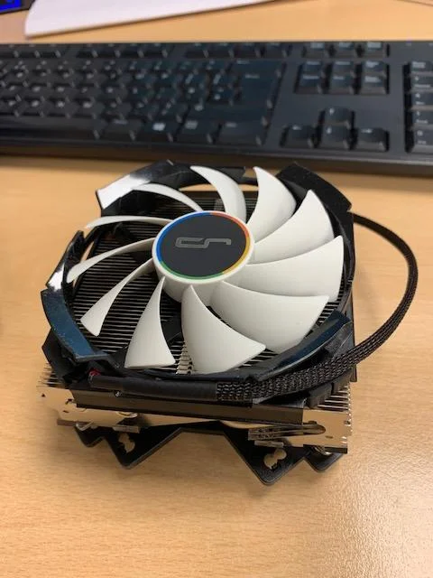

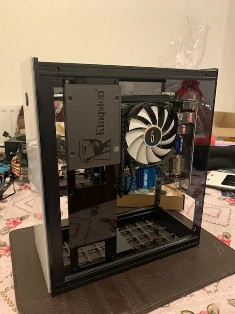

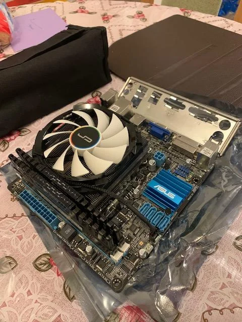

Cryorig C7 has arrived! Really love this thing, its small, compact and will cool the 3570k no problem provided im no doing any overclocking which i won't be with a H61 board.
The case and SSD has also arrived, will get some snaps of those and the build process of the case later tonight!

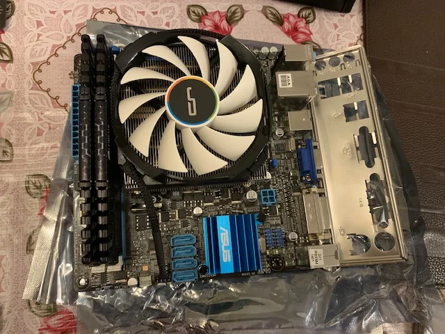

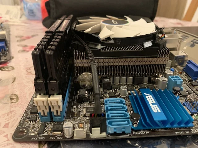

Well hit my first roadblock!
assembled the parts on a make shift test bed just to make sure it posts… and no post! Fans spin as they should but there’s nothing on the screen. Took the gpu out and same, no post.
Went through all the usual tests, removing ram, reseating cpu and nada. Even went as far as no heatsink and no ram and put my finger on the cpu ihs. It heats up so i know its working.
its dawned on me that the seller of this board might not have updated the cpu to take 3rd gen 3570k. I have the exact same board at work so will give that a go tomorrow.

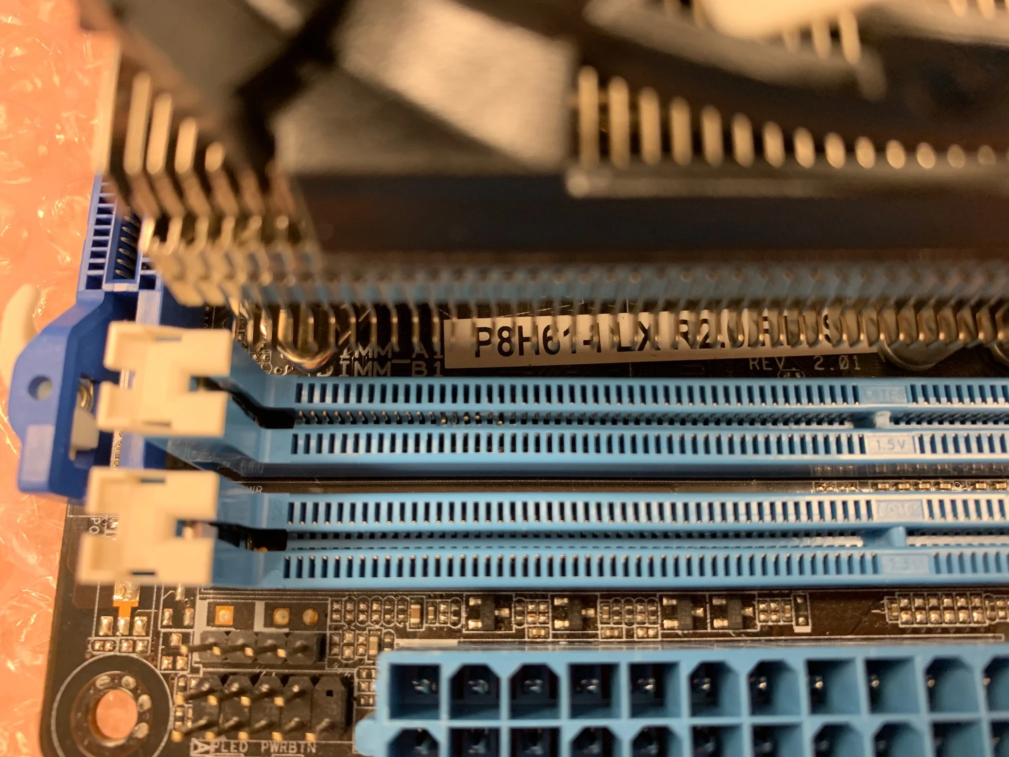

Found my issue.... i had bad lighting last night so didn't spot it but this morning under the spot light... BAM! FML!
Off to try and return it without the seller blaming i did it.. can't imagine just installing memory could do this?
After finding this out i tried running it with just the right dimm installed and it posted so defo the left dimm causing the issue.

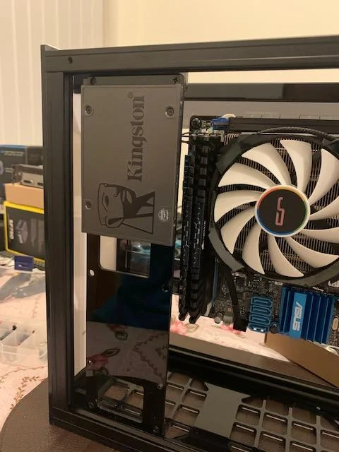

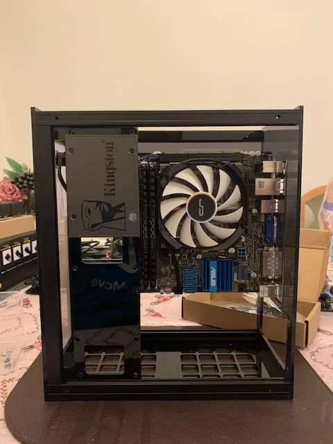

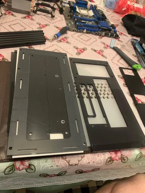

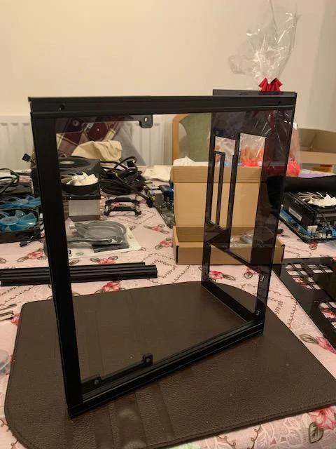

A few build pics:

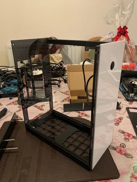

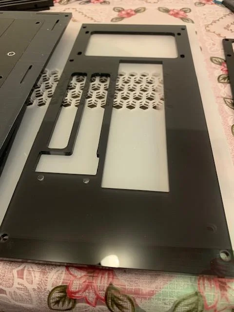

The GEEEK A40 V3.1 comes flat packed! It took a good 30 mins to peel all the protective film off the acrylic. I don't mind a good peel but this was painful :cry:.
Board assembled prior to me finding out i had issues with no post
The aluminium frame, it's not very sturdy as its only held together by a couple of screws. The main rigidity comes from the actual motherboard being mounted to it.

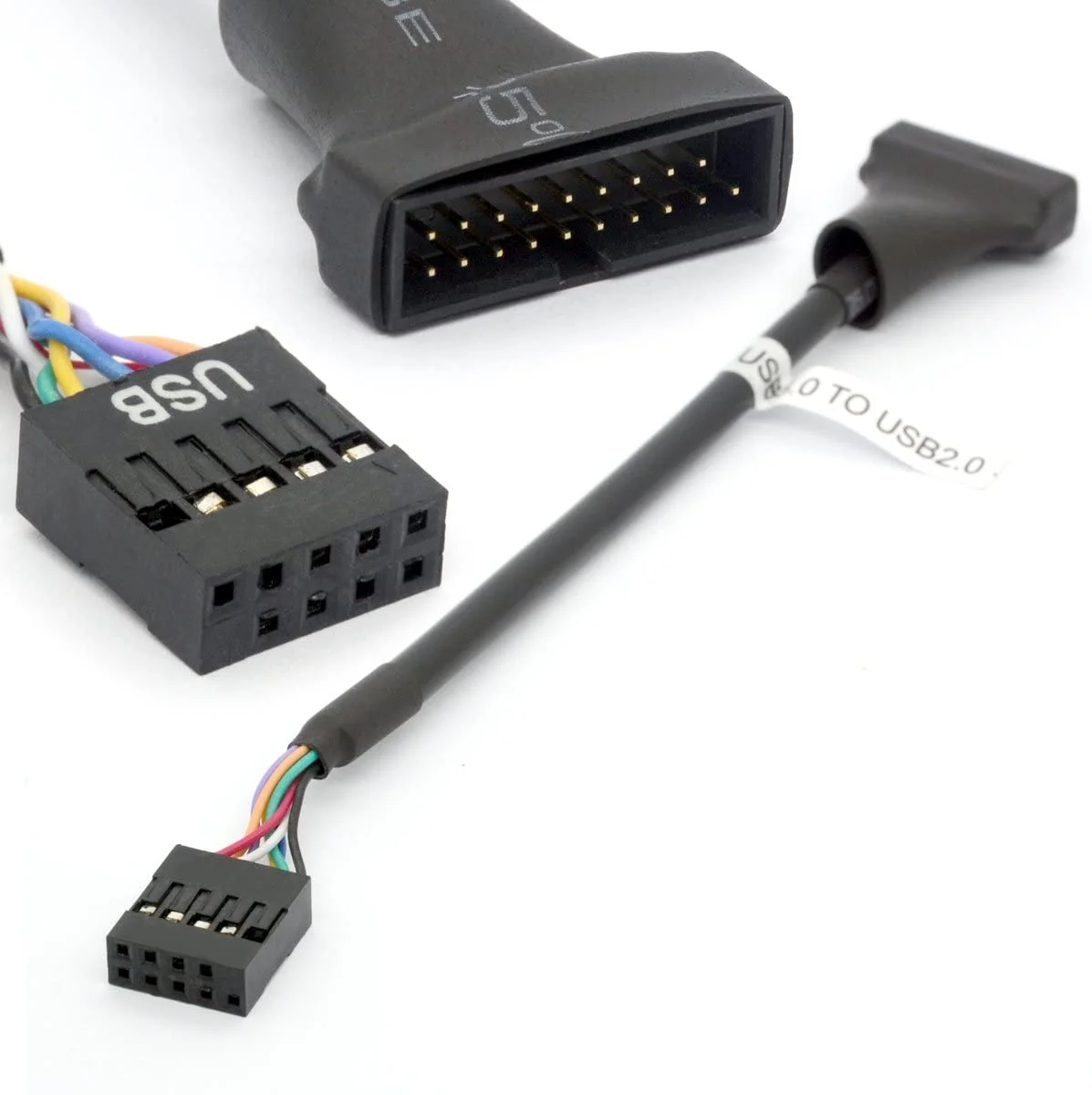

The board only has USB 2.0 headers but the case uses USB 3.0 ports. Can i use one of these to get the usb 3.0 ports to work in 2.0 mode?
Case comes with one of these essentially:
Can i plug the above into this and then plug that into the motherboard usb 2.0 header?
Another thing i remembered:
Yes you can but the usb 3 will only run as usb 2.

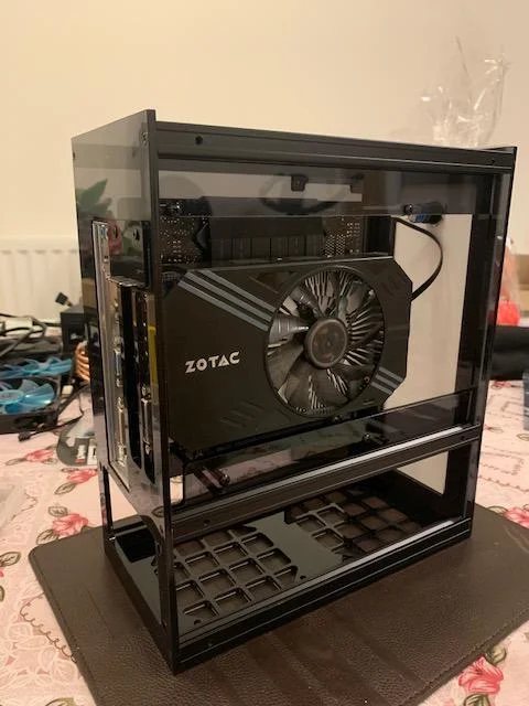

Some updates on the SFF build!
So last night after work, i decided to have a look on facebook market to see what's about. Spotted 2 things i wanted and ended up travelling upto Wakefield to collect a Barrow cpu/res/block combo which then lead me to somewhere else further up wakefield to collect a rather cheap Jonsplus i100 Pro case in black! I got both items at an absolute steal, spending less than a £100 for both items!
The case had a few scratches but nothing a sharpie can't fix and its barely noticeable.
So where do we go from here?? Well the SFF build is now getting a bit larger, i'll be returning the GEEEK case and using the Jonsplus i100 instead and likewise i'll now be watercooling the 3570k on a 360 rad with the Barrow block combo so i don't have to use a res (though if i can find one for cheap i may still use one for easy filling). I have a ton of old EK 13/10 fittings back from 2012 from a EK LT kit that i'll be reusing with this build, finally found use for them :cry:.
I've ordered the following from OCUK today as i'm short on some fittings:
  • 90 degree rotaries
  • 13/10 clear tubing
  • inline xspc filter
  • Noctua FC controller as the board is very short on fan headers.
Moving forward i want to sort the noise issue with the 1060 gpu, the fan is super noisy even at 40% fan speed (which is its lowest setting). The Zotac mini shares the same cooler as the AMP! edition card but trying to find a cooler or a dead card so i can salvage the cooler is proving difficult. Alternatively i could watercool the card but there is no full size block available, a universal block might do but again finding one that actually fits properly could be a headache.
With more room available in this case now i might look at getting a Kraken G12 with an AIO pump but it would mean mounting it with the rad at the bottom which is not ideal.
If anyone had any better ideas do let me know.
Pictures to come later!
