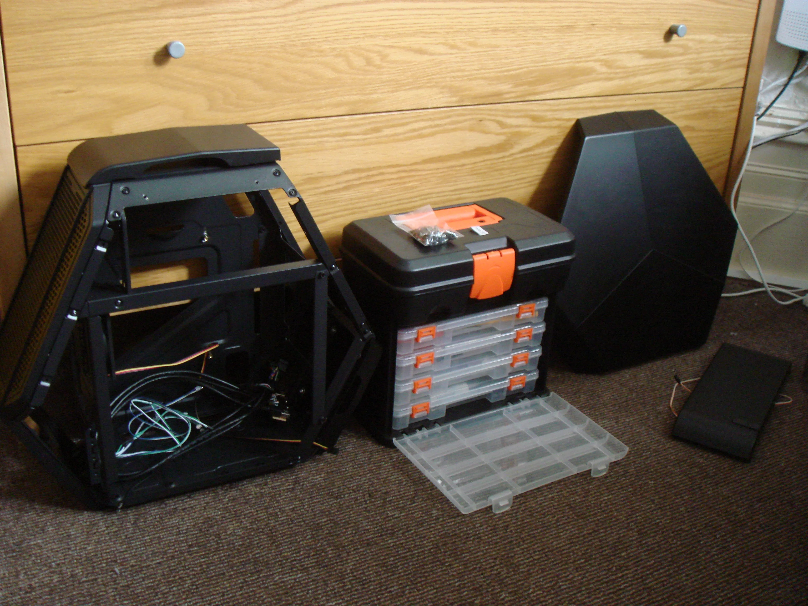

First job - rip it all apart. Yes.

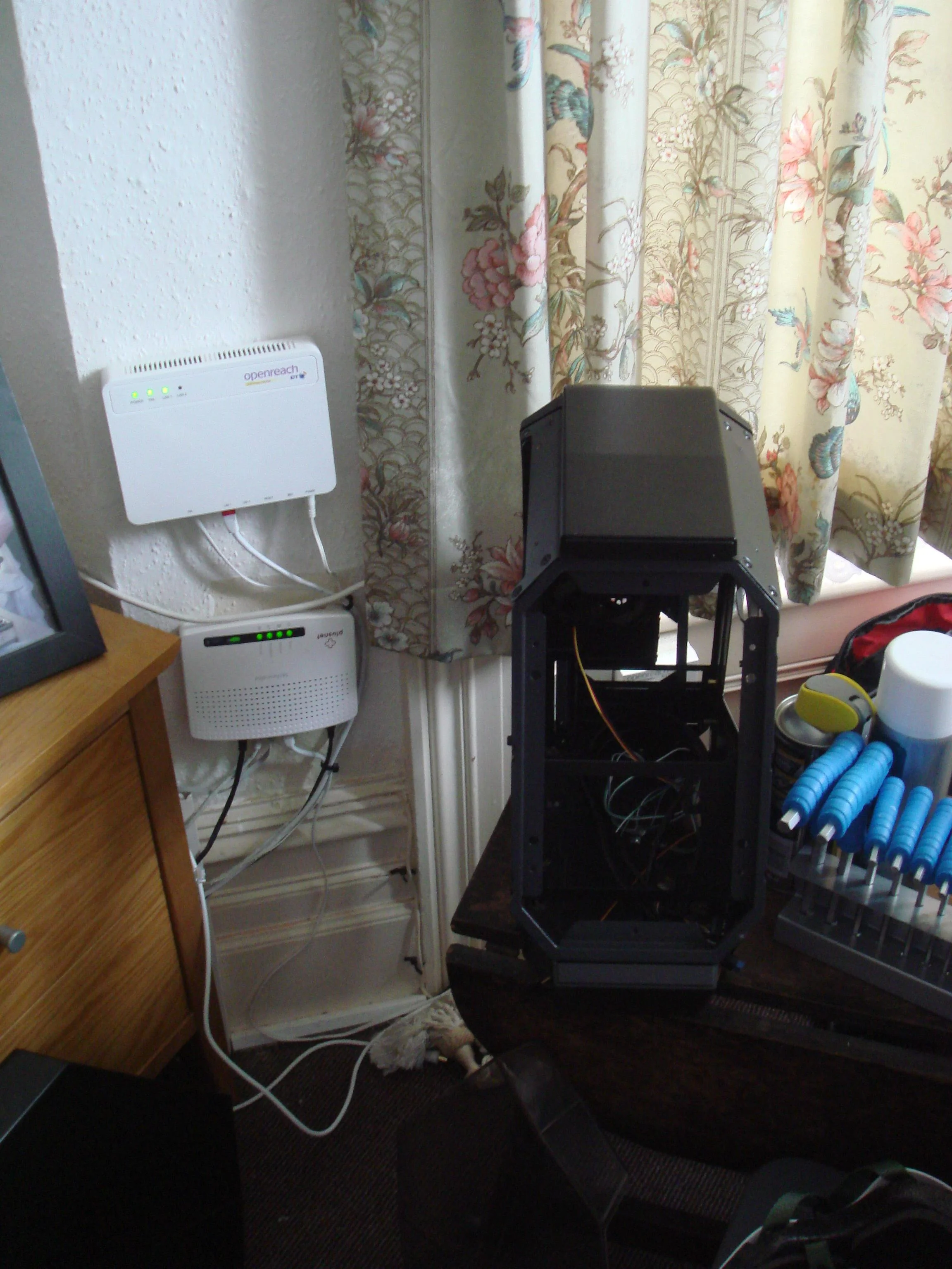

An idea of how compact it is, where it will live when it is operational.
It shall live on the floor below the router and modem (and incoming switch).

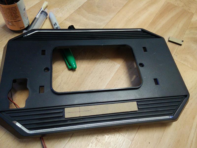

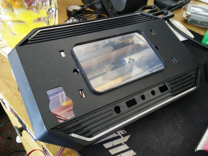

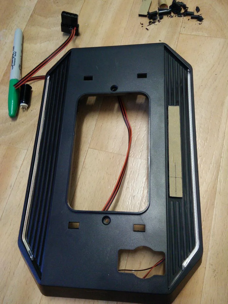

The main idea is to basically gut it (done) then make a cover panel for where the USB ports etc all lived and fit a 8mm latching switch. Then gut and rewire a ATX PSU to run the NAS and the cooling I have in mind. Oh yeah, and also the case lights which are really cool and chase around the front panel.

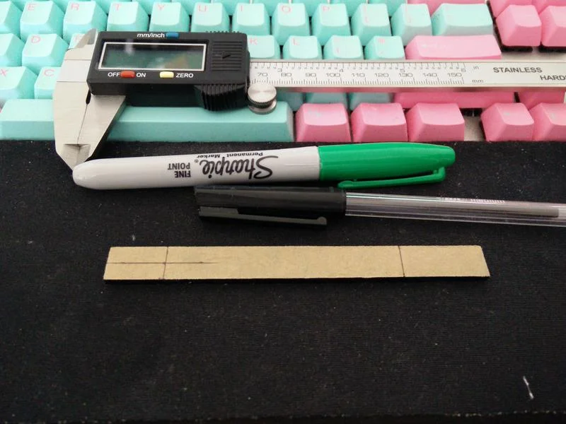

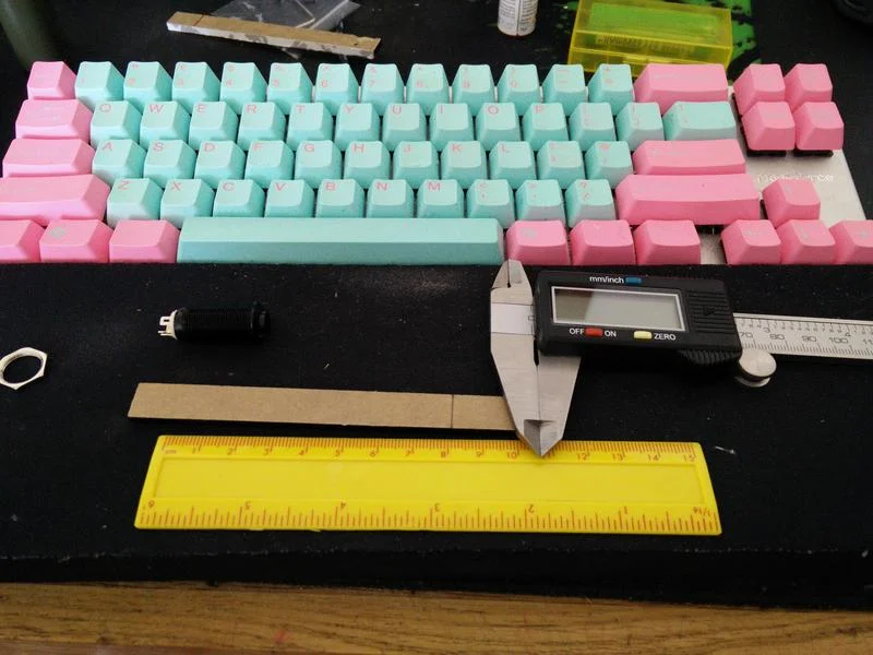

Modding has begun. First I got some tools and a piece of acrylic I cut to width a couple of days back.
Marked it so I could cut it to length and the centre point of the hole.

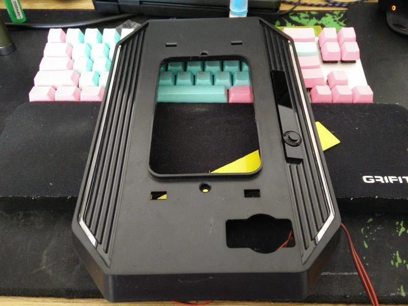

Lower front panel.
Cut to length.
Plastic weld.
And a short while later.
