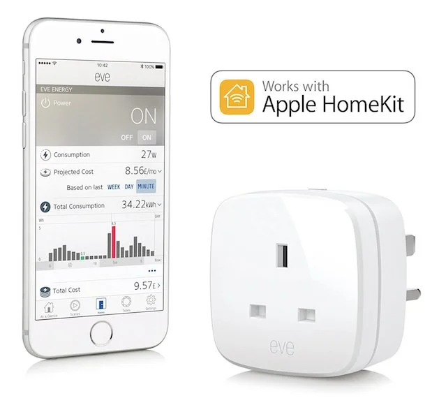

Elgato Eve: https://www.elgato.com/en/eve
Elgato have recently released the first HomeKit smart power plug for the UK.

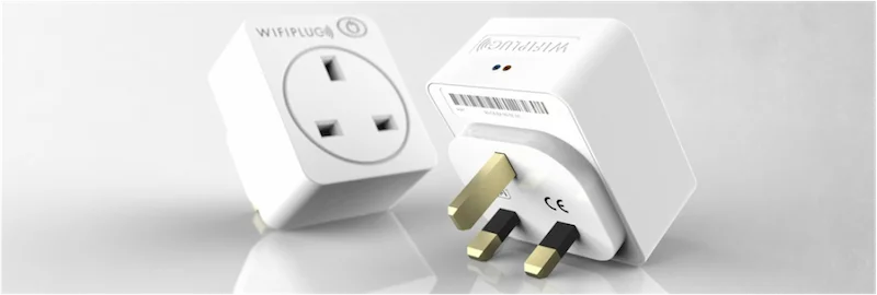

Wifiplug - http://www.wifiplug.co.uk/homekit.html
UK company who have developed a range of Smart Plugs and Light Switches that operate over Wifi. They have added support for IFTTT and are just completing adding support for Amazon Echo, and are now taking Pre-Orders for their Smart Plug with HomeKit support.
They say it the HomeKit plug will be fully cross compatible with their other Non-HomeKit products, other plugs and light switches allowing you to use their entire product range via the Home app.
