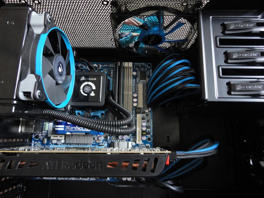

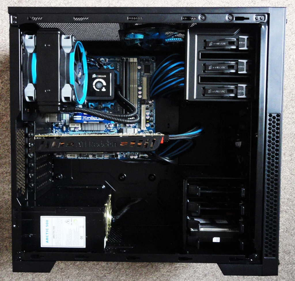

My now completed build (I think)
My first attempt at cabling with the corsair individual braided cables may well redo them have good temps with the H100 I have 2x SP120 Corsair performance fans in the roof sucking thru the radiator.
600t/IMG]
[IMG]600t back
My attempt at cable management in the back.
Not bad Never used those corsair braided cables but Once you've built in as many 600T's as I have you do find really handy routes for the cables.
Such a nice case and aslong as the panel doesn't bulge you've nailed it tbh :)
