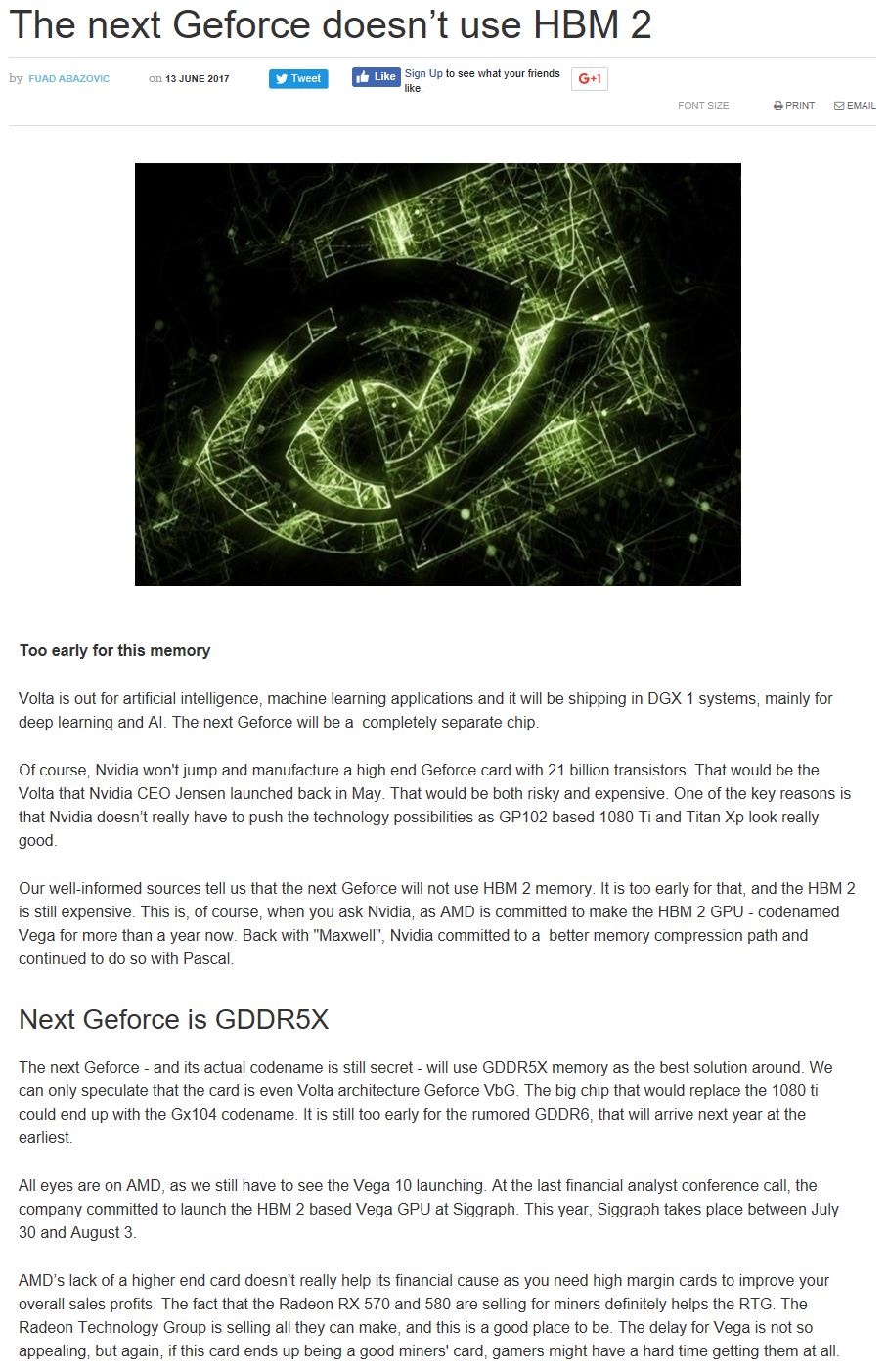

The next Geforce doesn’t use HBM 2

http://www.fudzilla.com/news/graphics/43873-next-geforce-doesn-t-use-hbm-2
I guessed as much. GDDR5 on low and mid range and high end products will be GDDR5x again. Then nvidia will move to GDDR6 when its out in 2k18.
