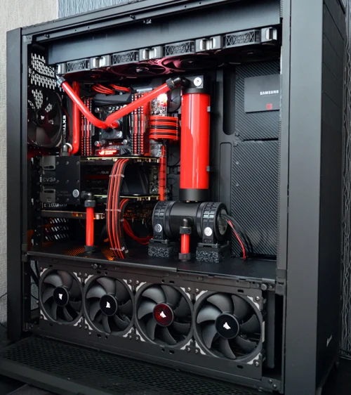

Shouldn't need upgrading for a while hopefully :D. New sig pic and possible user rig if kaap adds it. Cards are running extremely well under water. Now time to finally put them to good use! :)
what case is that?
Thanks :). 2063mhz at the minute with +250 memory. No voltage slider so dont know if that will make any difference or not as of yet.
Just saw a pic of your system, looks amazing by the way, just out of interest though do you not get any problems with liquid expansion? I've unlocked voltage slider with tweak and at +50, am going to reset and see if it makes a difference tonight but first impressions aren't good, still showing problems hitting power and voltage limits.
