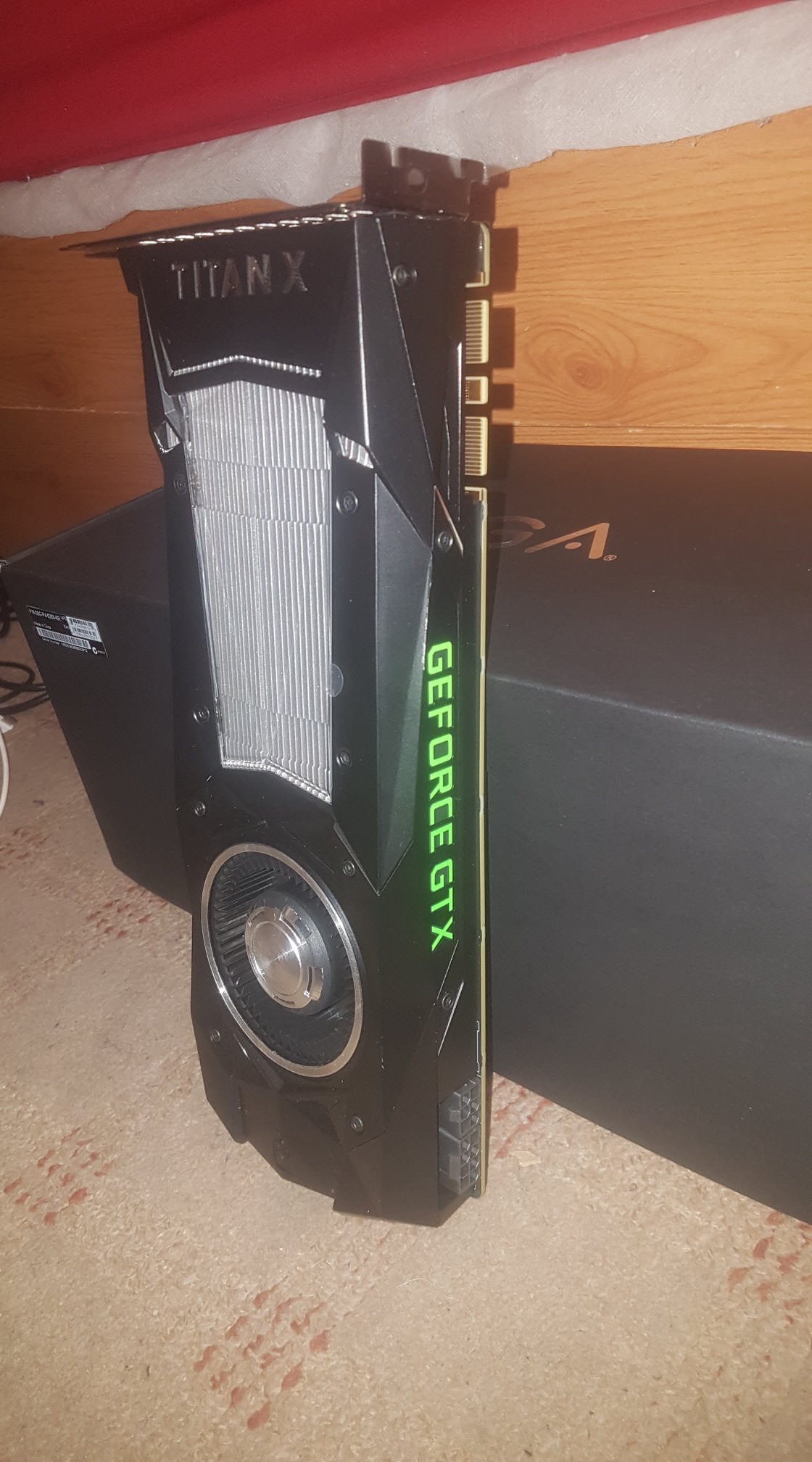

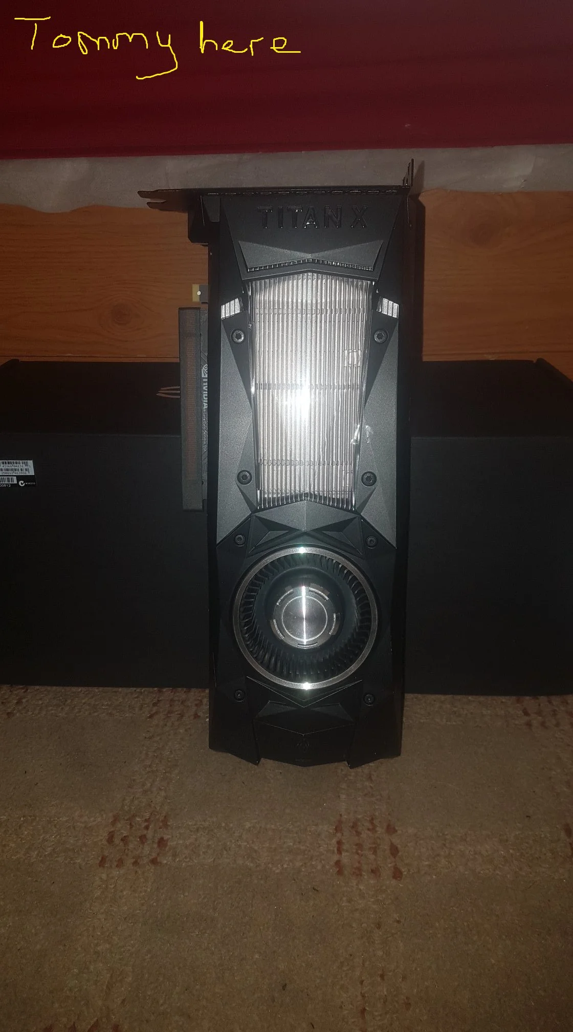

Got this beauty today, such a good looking card imo. Performs rather well also :D
Welcome and on TROH.:)
