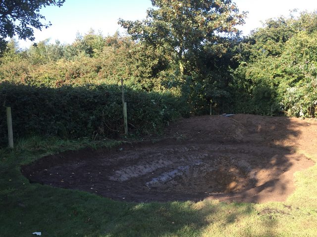

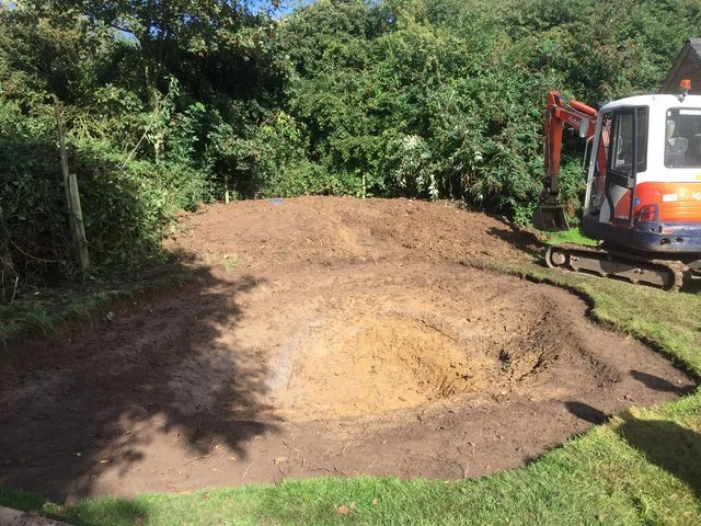

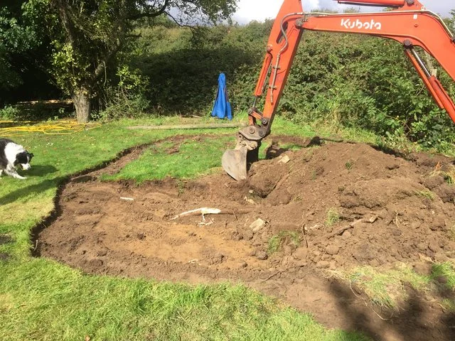

I have posted pics in the main thread but this is really advice on the step by step process facing me next with my pond. TBH Now I have this massive hole in my garden I feel slightly overwhelmed :p
I finished the dig yesterday and will be lining it tomorrow. I'm just a bit unsure on what pump and filter to get. Its 7.8m x 6m measure straight and 9m x 7m when measure with a flexible table down the side and bottom.
Its 1M deep in the middle and from the pictures it has a number of shelves.

It's In the Sun part of the day but there is some shading from nearby trees etc. See in the picture the shadow at around 2pm

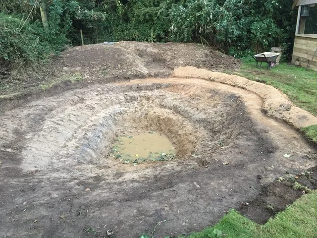

In my last house i had a pond about the same size as in your pics. The center depth though was about 6ft. Fish need a nice safe deep safe hiddy hole in winter. There may well be no fish in it at the moment, but if you intend to have some once the pond is established then give them a nice depth to go to in the winter.
More depth :)
+1
They depth in the middle is around 1.2m I feel this is adequate for 5 roach and a few Rudd. TBH the picture is deceiving, All the people that have seen it say its deeper than they expected.
The pond is huge in my book!
The guy who dug it has dug ponds 500 times as big on farms. Once I decide the shape I pretty much left him to it. I told him I was going naturl and might have a few fish in. As soon as I said Roach he said 1.2m was more than enough. That bottom bit is about 2.5m x 4m bigger than some actual ponds keeping many more fish!
I have a 1.2m depth pond. In full sun in summer it needs plants to remove nitrates and blanketweed if the plants don't hover it up fast enough.
Don't forget there will be an organic layer at the bottom which will eat into the depth.
Before I line it I'll take it down another spade depth :)

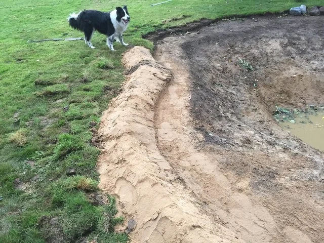

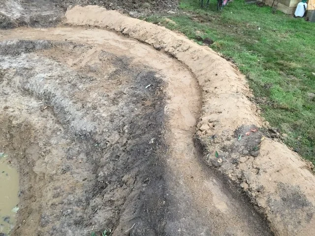

Tonight when I got in from work I decided to create more of an edge. I packed the sides with clay so raise the edges as one side was to just to low for my liking even though the first shelf is level using a laser.

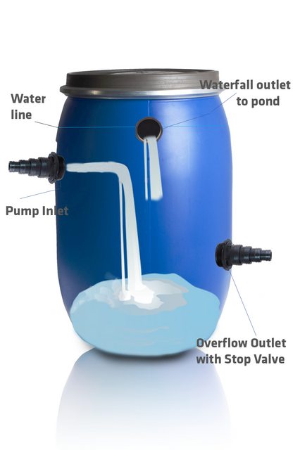

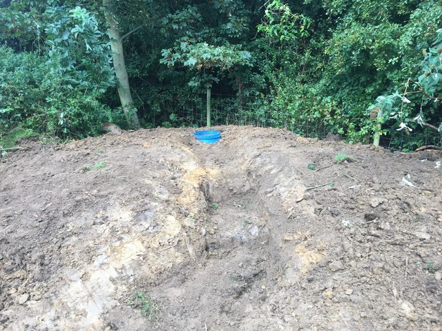

I've decided to fit a stop valve and drain pipe in the blue reservoir so I can control the level of the pond manually. I was going to put a overflow pipe in the side of the liner but figured I don't need to if I use the stop valve method.
Proposed Reservoir flow at top of waterfall mound.
Can anyone see any issues with this? Advice on improvements etc...?
Cheers:)
Cheers:)
How are you going to get the crap that will collect at the bottom out? If left there without oxygen flow through it (the bottom layer) it will be anerobic and take oxygen from the water (plus be stinky rotten eggs).
I think you need to rethink the design.
Do you know what plants you will put in? Also how will you tackle a deluge of rain?
The elevated sides are a good idea as it prevents the soil being eroded and then filling the pond, clogging the pump and filling the barrel with soil.
Just thinking - better to have a automatic level/overflow. Given the surface area, the pond will collect rain fast, if there's large amount of rain then it will likely do that faster than you think. Just create a drainaway (long tube with rocks in) and put a grill in front of it to stop the tube from getting blocked.
