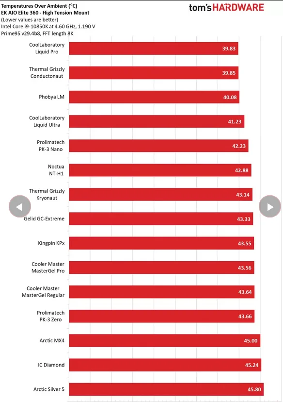

It'll probably be fine, but for a couple of quid I'd personally just buy new. I tried Kryonaut a couple of years ago but didn't find it anything special. They're much of a muchness. For general builds I'd look for ceramic rather than metallic (so as to have non-conductive paste), and I find that Noctua NT-H1 is cheap and works just as well as the rest. In TomsHardware testing it (just) beat out Kryonaut, and the old fashioned favourite Arctic Silver 5 trailed the pack by 10% (delta T over ambient).
