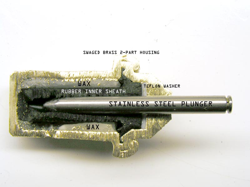

Now we know what car it is I can tell you this is not normal.
VAG coolant temp gauges do not give a direct readout, in fact the gauge will read as 90 over a range of temps. The gauge should read 90 consistently once upto temp, variances around normal operating temp will not be visible on the dashboard, it should be stuck at 90. If its stays below 90 on a decent run or not getting to 90 you most likely have a thermostat that's stuck partially open, the other thing to check is the coolant temp sensor, it's not likely to be this but this is much cheaper and a DIY job so it's worth ruling out.
