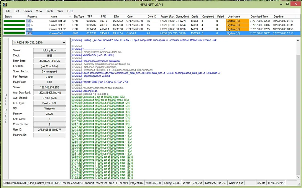

Got myself a power monitor today so I've hooked the rig up to that to see how much power it's drawing. Early indications are that it's pulling about 540W at full tilt. This is a lot less than I thought with an OC'd 3770K and 3 x OC'd GTX670s and shows that my 1250W PSU is total overkill :o
Going to leave it on the monitor for 24 hours to see how it averages out over the course of a day.
I've just got up (banged my toe last night and woke up early and couldn't get back to sleep) and it's now pulling 644W. It seems to have grabbed some better WUs though - estimated PPD = 147,000.
Now that's more like it :cool:
Very Nice :D
Almost as good as my 680's but at a lot less cost.
My 680's on the same wu's are averaging just over 42k across all four.
The rig is running around 192.5k PPD :D
