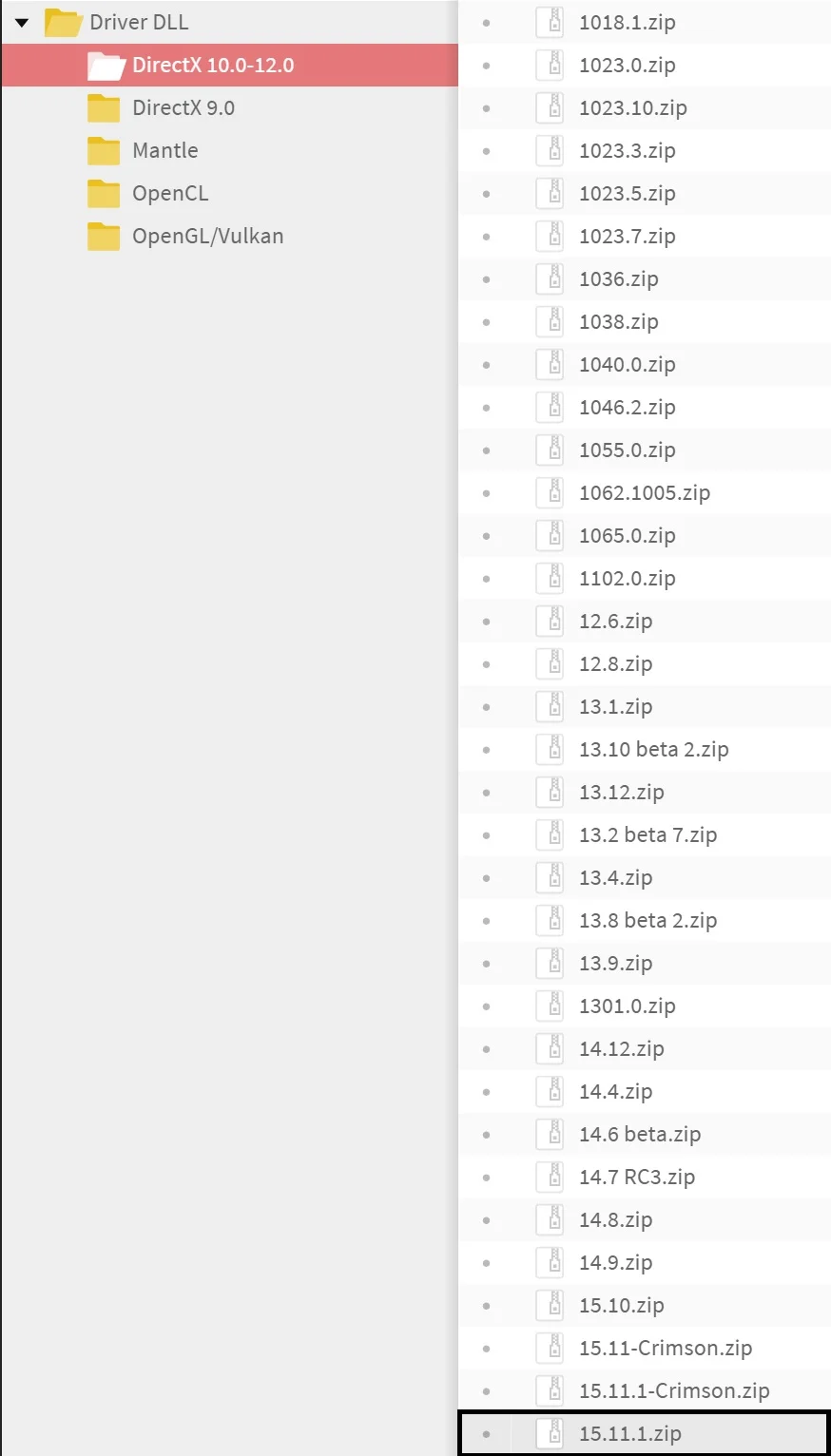

I have a suggestion you can try, but this is with my unofficial hat on.
Try placing the 15.11.1 (not Crimson) DLL files in the GTA V folder. Additionally, you can try the 15.7.1 DLL files.
Link
