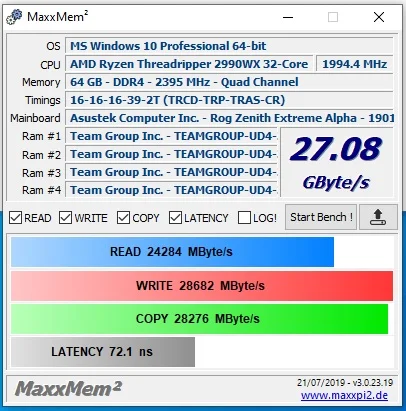

Heres mine, I need to get somebody to look at my system, spent far too long trying to get it right
Its surprising how much better Zen+ is over Zen on memory and latency, even at the slower command rate and frequency yours it giving good numbers. I'll try and have a look through your boards manual and see if I can tell you exactly what to change to see if we can get kicking at higher ram speeds. I find with my chip its incredibly easy to get the ram at almost any speed and boot. What was not so easy was getting it perfectly stable.
Edit: Cant find any good pics of all the bios settings in the extreme tweaker menu of the bios. can you get some pics? Specifically some with dram timing control and other menus expanded.
