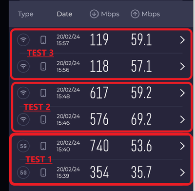

I have something really interesting to share with regards to this. As I am with Three for Broadband and mobile, I thought I would do some tests today and swap the sim cards over, and the results are not what I was expecting!
Test 1 -
Broadband Sim Card in Phone - I removed the sim card from the router, and put it into my phone, ran a speed test and guess what, I’m hitting normal speeds with my 5G Broadband Sim in my phone, I ran 2 speed tests, the first at my desk, still hitting 354mbps, and the 2nd I stood at the window where my router is and hit 740mbps download! So, the problem doesn’t appear to be with the sim card itself and there is no limit when using in my phone.
Test 2 -
Phone Sim Card in Router – I removed the Three sim card from my phone and put it into the router to see if the issue is with the router. Speed Tests 576mbps & 617mbps. So, the problem does not appear to be the router directly.
Test 3 -
Broadband Sim back into Router – Now, I was really hoping that things might have just sorted themselves out and gone back to normal after my swapping sim exercise, but I was wrong. Speed test with the Broadband Sim back into the router = 118mbps & 119mbps, back to being limited again.
There is clearly something that has been set at Three's end to limit the download speed of the broadband account when the sim card is in the router, but it only limits it when it is in the router!

Throttling Tests & Resolution with APN Change
Hi All – I spoke again to technical team on 21/02/24, who were useless like usual, who passed me through to the complaints team again as they said they could not work out why my connection was maxing out at 120mbps and why it had changed and were still adamant they don’t limit or throttle connections! I’m being more convinced now that the technicians truly believe the connections aren’t being throttled, but there is something going on higher up above them doing this, that they have no control over!
Anyway, after I had finished with the complaints team, I did a little more digging around and went into to the router settings to check the APN Access Point Name) which there are many posts about and has been mentioned on here. The APN was set to automatic and was ‘3internet’. On reading up it seems ‘3internet’ is the standard one used for broadband. I changed to manual rather than automatic APN and used ‘three.co.uk’ instead, and then did a speed test and 584mbps!! After all this, for me all that was needed changing was the APN, and I should have checked this earlier as other posts suggested.
I tried the following APN’s and all of them worked without a download limit apart from the ‘3internet’ one which is clearly being throttled-
3internet – 120mbps
three.co.uk – 543mbps
3broadband.ie – 567mbps
3ireland.ie – 532mbps
open.internet – 578mbps
