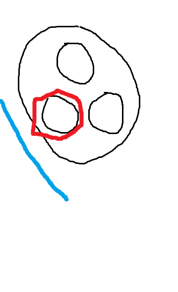

To try and explain further (and not intending for my drawing to look like an angry face!)
The black circles are the pipes which come out of the tap. The red "hex" nut is what I think seems to tighten the whole thing together.
The blue line is the wall at the back of the unit.
As you can see between the wall and the hot/cold pipes there isn't really any room to more a spanner or anything to tighten it. I can "just" about get them to fit. Wondering if perhaps some needle nose pliers might work but don't know if there's even enough room to get them in.

Yeah those are like mine but there is water feed pipe with the tightening nut at the top of that so no access for the box spanner.

Can you disconnect the hot and cold tails, should only be hand tight, should then give you room to get monobloc spanner in.
