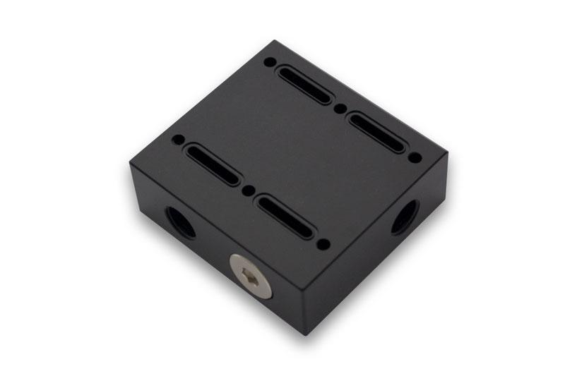

with the titan blocks you can just use normal SLI fittings, I've got the phobya ones as they are adjustable so you can use them with any block and they are really easy to fit as the bridge piece just slots in
I guess I'll need a blanking plate? There going in slots -
1 and 3 on the rampage IV
have you got a pic?
if there's 3 physical pci slots between the 2 you are using, then you can't use the EK bridge... they do a 3 slot bridge but it's for 3 way SLI, there isn't a blank for it I don't think (can't find one on their site anywhere)
Look very similar to the aquacomputer bridge I have just purchased, its a 5 slot 3 card bridge but does come with a blanking plate if like me you're only using slots 1 & 5. I'd be surprised if EK didn't provide blanks for it, they did on their old bridges.
I've sorted it with ek now :) they will be making csq bridges
For Titans at some point. Just waiting on my case pictures will be up soon.
