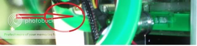

4th and 5th pictures show what looks like a crimp in your hose from the top rad to the bay. Is this just a fault of the photo, or could this be part of the reason for poor flow?
Good eyes take it you mean this one, its a slight kink going to the inlet.
however even a slight kink such as this should not cause the low flow within the loop.
If this was on the cpu maybe or mosfet / sb/nb then maybe.
Ha ha sharp eyes indeed!
Actually this is only because I have just sold on my 4870X2 (and block) so had to reattach my loop to not include the GFX. This is only a temporary solution as now I have the 285GTX I will be getting a wb for this (along with some other bits hopefully) and sorting it all out.
Well spotted though!!
