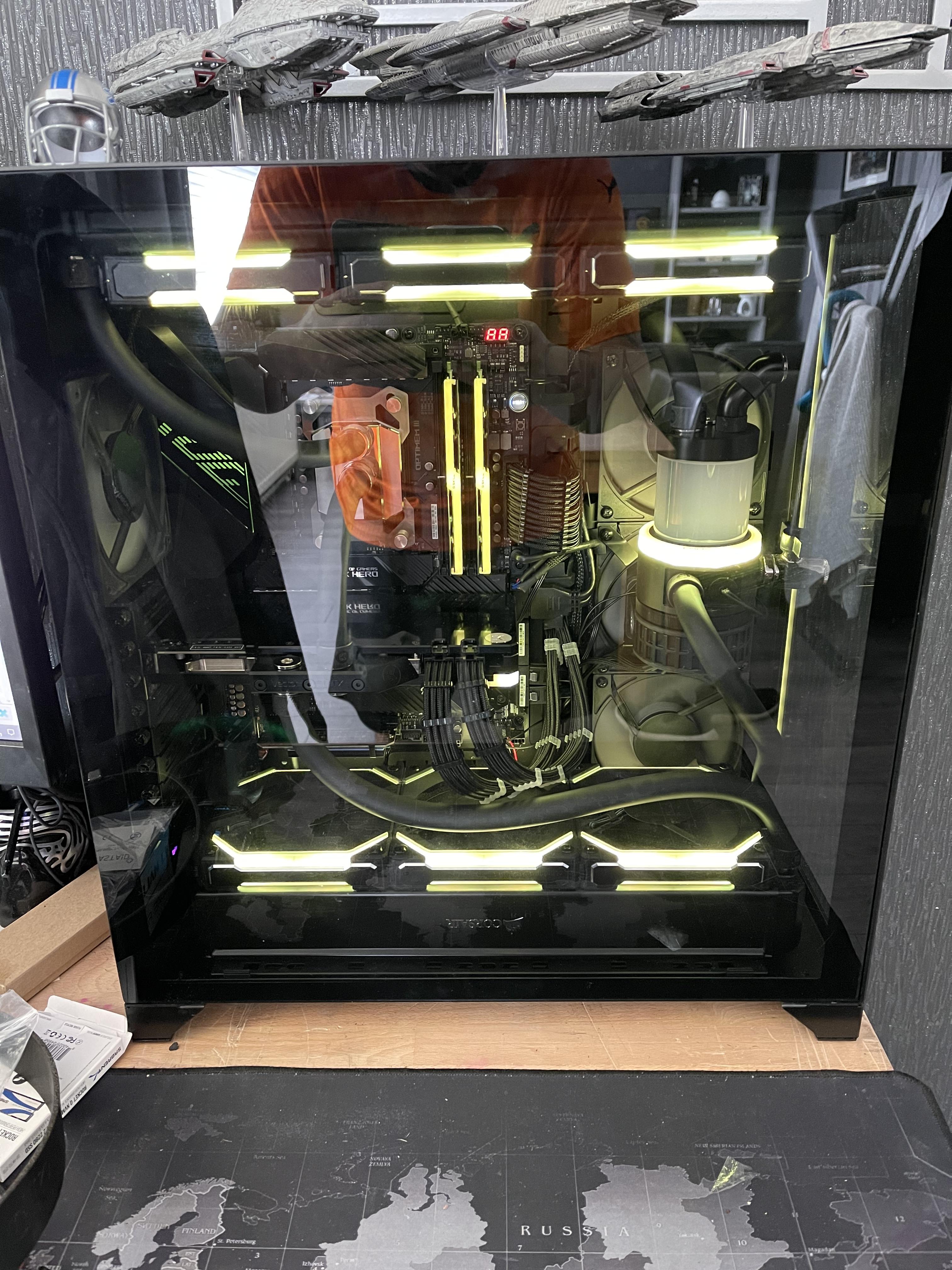

Depends on What do you want to achieve?
I use 2 pumps
But both on same loop
So if 1 fails I don't need to shut down immediately
I also have quick disconnects
So can remove the GPU or CPU or pump etc
Without needing to drain the loop

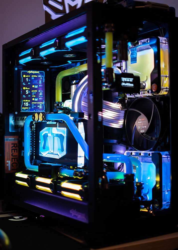

Did it in both the O11D and my new case Evolv Shift X using FLT120's with D5's. Just plan your loops prior to starting, make sure it all fits. Make sure you have plenty of fittings, offsets, extenders and angles.
My latest Uses an external radiator as well so i use 3x D5's in total. 1 on 1 loop and 2 on the other for abit more flow.

Reasons for it
Better cooling? Unlikely to vastly improve
Compared to CPU and GPU in one loop
Assuming adequate radiator area is used of course
You may see some difference
But one loop should still have temperatures that
Are easily in the acceptable range
Aesthetics?
Well everyone has their own idea
Of what looks good
Easier replacement of components?
Well for soft tubing anyway
My quick disconnects make easier component removal
Than 2 separate loops do
Though quick disconnects are quite bulky
So not aesthetically to everyone's taste
But they're very useful
Though for hard tubing am not aware of any quick disconnects
Personally I still think if you have 2 pumps having them
In the same loop for redundancy
Is the better option
Pumps are pretty reliable yes
But they can fail and lead to immediate down time
Especially an issue if in a country where
Local shops don't sell watercooling equipment
@Jay85 What LCD did you use for the sensor panel ? I have O11 Dynamic and only 11.5 cm on the horizontal to fit an LCD in so finding it hard to find the correct one.
@OP Anything is possible and dual loops loop super cool but when I check hwmonitor after a gaming session I see the cpu maxing out at 100w and the gpu at 200w, with an NV gpu that could be over 300w. If you go for a dual loop then 1 will have to potentially dissipate 3 times as much heat as the other 1, not an ideal situation.
It's a 5" LCD Waveshare panel from what i remember.
Ty Jay , not only is that the cheapest I have seen but it has the ports on the bottom like I have been looking for and not the side like most of the other 5" lcds seem to have. Did you make your own acrylic border or did it come with one ?
Edit - Never mind I found an acrylic case for it so looks perfect.
