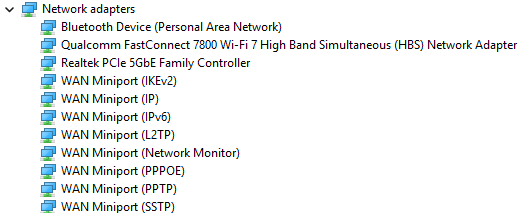

The driver I have installed on mine is from 12/08/24 version 3.1.0.1323 and it works perfectly fine I just let windows install it.
You should see all these if all drivers are installed properly
I'm sure the AMD chipset drivers install the latest version for this as well
