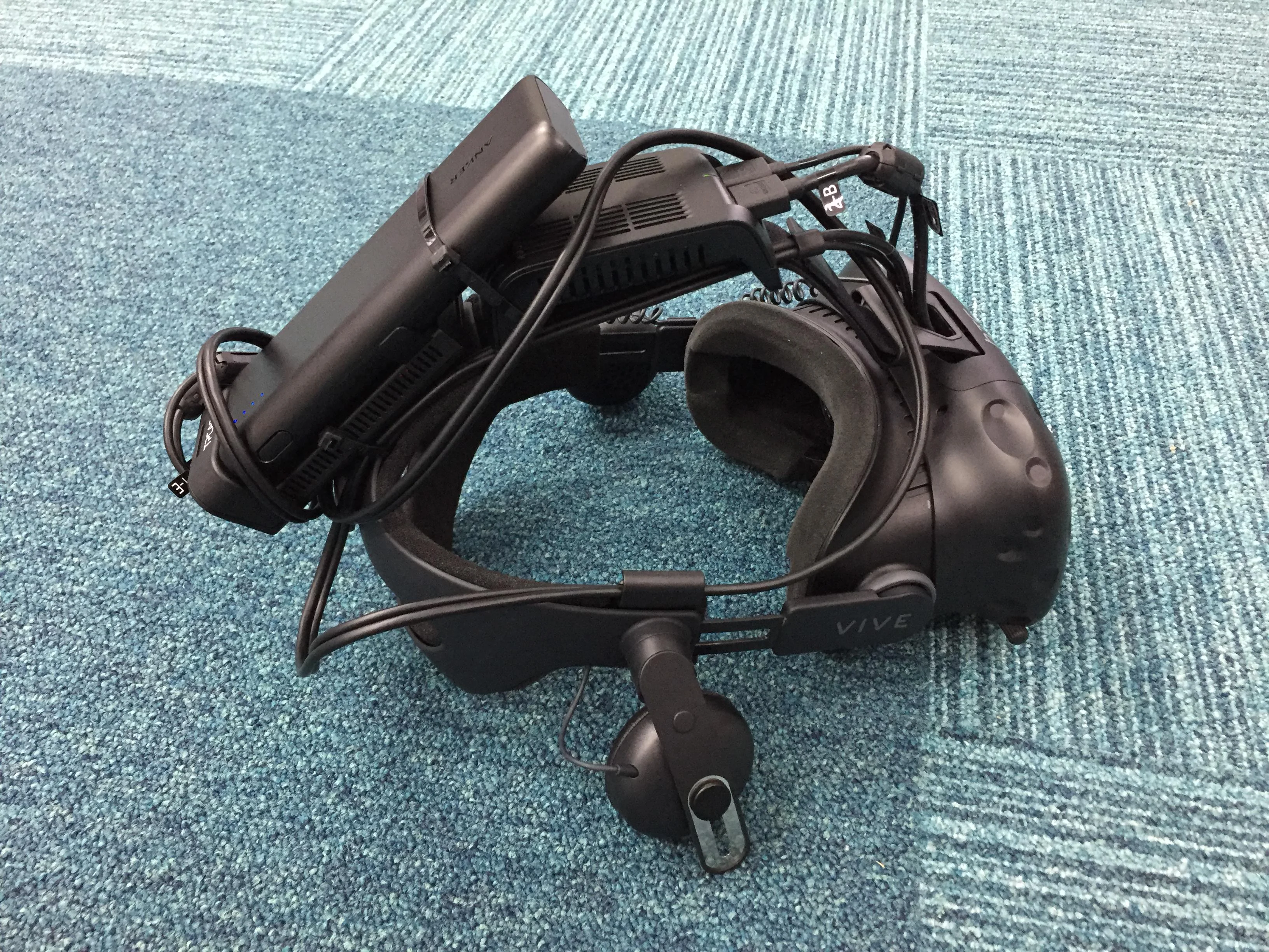

So the TPCast works a treat.
Installed OpenTPCast and we've even got the microphone working, bonus!
For a little bit of fun (office Christmas party coming up) to make things a little easier I've strapped the battery pack to the headset.
It's a little heavy (currently trying to see if I can find a lighter battery that fits) but given that people will only be trying it out for shorter stints it makes passing it around much easier.
