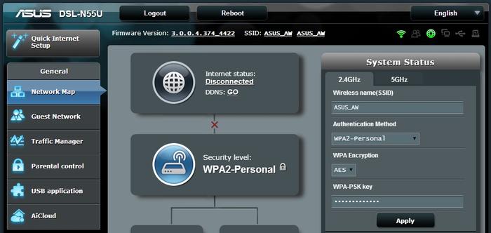

I've recently purchased a Asus DSL N55U but I've having trouble connecting to Sky (my broadband provider).
Looking at the settings page of my Sky broadband router I can see it connects using PPPoA (rather than MER).
When I enter my ADSL login details it appears that the N55U has connected in the router ADSL log, see below:
However on the main page it says it's disconnected and if I try and access the internet it doesn't work:
If it helps here is the router log:
This seems to occur whether I input the Sky Sagem router MAC address into the Asus router WAN settings or not (which I know sometimes needs to be done to connect to Sky). I've also updated the router to the latest firmware off the Asus website.
Any ideas what's going on? Help much appreciated!
