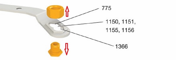

I need to remove my cpu cooler on one of my older machines.
It's a Be Quiet Dark Rock 3 Pro. And it's on an LGA 1151 board. It's supposed to be simple to remove, just unscrew it from the back plate. However, when I do that I see that the screw and the but it inserts into are revolving together. But the cooler is on an old ROG Maximus VIII Gene and so I can't get to two out of four of the revolving nut to grip them as that area is blocked by heatsinks for the board components.
I did not fit the cpu cooler and looking at old youtubes on how to install it,it looks like it wasn't fitted properly or it should just unscrew nicely. I'm not sure I even have the other parts the cpu cooler came with. I'm not sure how to proceed. I guess I'd have to disassemble the board from the case, and then remove the board heatsinks and hope I can get to the remaining nuts that way. I'm also tempted to just leave it. I wanted to put a small upgrade cpu in this one, (i7-7700k replacing i5-6600k) and put the i5 in another case. But I'm starting to think I may end up with a busted pc.
All the screws on the backplate rotate easily with not much grip or tension on them, I can't tighten them or loosen all four they just rotate. I can get to two out of four but that wouldn't get me access to the last 2 I don't think there would be enough room to get to them made by releasing one side of the cpu.

Try and hold the nut rigid while you unscrew?
There is no getting fingers to them, so this is the plan with the long nose pliers. Just not sure how on earth I'll get it back together again or if I can reach with the pliers while the board is mounted in the case. :)
My guess is the locking nut and sleeve has come apart slightly so the whole thing is turning.
Remove the motherboard from the case and use the pliers on the locking nuts.
This should free the cooler so you can use the pliers to free the screws.
With any luck you should be able to reuse the cooler.
Looking at the design, it's frankly just a poor design. They do supply a spanner to do the nut up, but, clearly, there is a danger it's won't undo again. All the fitter has to do is to do the nut/sleeve up with less torque than the screws and there will be trouble when someone tries to remove it.
I would find or get another spanner and cut it down until you can fit it in to whatever access you have.
