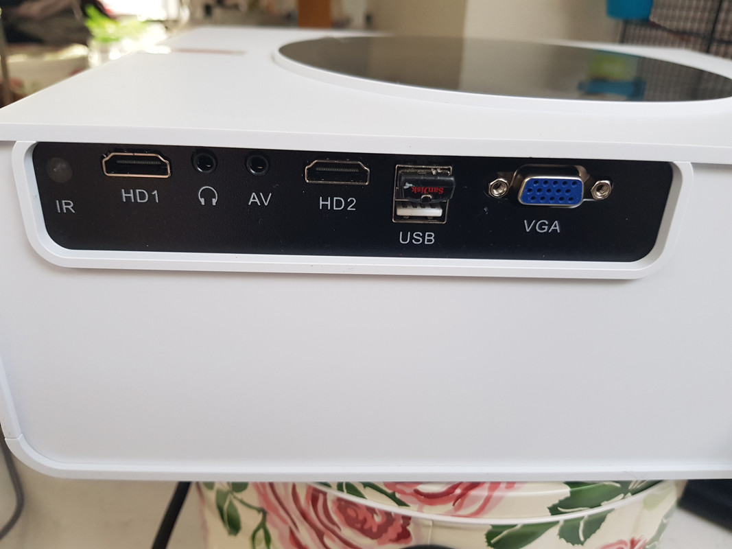

Plugging headphones in to a projector seems like an odd facility to provide. Do you know for certain that the socket you're connecting to on the projector is really an Audio Out (a 'gets the signal out of a device' socket) rather than an Audio In? Is it labelled as "Audio Out", or are you just assuming that's what it is because it looks like the headphone jack on an MP3 player or phone? Just because it looks the same it doesn't automatically mean that it has the same function.
3.5mm jack is commonly paired with a VGA connection to provide a way of getting sound in to a display device. When TVs routinely had VGA sockets you'd often find a 3.5mm for Audio In along side. These connections would pair up with the VGA Out and 3.5mm headphone jack socket on a laptop, so the 'Outs' on a laptop would connect to the 'Ins' on a TV.
The rest of the sockets you've listed on the projector all sound like they're inputs too. Doublecheck the manual or post a link to the manual or decent resolution shots of the socket panel on the projector so we can read the labelling. In the absence of that info, any socket labelled with "In" is a socket that expects a signal to in to the projector.

Ps hopefully the images will come through
Thanks for the images. That's very helpful.
I take it you've tried plugging headphones in to the socket when the projector is playing the files to check that there's some sound?

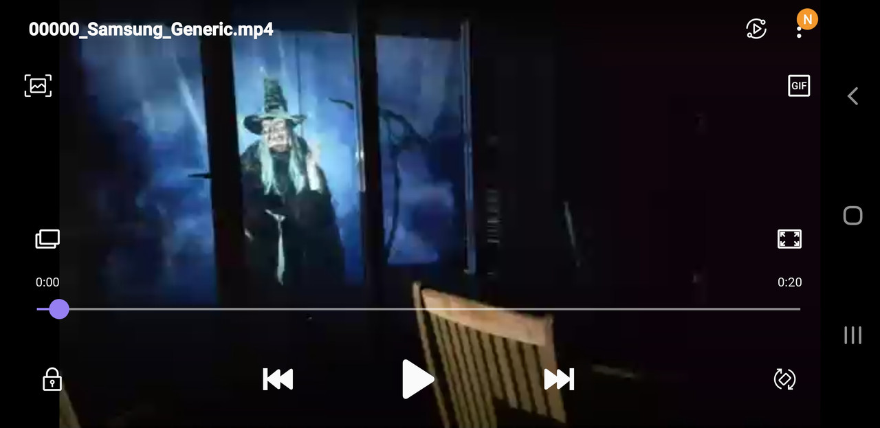

I'll get it going again tonight and take a picture of what it looks like or maybe I can try and take a snapshot of some video I took last night.
