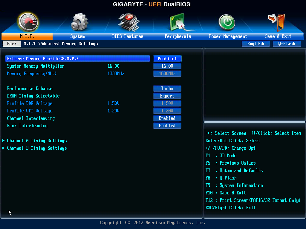

Can you give some screenshots from the bios settings you are using (usually UEFI bioses have screen capture thing, plug a usb stick to save them to)? Generally it is never a good idea to leave the voltages on auto as they tend to do stuff you do not want. Give some screenshots and we'll try and give you some possible settings to try out.
I think these should show the main screens of concern, note that these show my base settings, the only thing I changed was the cpu clock multiplier. A lot of the voltages are at auto but my understanding is that if anything this will lead to more volts / heat being supplied than necessary. Once I established an overclock at 4 or 4.2 I was intending on adding negative offset and working from there as opposed to a flat rate voltage supply.
I would also look at your memory settings as this can have an affect on overclocking.
I have manually set my bios to reflect the specs for the corsair ram at 9-9-9-24 @ 1.5v. This isn't above the memory spec so I didn't think this would effect an overclock through the multiplier. Am happy to be corrected though.
Just before you change anything, load optimal defaults, save and restart. Also use the XMP profile of your memory as it usually has some secondary timing settings as well. Some memories change VCSSA voltage as well but yours is with low enough speed to need this. Do not fiddle with it if you plan to leave it on stock,it can lead to very funny and unpleasantly hard to find instabilities of the system.
