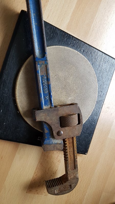

The bulb died in my Bosch oven but the thick glass that covers it broke while trying to get it off. It uncrews anticlockwise except it won't unscrew, it's completely stuck. I used a wrench to try and remove it and that's when the glass broke. I can't unscrew the glass that remains and I can't get a grip on it with the wrench plus it's awkward with the grill element surrounding it.
If I smash it I might be left with bits of glass stuck in the screw threads that might not fall out and won't be grippable to unscrew. Any idea how to remove it?
